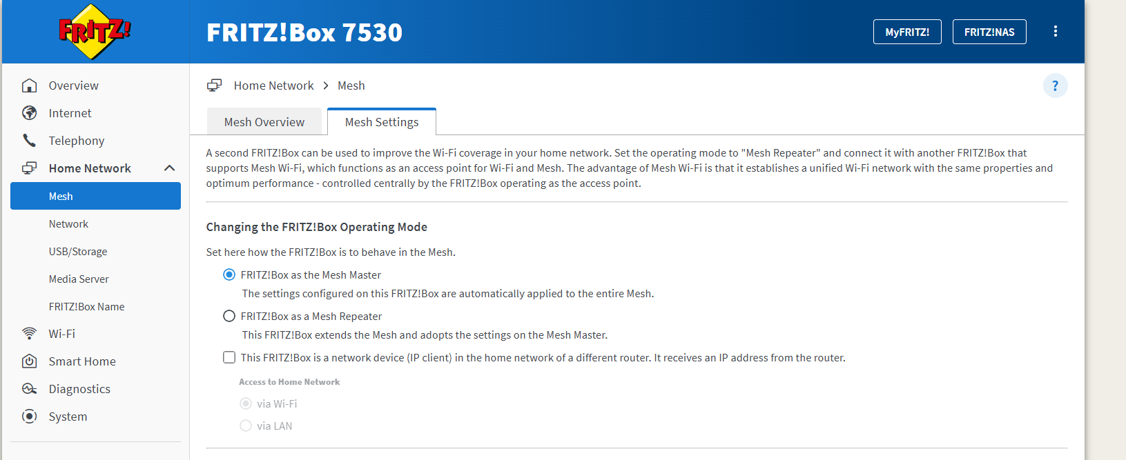

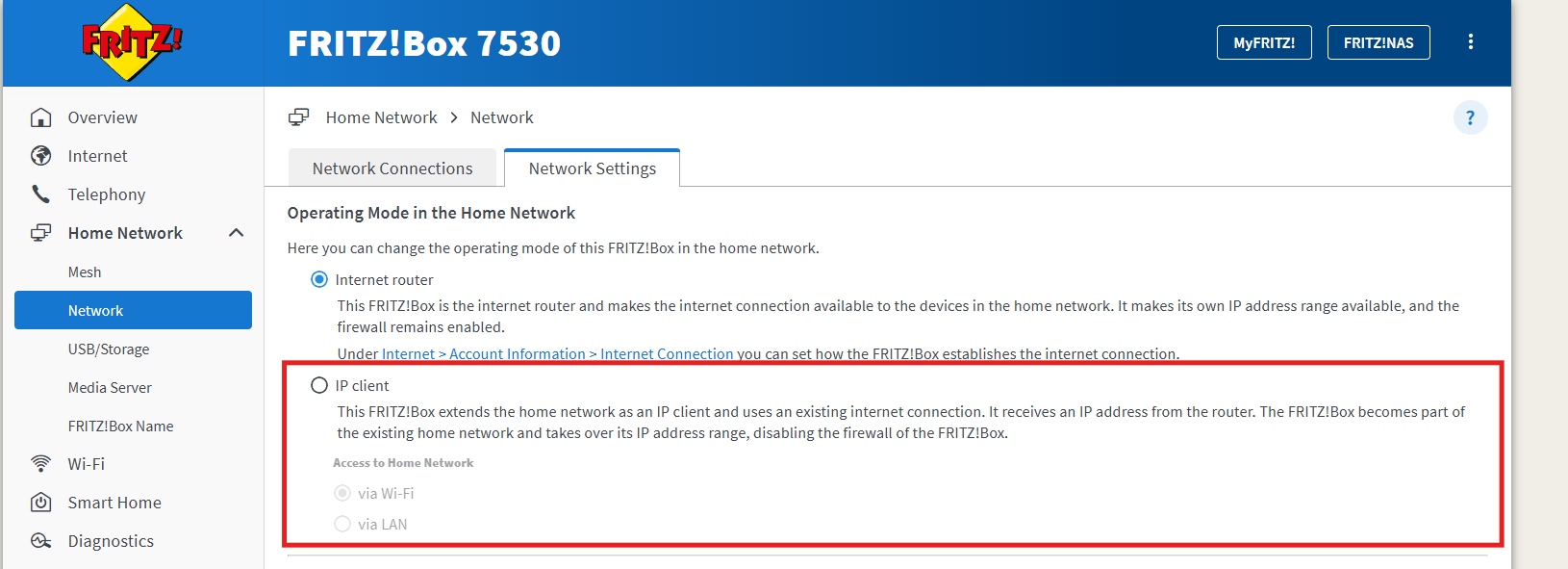

I assume that you have set the second Fritz!Box to be an IP client using the via LAN setting?
Yes, I did. I admit that I was just guessing whether that was the right setting. You don’t really have any other choice, because the help files and other documents usually assume that you already know the answer you are asking for, so a useful explanation is not necessary. But reading the menu entries led me to believe that this was the right setting.

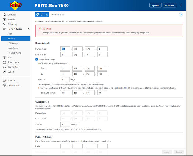

I’ve not used this feature of a Fritz!Box, but because the Support Team raised the possibility of your having subnets, I would check to make sure that you just have one DHCP server running in the network, i.e. the DHCP in your router Fritz!Box.
Is there some reason why you are using a second Fritz!Box rather than a simple unmanaged switch in its place?
There is a DHCP server in the router. Of course.
I use this FRITZ!Box because I have it here. And I need a second Wi-Fi source, otherwise I won’t have any internet in the living room or on the balcony.

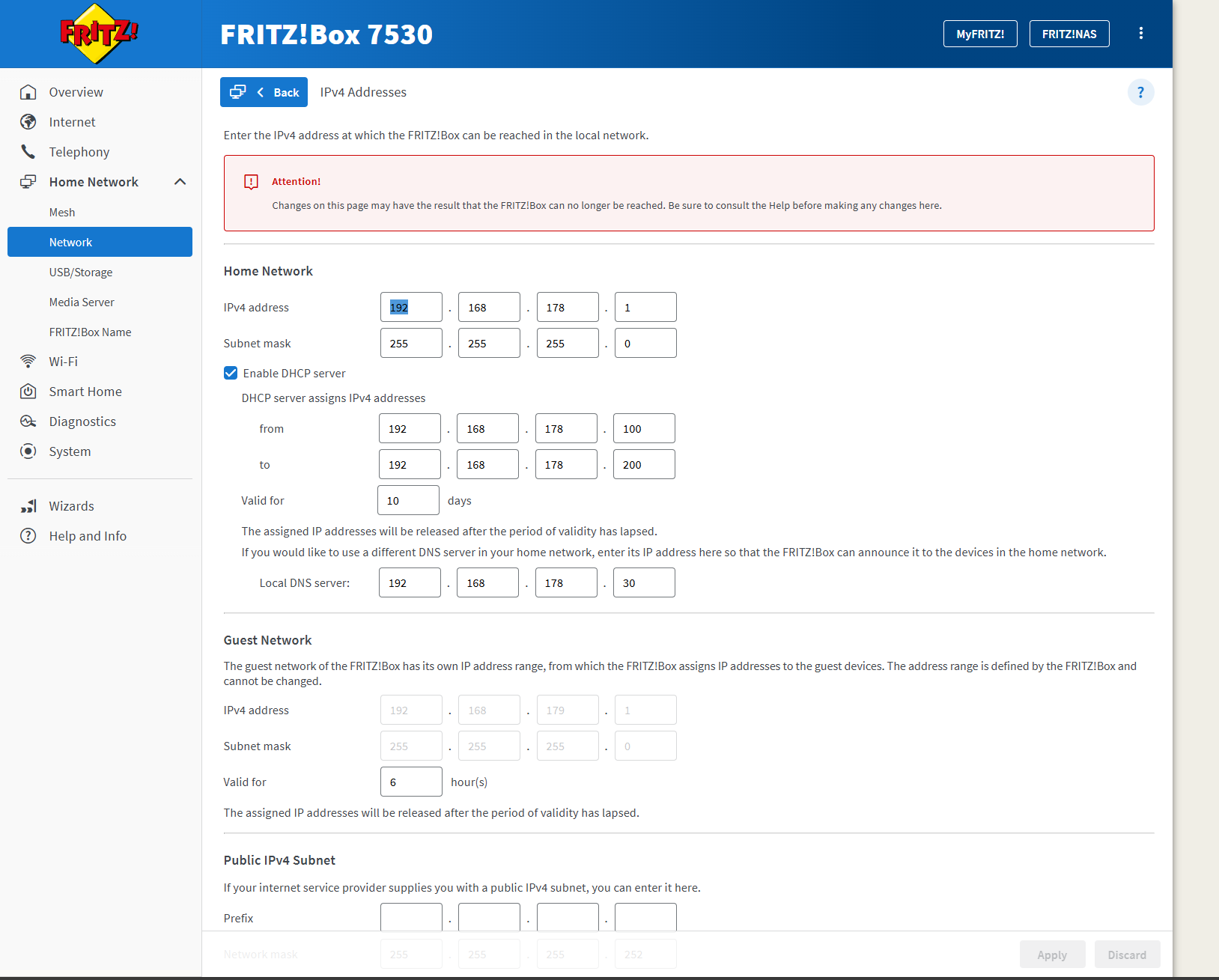

Yes, there is a DHCP server, but it seems to me that it should not be active - there should only be one DHCP server per subnet active in a home network…
Where can I see that? And when? A few hours ago, I disconnected the second FRITZ!Box from the network to see if, and if so, how well it works without it. So if a second DHCP server is active on the network, it must be a ghost. (Incidentally, I’m also pretty sure that the second FRITZ!Box didn’t have DHCP enabled. However, I can’t check that right now because it’s difficult (and currently impossible) for me to access the sockets and Ethernet cables.
In the second Fritz!Box, look at the IPv4 settings…
Just a thought - have you also set up the second Fritz!Box as a Mesh Repeater?
Yes. It is set as Mesh Repeater.
I forgot tthe question about the DHCP server: The answer is no. No DHCP server is enabled in the second FRITZ!Box. (This means that definitely no second DHCP server can be active in the network..)
