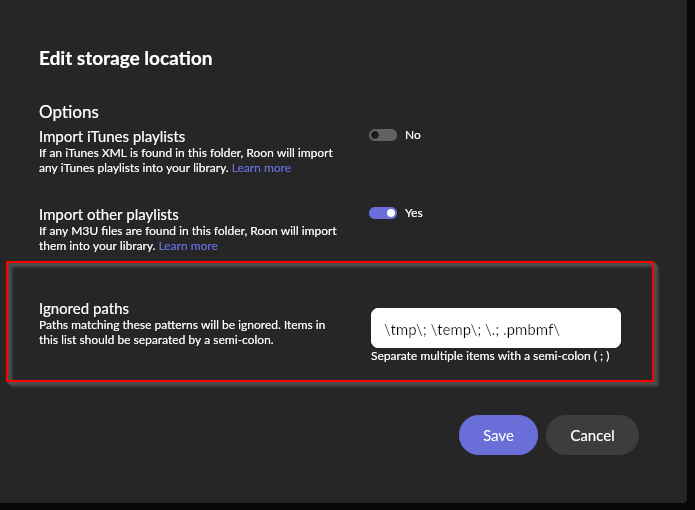

I don’t think we currently have this feature. But we are always happy to get suggestions of new features. You can make a post in Feature Suggestions. The product team does keep an eye on that topic. As a temporary measure you could set background analysis to off which should help with the high RAM usage. Another option would be using the “Ignored Patterns” option in the Edit Storage menu.

Could you explain how would this help? As I understand it, it’s repeated attempts at album identification that’s the problem not audio analysis. Once AA is performed on a track that’s it … it’s not repeated (unless Roon updates AA the algorithm (which IIRC has only happened once).
