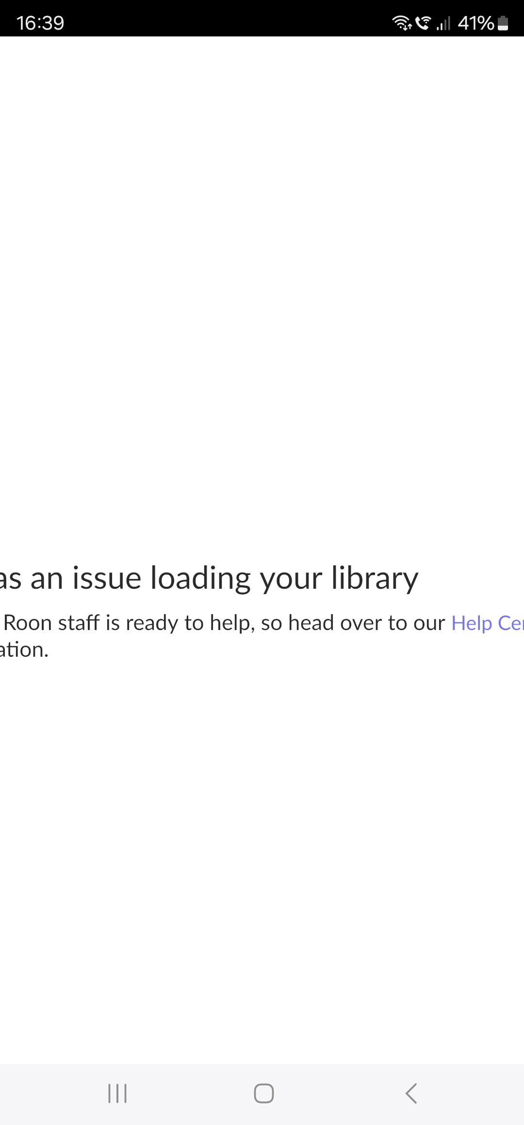

Music stored on Internal Drive will not play on my Customers Nucleus
Connected direct to a router in users Comms cupboard

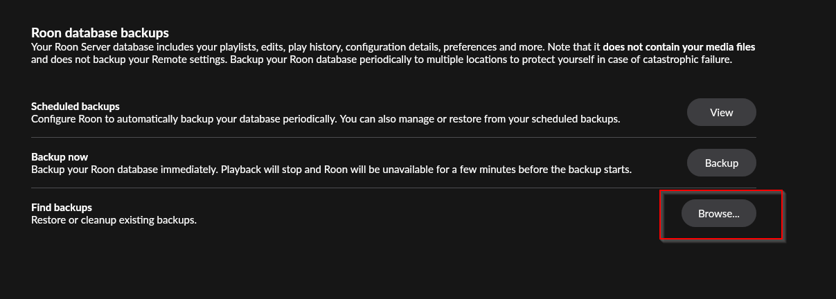

You can restore a backup from the Roon settings → Backups screen.

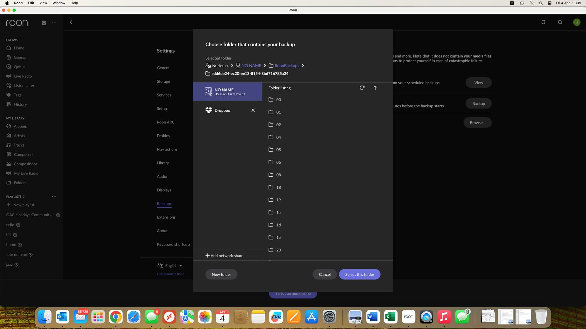

This is the message I get when I try to restore database from backup on USB stick plugged into back of Nucleus +
AND
about to try and send Logs file in name of …
[moderator edit: personal information removed.]

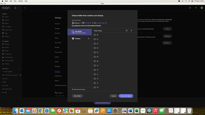

Hi @Jon_Harker2,
From the screenshots you shared it looks like you’re going too deep into the file structure. The long hexadecimal folder name is the one you want to select not the folders labelled 00, 01 etc.
If you just click Select this folder on this screen do you see your backups?

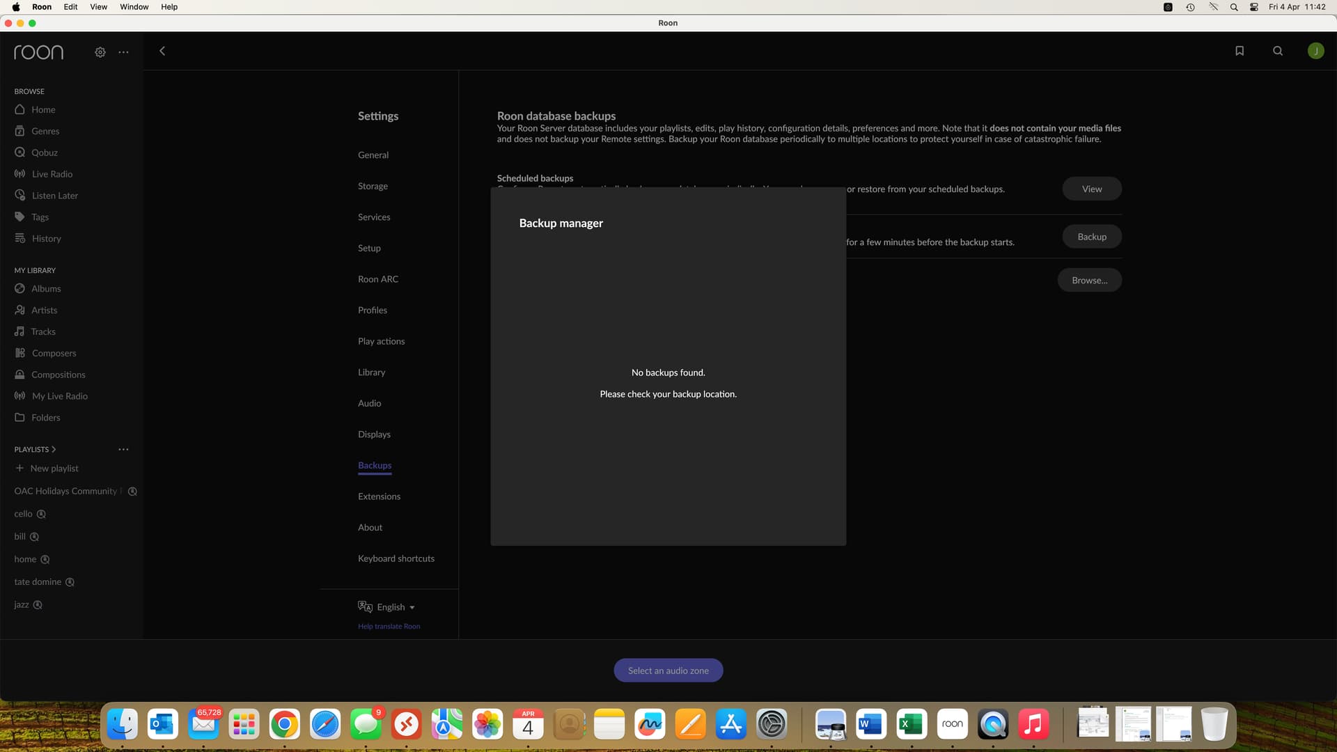

No I get the same thing as the screenshot.
Many thanks
JON
I mean
“No backups found
please check your backup location”
Hi @Jon_Harker2,
Just to confirm, you still see no available backups when you select ‘No Name’ versus the ‘Roon Backups’ folder?
Based on the screenshot you’ve provided, it does look like there should at least be one available backup.
If you still don’t have any luck via the USB drive, perhaps coping the ‘Roon backups’ folder to a different location and testing out restoring from this location may prove successful.

@daniel - are you sure? I think it’s the RoonBackups folder that should be selected to display the available backups…
You’re correct my mistake. Though either will bring up backups. I just tested to make sure.
