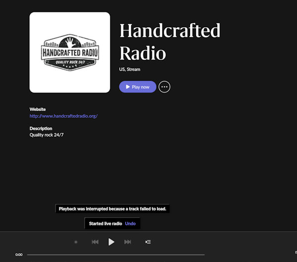

I can't seem to listen to Internet radio. Every station I try has the same result. BluOS on my Node endpoint has no issue connecting to any of the same stations.

That was just an example. I’ve tried many stations that are listed in Roon Live Radio, including WFMT. Same result. The very first day I got ROCK running I could connect to any radio station. Now, nothing. The message is always “Playback interrupted because a track failed to load”. The Bluesound Node (my endpoint) can connect to any of these same stations without an issue, so I’ve been using that for radio.

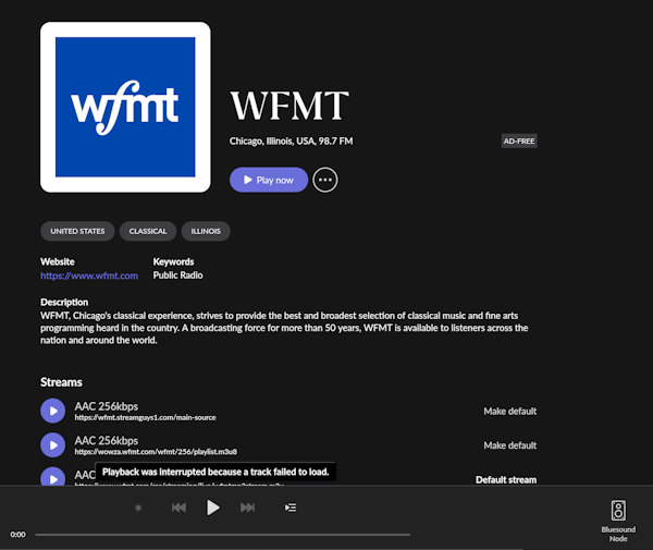

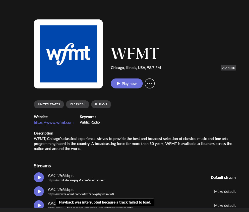

Yes, the live radio feature continues to be a problem. Time and date? Anytime I try an connect to ANY radio station, like just now 1/5/2025 at 10:20AM. Here’s how it looked… after I clicked on WFMT and then clicked on Play Now. It’s the same behavior for all stations and all attempts to connect.

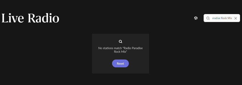

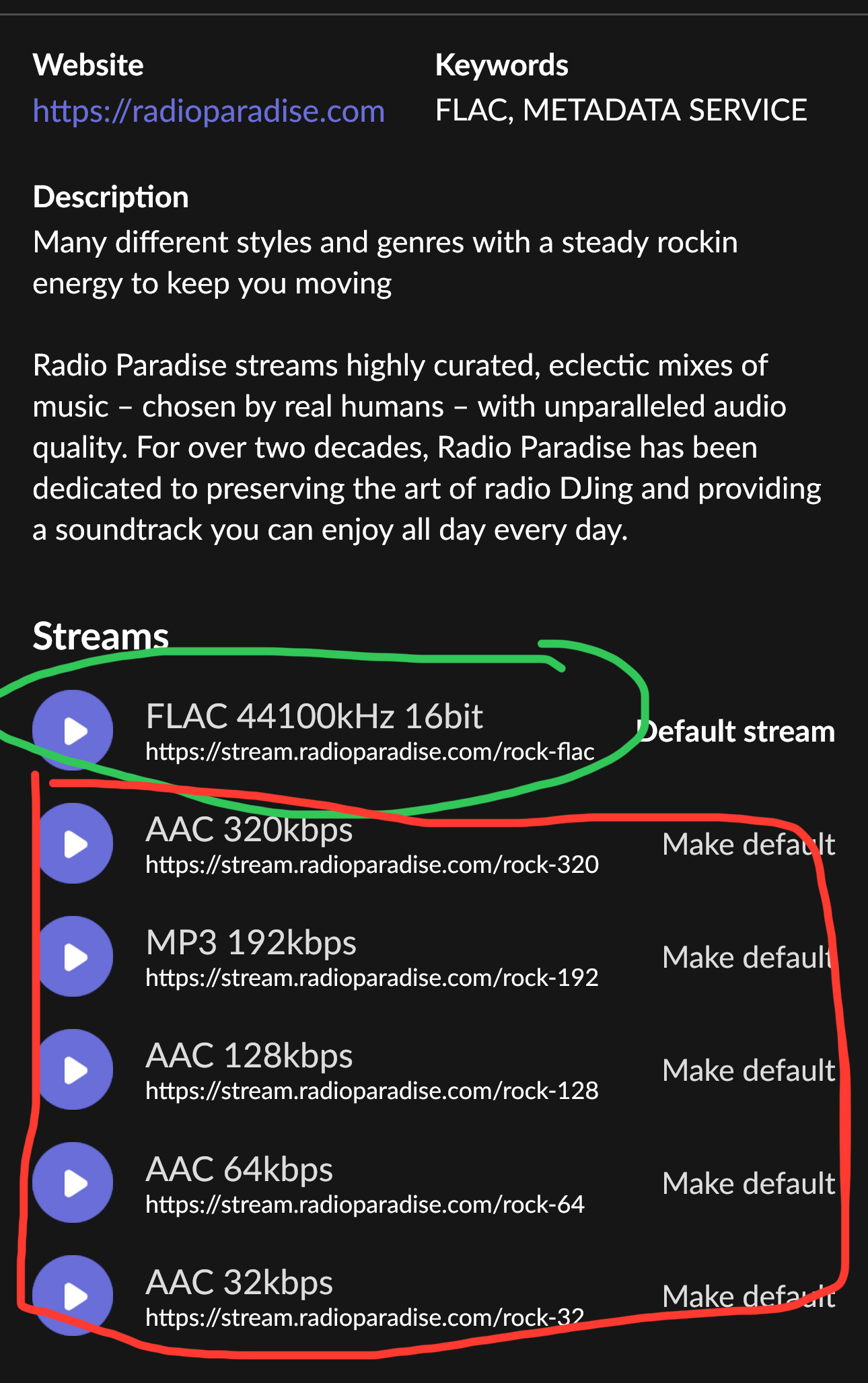

All the streams of WFMT are AAC or MP3. Did you try FLAC streams, too? If not, search for Radio Paradise Rock Mix. It has a FLAC and AAC/MP3 streams. Does the FLAC maybe work and the AAC/MP3 fail?

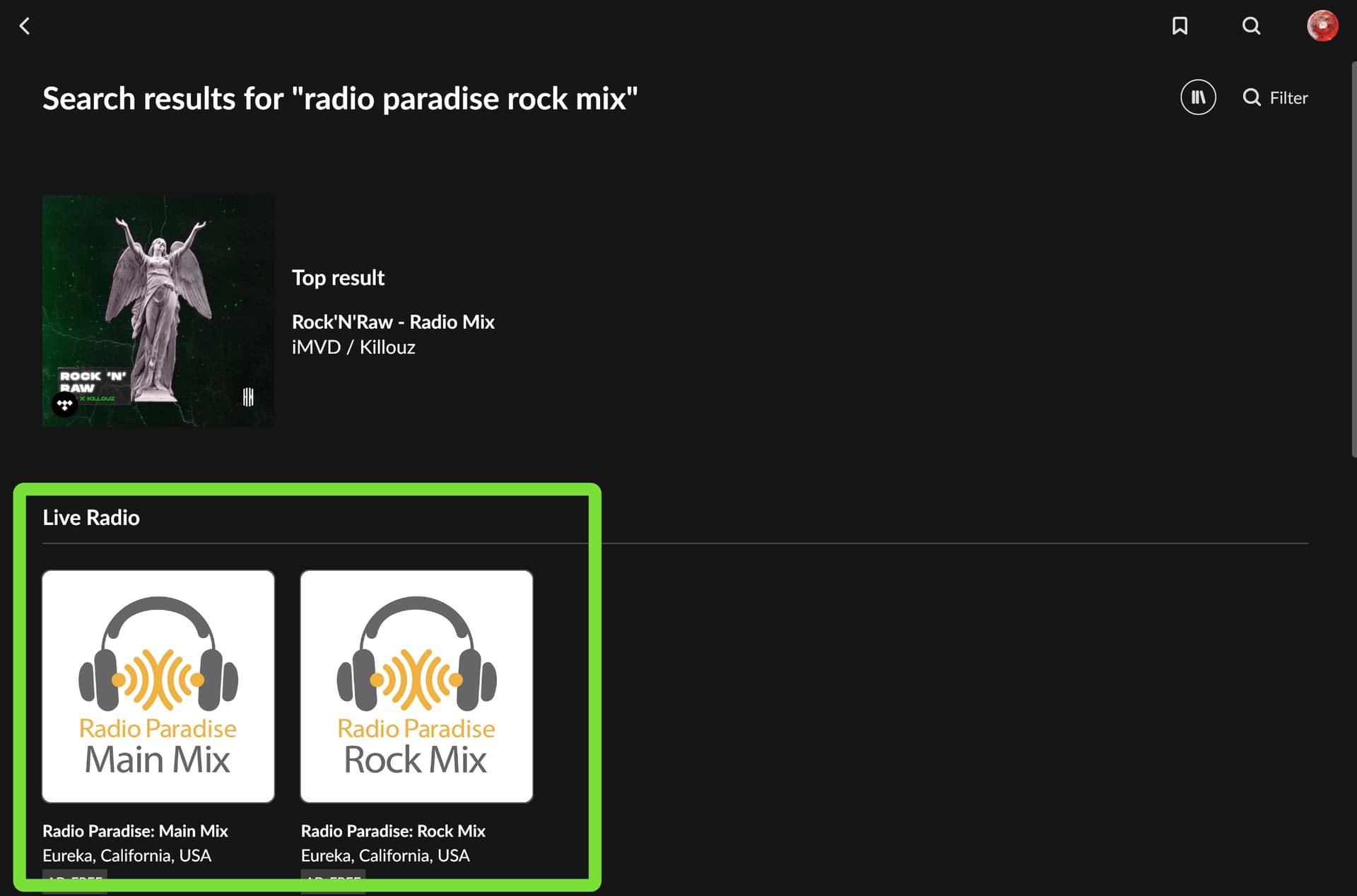

Interesting idea, Suedkiez, but no results found. I can’t find to any of the
Radio Paradise stations via Roon. But, as I said, every stream I’ve tried, regardless of source, returns the same failed results. And the weird part was that on the first day I had ROCK installed it worked perfectly - every station I tried streamed perfectly. But since the second day, nothing. So no radio for over a month now.

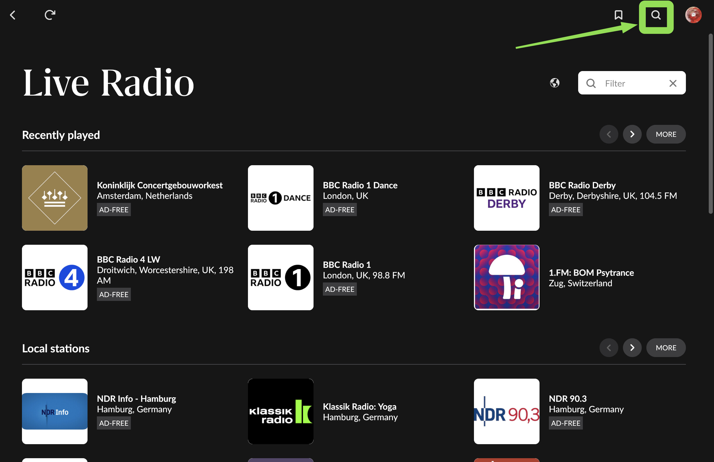

This is the filter - this only filters the stations that are already on the Live Radio page (because they are local, have been recently played, etc).

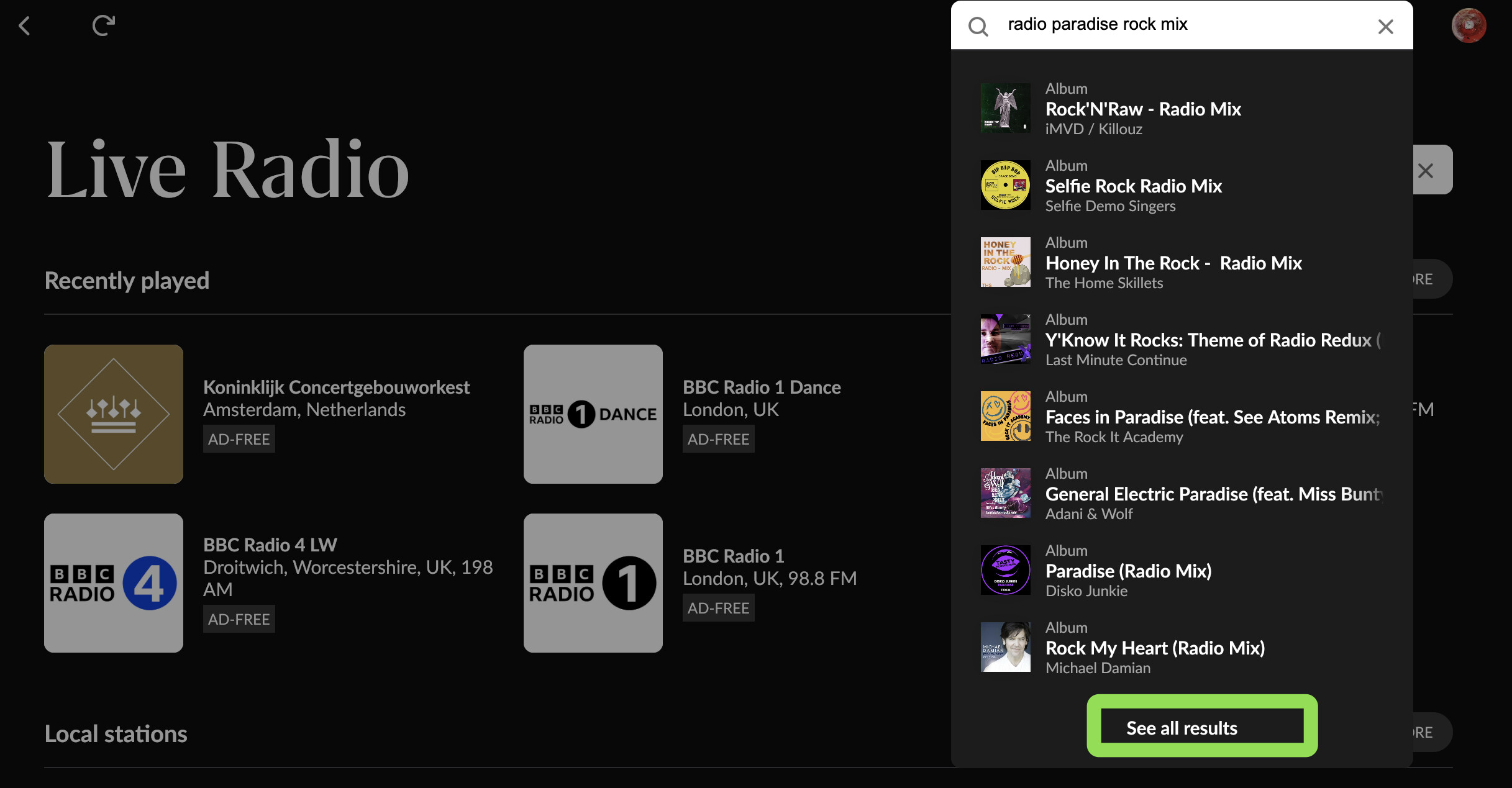

Use the global search instead:
Click See All Results or press Enter:
Great suggestion! It works. So, what does this tell us?
Most likely that you never installed the necessary codecs that are needed by ROCK to decode AAC and MP3. I suppose that when Live Radio worked for you in the past, you just happened to try a FLAC stream.

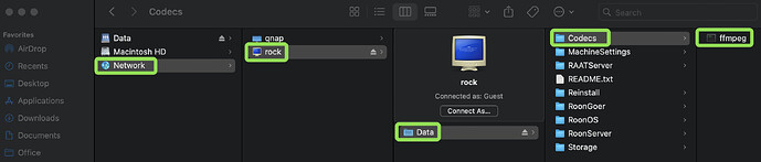

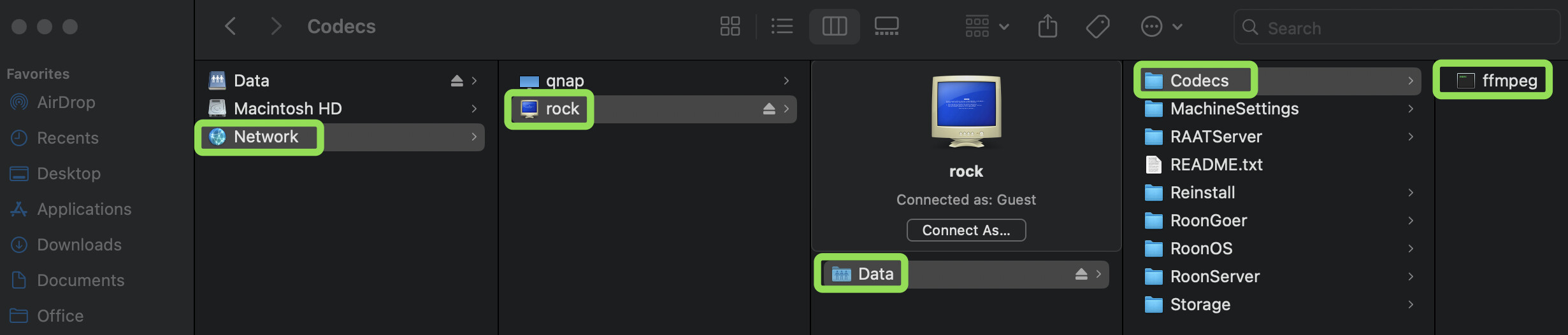

  1. Ensure that you can access the ROCK file system in the Windows File Explorer. If you have music file storage on the ROCK (internal or external by USB), then you know how this works. If not, do this:
  • Open the File Explorer.
  • In the side bar, go to Network. If you are lucky, the ROCK shows up there. If so, doubleclick it.
  • If it doesn’t show up in Network, enter \\rock\data in the address bar of the File Explorer, where it displays the path of the current folder. (NOT in the search box on the right)
  • A log-in window may appear. Try user: guest and password: guest
  • What happens next depends on your Windows version. Either the log-in works or there is an error message. Let me know if there is an error message about not being able to log in without authorization
  • If there is no error message, you should now see the /Data directory of ROCK. (It is not really in the root directory of the machine, but you are prevented from going higher, so it might as well be)
  • Navigate to the Codecs folder. The following screenshot is from a Mac, but you get the idea:

  1. Copy the ffmpeg file to the ROCK into Data/Codecs like in my above screenshot
  2. Reboot the ROCK
  3. Now it should work
