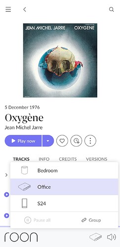

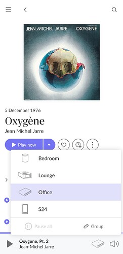

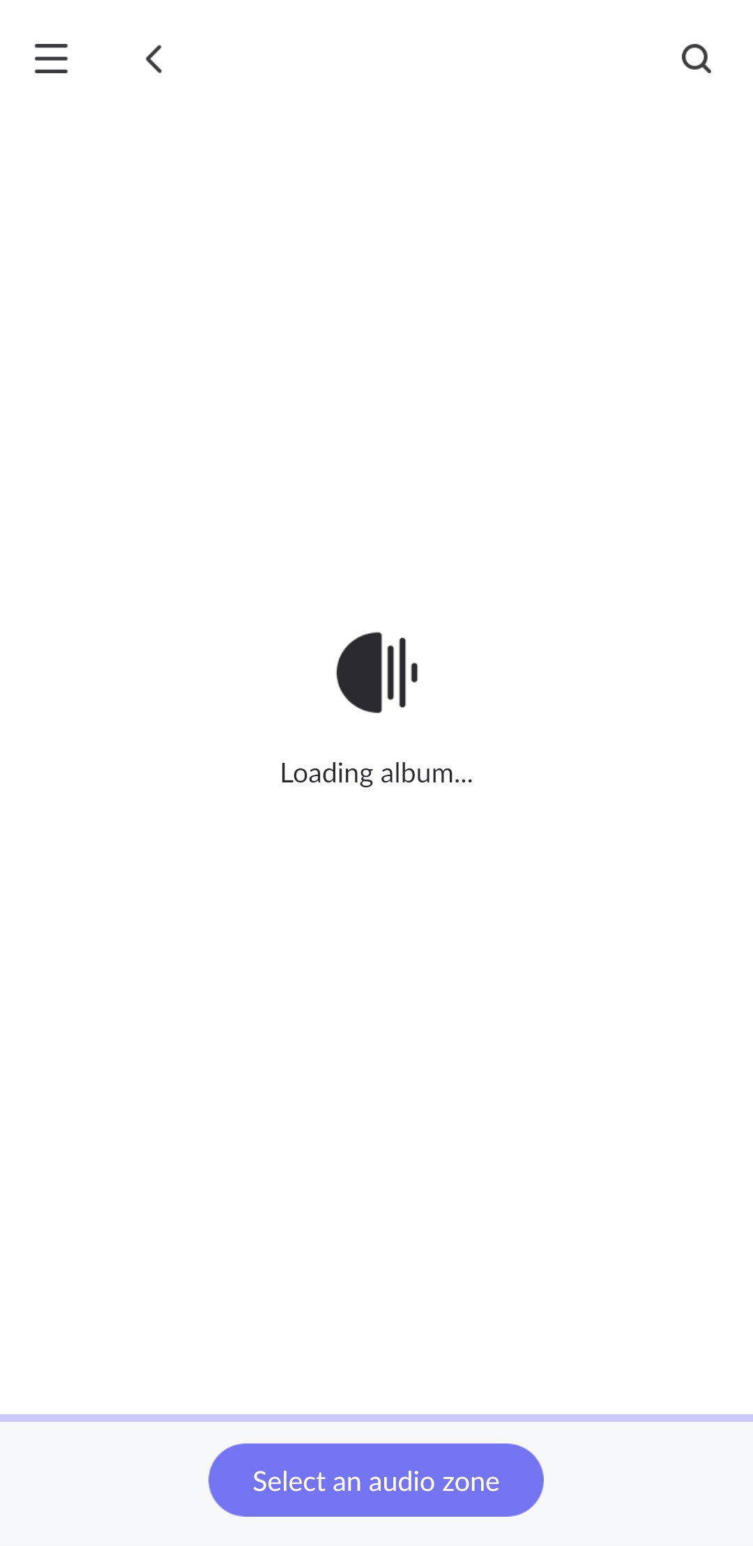

Playback gets interrupted as it drops all the roon zones. Sometimes it keeps the Sonos zone but all the others drop off. After a couple of minutes or so it will recover.
Drops at 10:53

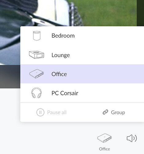

Sonos still there
Back again at 10:54

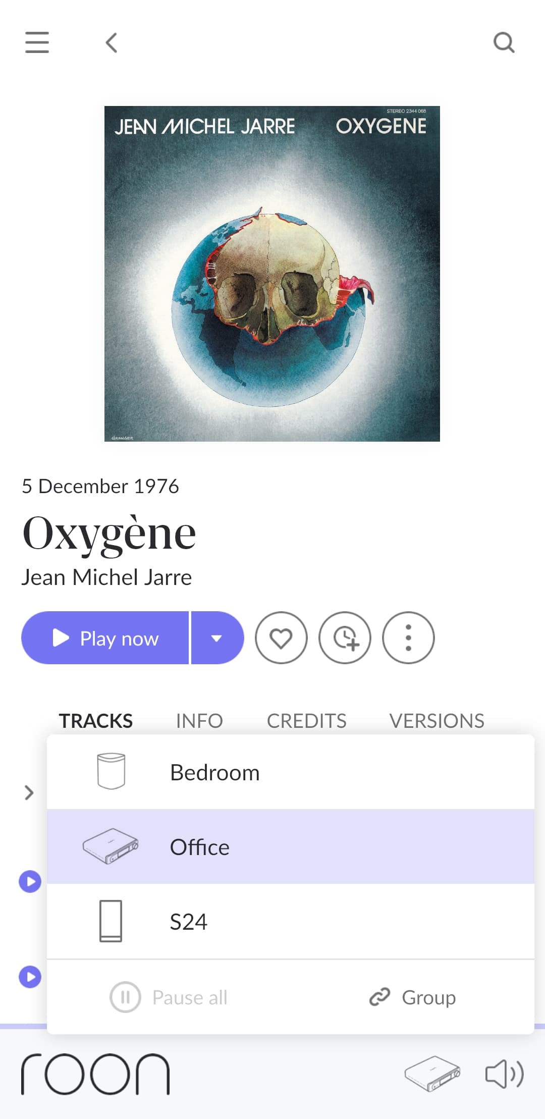

Dropped now a couple of times
14.52 local
Back up

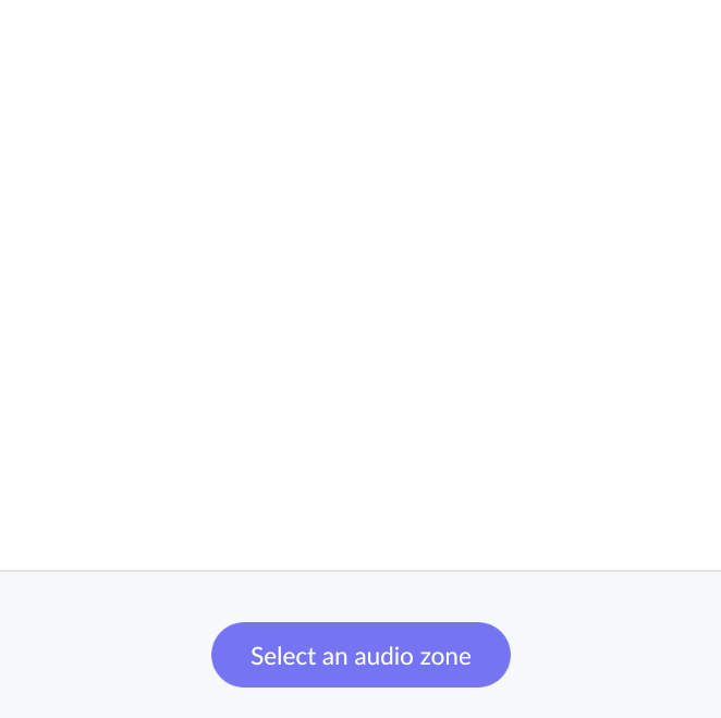

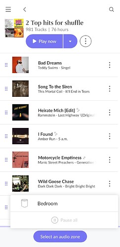

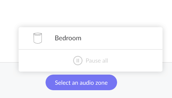

On its way back adding to zones list
Gone apart from Sonos. Whilst the other zones are gone I can play to the Sonos zone though it’s very slow to respond after selecting play or stop.

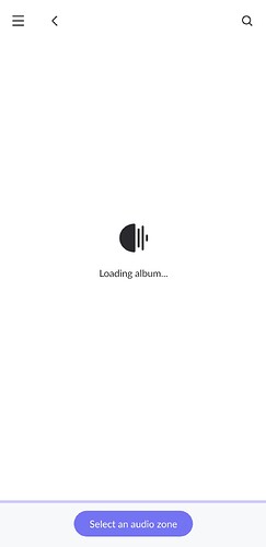

I am still seeing way too many zone disappear/reappear issues. Whilst it’s a bit random, I do see it quite frequently occur when I select and play a different/new album and replace the queue. Main listening is via Meridian ID41 but it does occur on other zones.
Looking at the queue also takes an age to display.
