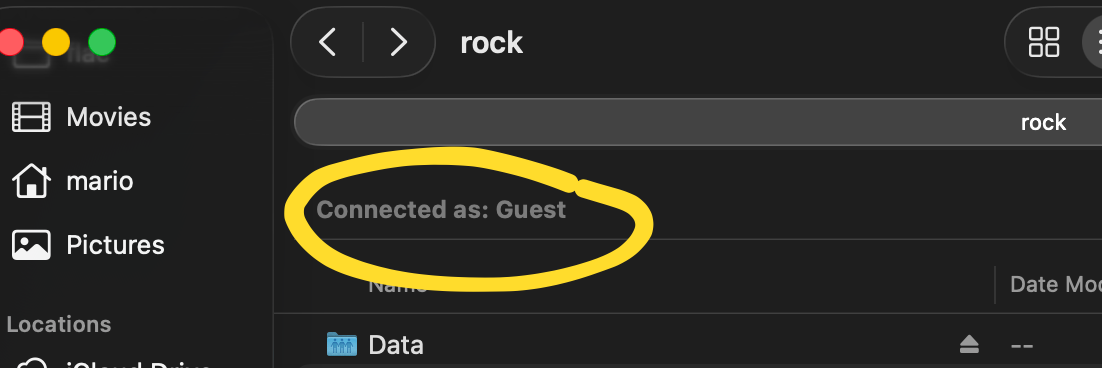

I have this, too. I just reinstalled ROCK with UEFI / OS 3.0, and when I connected from my MacBook (macOS 26.5) > Finder > Network to ROCK/Data, I was never asked to supply the guest/guest credentials.
It does say “Connected as: Guest”, though:
According to Apple, this only occurs when “guest” connections are allowed:
Select how you want to connect to the Mac:
  • Guest: You can connect as a Guest user if the shared computer permits guest access.
  • Registered User: Connect to the other Mac using a valid login name and password. If “Only these users” is selected on the other Mac, make sure the login name you’re using is on the list of allowed users.
