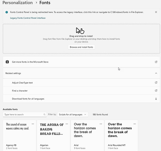

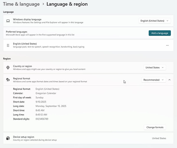

It’s possible that a setting around fonts, regional format, or text rendering in Windows is affecting how the search box displays. Could you please check your Windows font settings and regional format preferences, and share screenshots of those settings here? That will help us better understand what might be happening on your system.

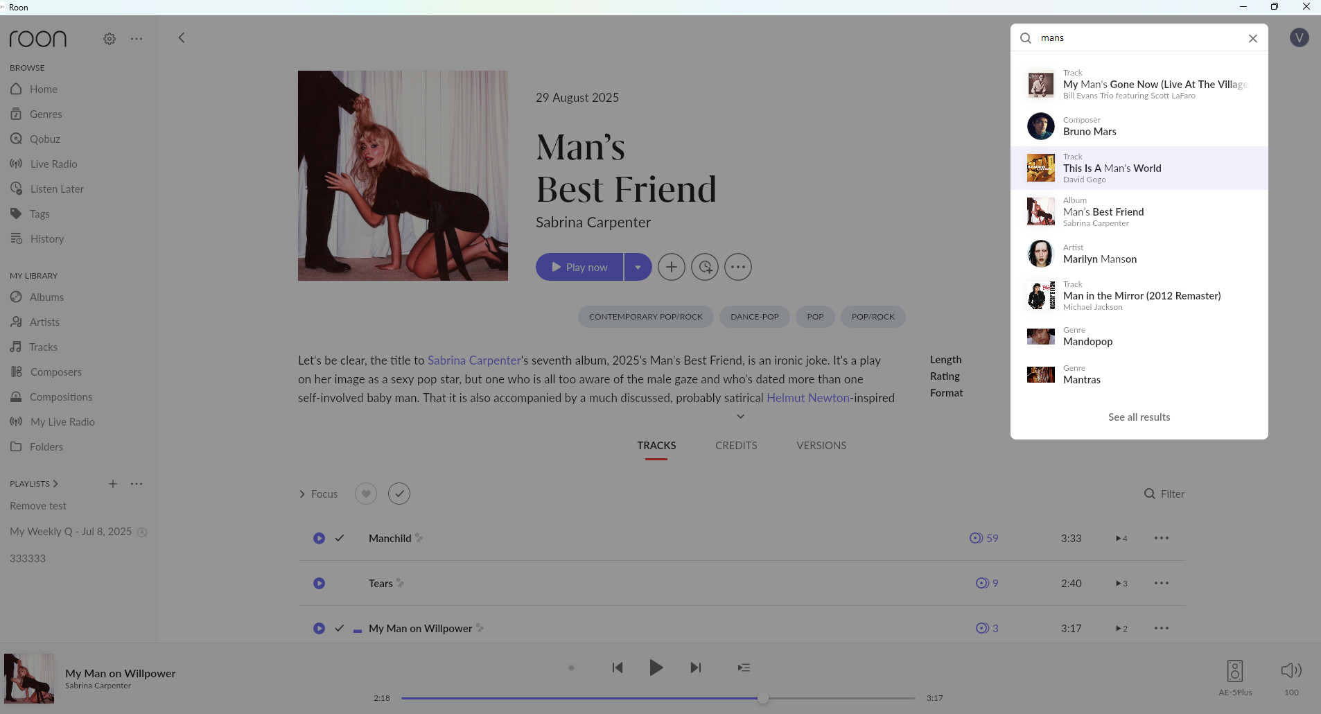

For the record, I have observed this, but not consistently. It appears to occur after repeated attempt to refine the same search.

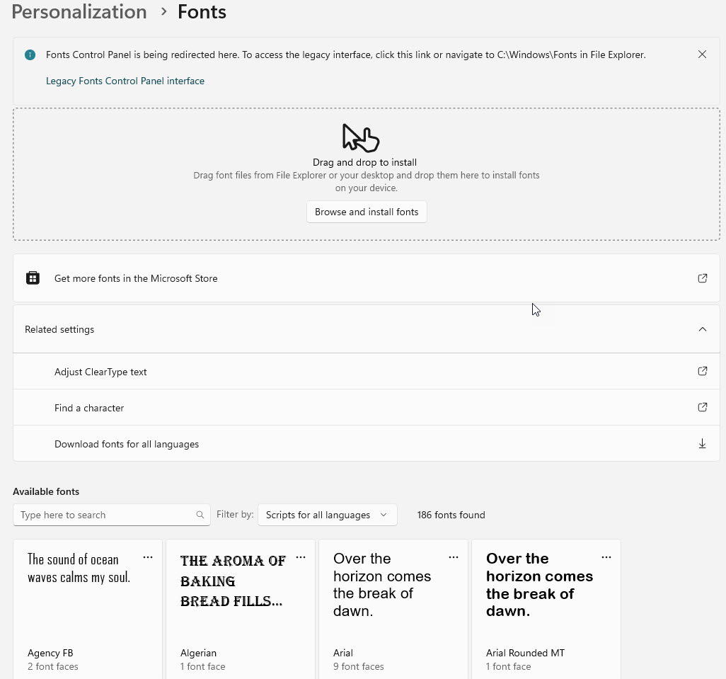

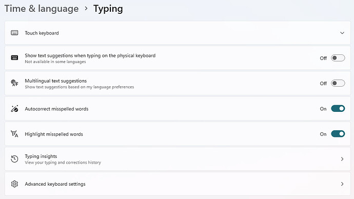

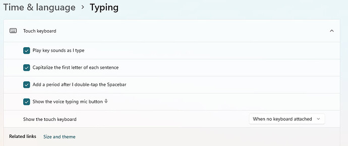

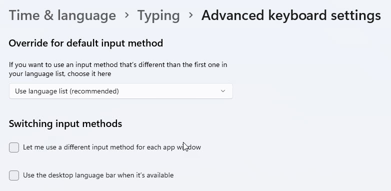

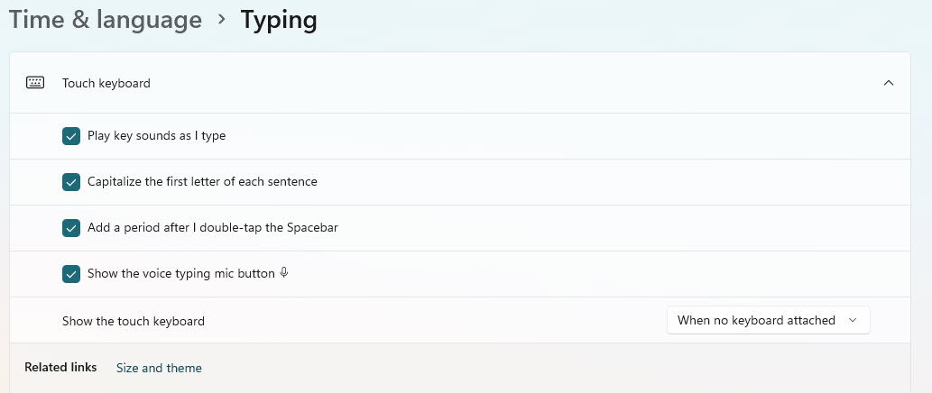

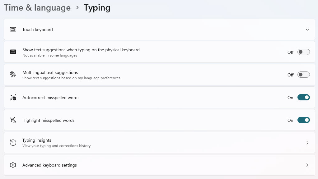

Hello @vadim – thanks for the reply! I agree that this is likely a Windows configuration issue. FWIW, I haven’t changed any configuration settings at all on my PC that I’m aware of, especially in the interval between Roon search text working correctly and the invisibility problem beginning. I tried rolling back Windows update to a time before the problem started and it didn’t fix the problem. I checked all the settings I could think of, related to the topics you suggested. All the settings appear to be default settings. Here are some screenshots:

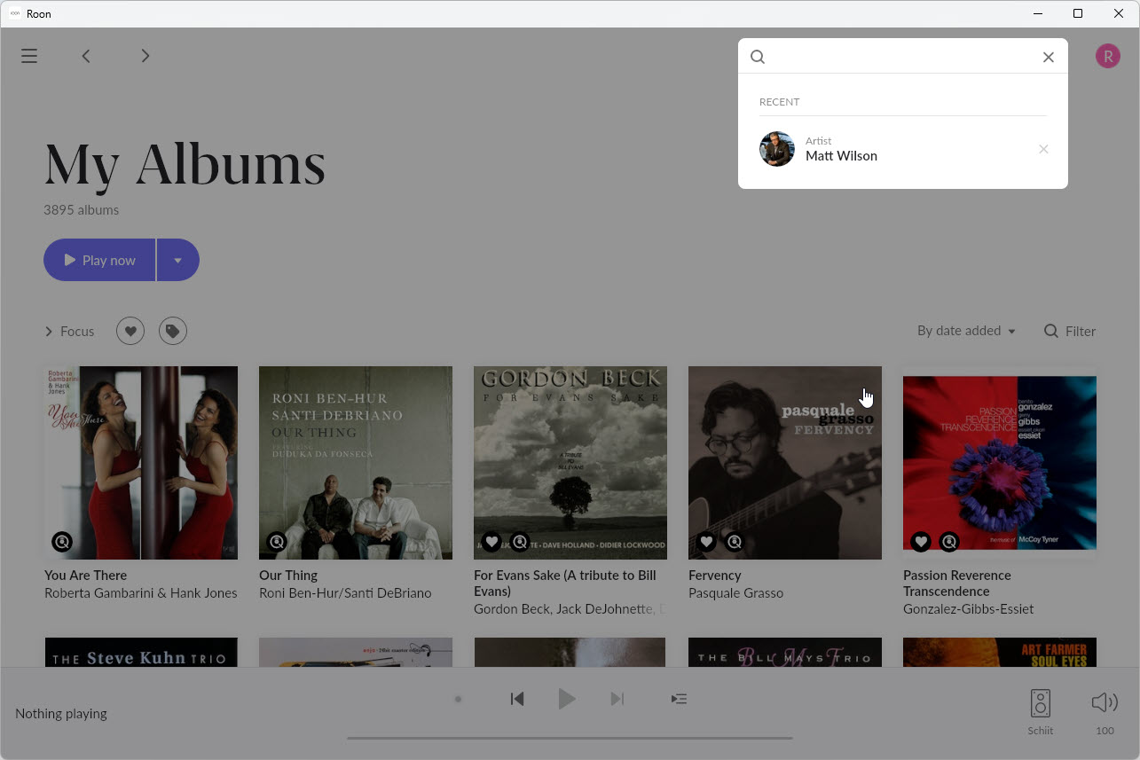

Hello @vadim – The invisible text box issue is consistent. At first I thought it was only searches, but it happens all the time in all text boxes, regardless of any conditions. For example, I just renamed an audio device and the text box did not display the cursor or anything I typed. The naming of the device did work, I just couldn’t see what I typed.

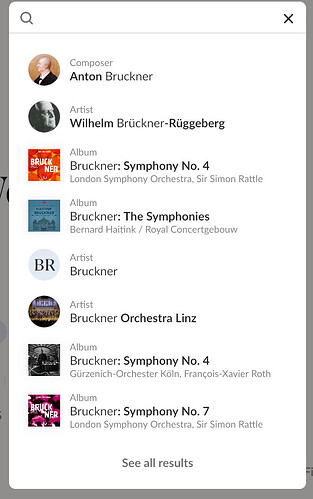

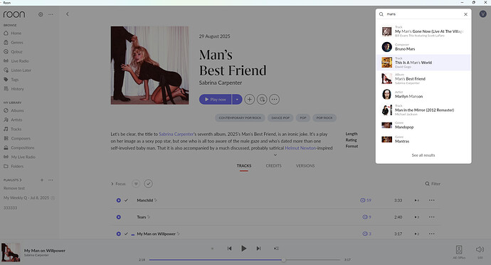

Thank you for posting that you have a Snapdragon PC. I’ve got a Surface Pro 12 - also Snapdragon-based - and I can confirm that the Search text field is invisible here as well. Example: Search text is Bruckner - not that you can see it…

Hello @connor – Here’s my reply:
  1. If you highlight text you’ve entered in the Search Bar, does it become visible? >> If by highlight you mean select, the answer is no. Is there any other way to highlight the invisible text?
  2. Do you have Dark Mode engaged in Settings? >> No. I tried Dark Mode and back to Light Mode and nothing changed.
@connor - my answer is no to both questions. Thanks.
