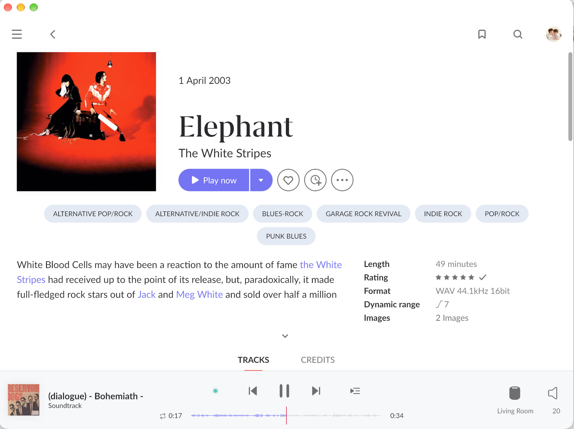

Another data point: My HomePod mini on 27 now works on the recently released hot fix from Roon.
Thanks to all at Roon who got this fix out so quickly!
