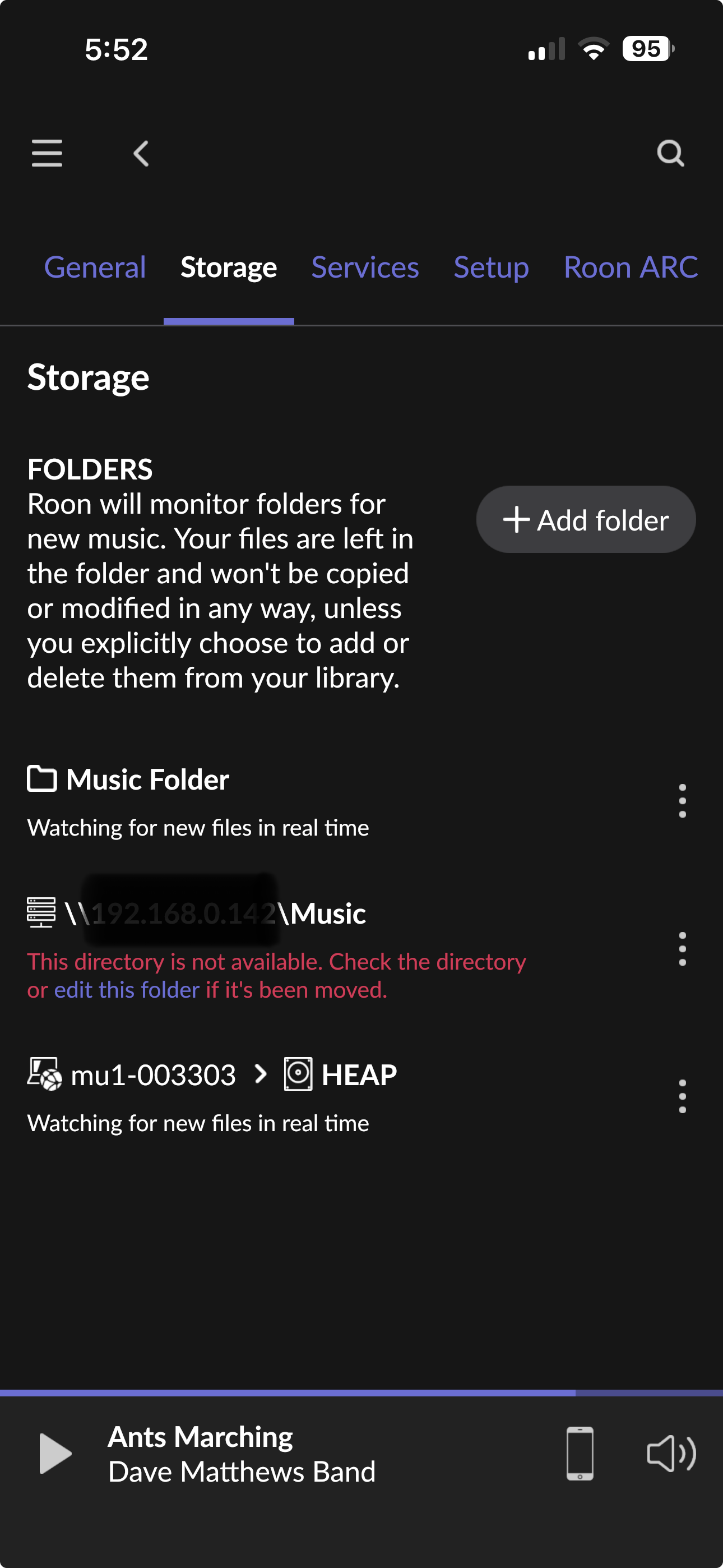

Today while at my desk I watched my albums (go from 1750 to 311), tracks ( go from 45,000 to 4,000), artists ( go from 3950 to 381). Additionally, I the music kept stopping every 45 seconds to minute while I got the purple circular spinning in the center of my screen. Then it would play and again and stop.
I also got this error "This directory is not available. Check the directory or edit this folder if it's been moved." then it lists my ip address\Music. Trying to paste this over but can't seem to get it to attach. It is on my other thread. My equipment is set up as follows: Grimm MU1 Streamer, Synology DS918+ NAS, Luxul 2624 Switchbox, LUXUL 5000 Router, and Dac is a Nagra Tube Dac. Ethernet is hardwired.

So, here is where I am. The Synology team had me establish a new static IP address. I did that successfully. HOWEVER, when I went into the Roon set up under Storage, Add New Folder, Add Network Share, Type in what is following under Network Share Location and did the \xxx.xxx.x.xxx\Music I get a RED comment back that There was an Unexpected Error. At this point I’m just trying to get the new IP to work because my old IP is now taken by something else. I know this is easy stuff for you guys but, I’m struggling and just wnat to listen to music.

As I have been troubleshooting, I may have found some success in Benjamin’s article when I clicked the Help button. I did assign the new static IP through Synology and have that working. When I went Settings, Storage, Add Folder, Add Network Share, I was adding the new static IP BUT not my username or Password for my Synology NAS and yet every time I go on the NAS I have to click through it. As soon as I did that BINGO it started to download from my NAS and it literally just stopped and I think I have my music back.
I can’t say I’m entirely a novice as I set up my wired and wireless system; however, one of the issues that I see for me personally is that when it was asking for a username or password, I should have known it meant for my NAS but when one panics with the thought of losing your music, as these situations may cause, I failed to connect the dots.
