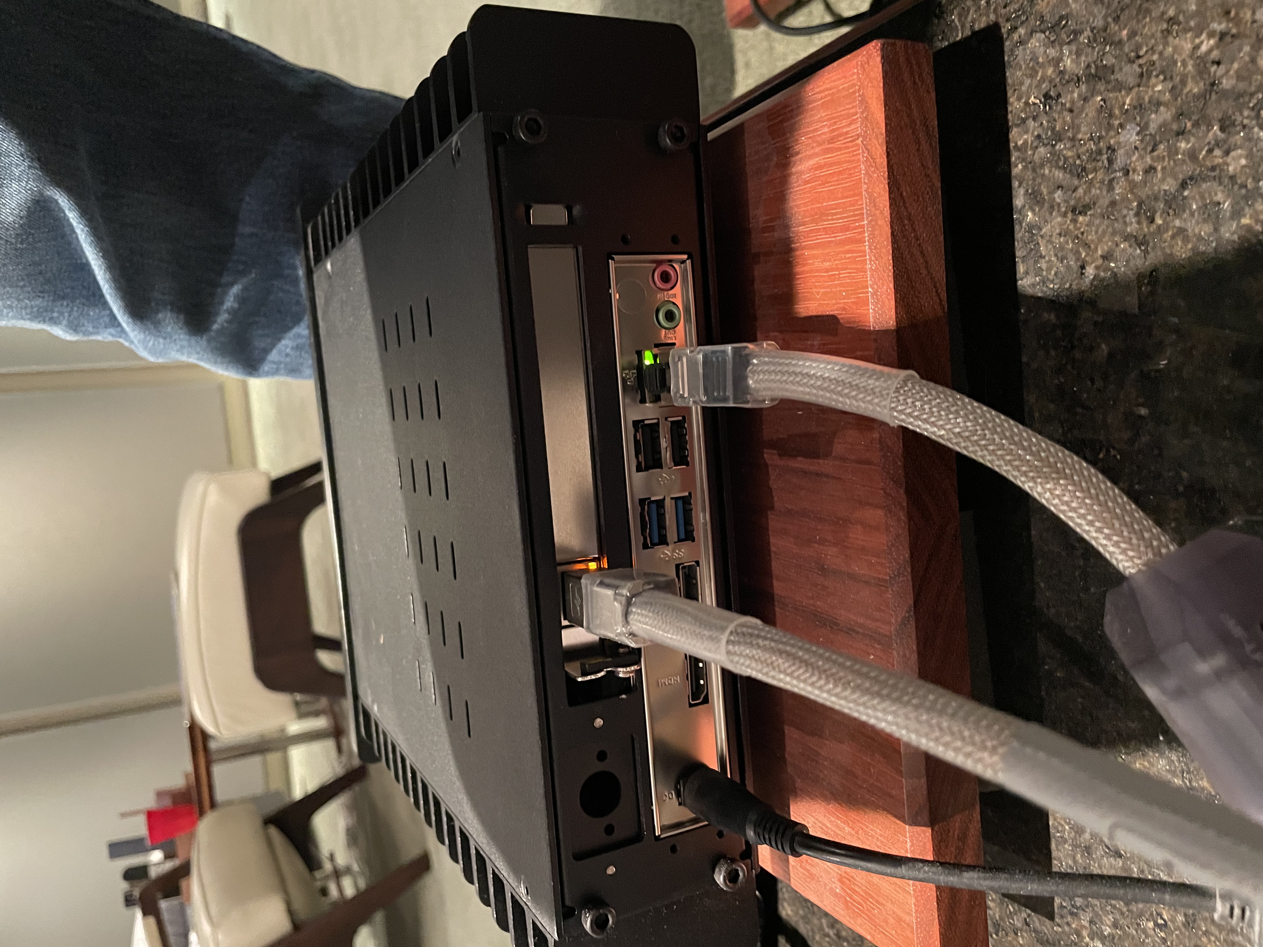

· On my iPad, Sonore will not find my i9 Sonicorbiter and roon.
Cannot locate roon on the Sonicorbiter or my Ultra Rendu.
· Verizon fiber to the house.
Cat 8 cable to Archer AX80 router
Cat 8 from Archer to FMC fiber media converter for audio.
Fiber optic to listening room, connecting to SW6-SFP LPS & gigabit switch for audio. I tested this switch another piece of equipment and it is working fine.
Ethernet cable to Ultra Rendu, Sonic Transporter i9, Synology storage.
The ultra Rendu has its usual, one green, one yellow light next to the ethernet connection.
The sonic transporter i9 has one yellow and one orange light next to the ethernet connection from the ultra Rendu and a yellow and the green at the connection to the network switch.
I use an iPad to control the system. Never any issues with that.
I have use this configuration for three years with no issues. Two days ago it stopped working.

I have rebooted everything numerous times. When I go to that page it usually shows the sonic transporter on top and ultra rendu below with them showing being connected at the right side of the page. Currently there is nothing at the right side of the page.

is it possible for you to connect both the Sonicorbiter and the Rendu directly to your router, with other, standard ethernet cables?
It sounds like there is something wrong in the way they are connected at the moment, like a faulty cable or so.
I have been using this configuration for 3-4 years with no issue.
I have swapped out the ethernet cables to a previous set I was using.
If only one or the other was not showing up it would make more sense.
