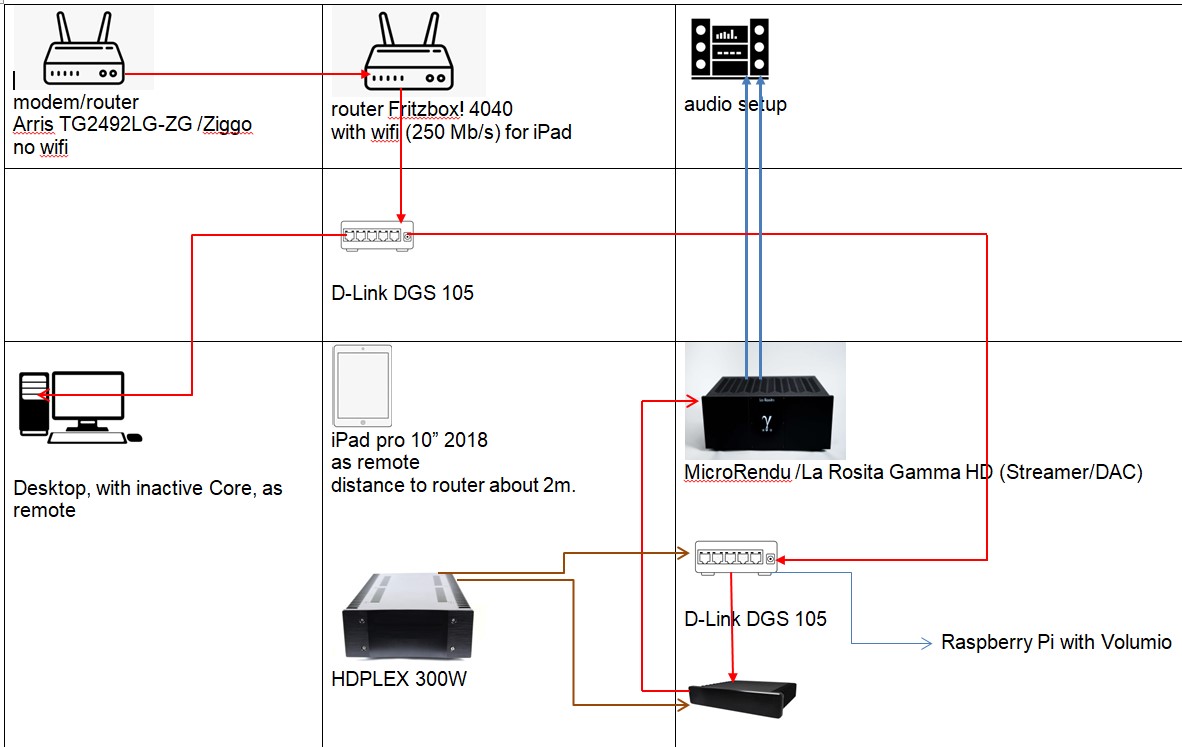

This morning I watched at a Networking for Audiophiles Webinar from Andrew Gillis on YouTube. He advised how to connect the devices in your network and I noticed that I had to change the place of the router and the first switch. My router with wifi should be the first to connect to my modem and after the router I have to connect the first switch. Now I have from the start no problems with disappeared covers on my remote and it runs independently from my PC. This is the result for today and I hope it will be permanent.
I’ll show the picture of my new network setup to make things more clear:
