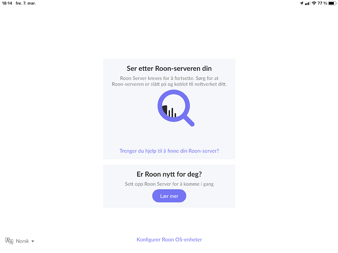

My iPad Os is 15.8.3, Synology Os is 7.2.2 and I do Connect the iPad to my other Synology Os 6.2.4 server. I guess this problem is related to the iPad Os version?
Previous answered, Mesh wifi network and synology NAS server running the Roon core.

Can you please share a screenshot of the issue you are seeing? I am looking over your account diagnostics, but I only see one RoonServer tied to your account.

According to your screenshot, it looks like there is no Roon Server found at all. Does the Roon app on your iPad have local network access toggled to on? You can check this by going to iOS Settings → Locating Roon app on the list → Ensuring Local Network Access is toggled to On.
Yes, I am quite sure that everything is enabled. The Synology NAS running Roon Core is connected by cable to the same local network. And the Roon app running on the iPad did work BEFORE the latest sw upgrades to 7.2.2 and IOS 15.8.3. Info: I too cannot access the 7.2.2 NAS from the Safari app from the iPad? I have enabled all SMB protocols, but no luck, and tried to enable AFP, however I got a warning message when doing that, that I should use SMB instead. From my point of view: this is because the iPad OS is too old? A number of apps I try to use on the iPad does not work, they require IOS 16 or higher, Apple for sure want me to buy a new iPad … :rage:
