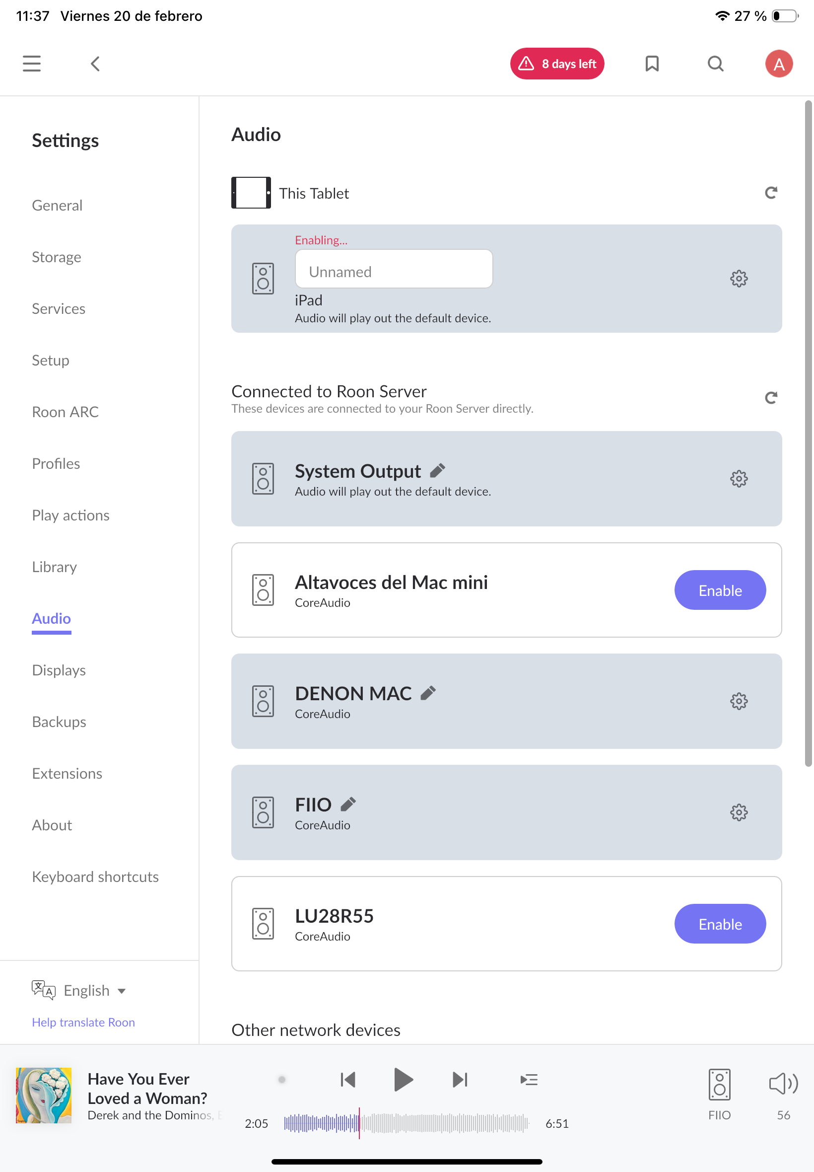

iPad stuck on 'enabling...' for audio output in Roon (ref#BODWK9)

Roon doesn't output to iPad. It appears as an audio device but stays on "enabling...".
I've tried two different Roon servers, and three different iPads and the problem is the same.
iPhone works perfectly fine.
Router Arcadyan PRV3397B-E-LT / Mesh TP-Link DECO
I suspect that your iPad is running Roon Production version 2.60, while your Roon Server is running an earlier version (or possibly Early Access version 2.59).

Oh yeah!!! That was indeed!!!
Problem solved!!
Lots of thanks!
