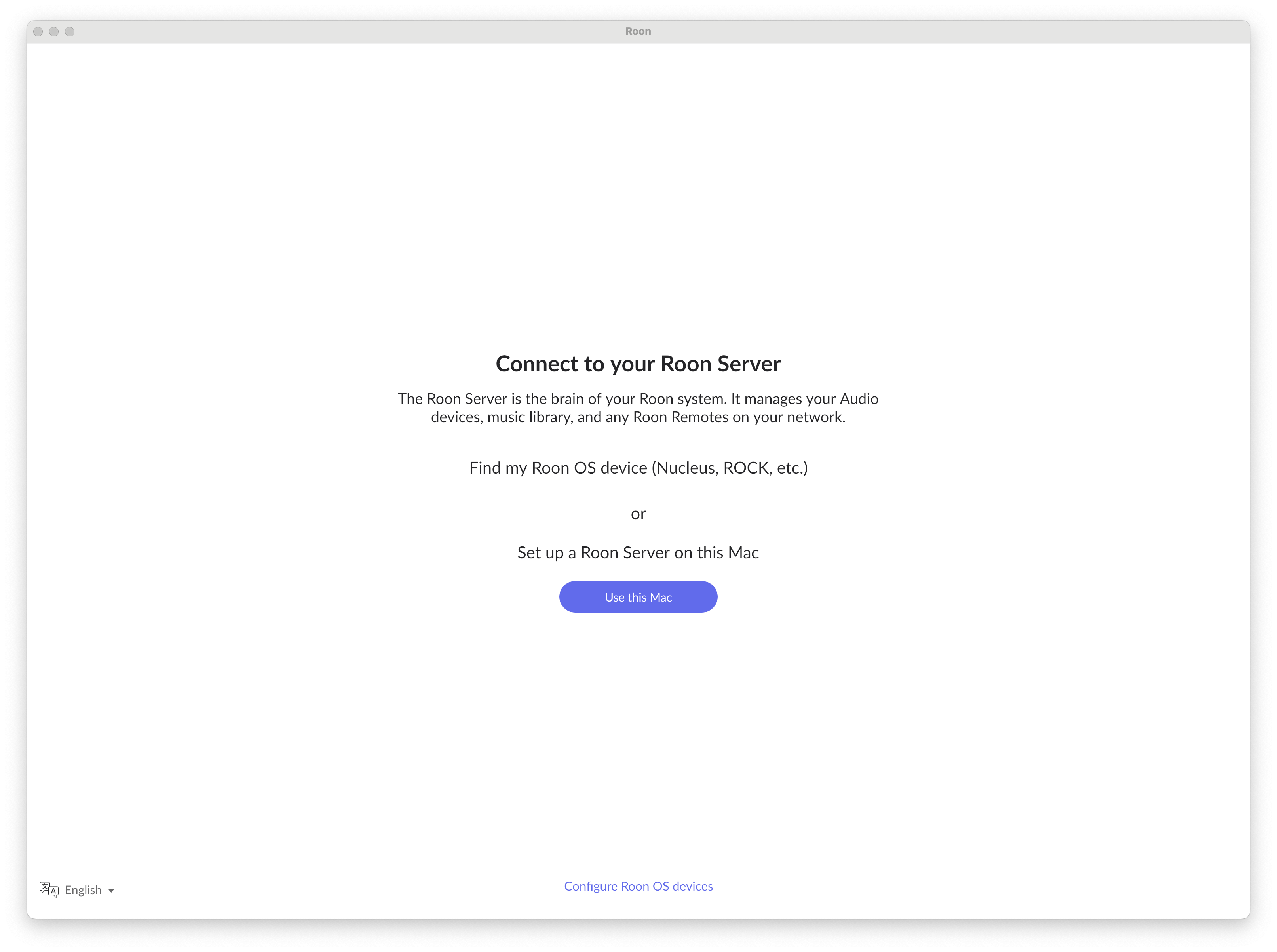

iPads Connect, Mac Cannot Connect to Roon Server (ref#JMJWOJ)
Is Roon Server running?
· "Waiting for your Roon Server"
What happens if you press the "Select a different Roon Server" button?
· I don't see Roon Server.
Please try to restart your Roon Server by closing the Roon app in the taskbar or rebooting your Roon Server machine.
· Roon Server is connected by *WiFi*
· *Windows*
iPads connect to Roon server, but not Mac
Airport Minis throughout house
Hello @Vince,
Thank you for reaching Roon support, nice to see you again!
Can you please navigate to macOS System Settings > Privacy & Security > Local Network , and make sure Roon is allowed. If it is already enabled, toggle it off and on again. Then reboot your Mac, and see if the same issue persists.
Hi @vadim, and thanks for this. I too was having the same problems as @Vince.
Once I had done as you suggested, everything was back to normal.
Hope you get yours sorted @Vince :+1:t2:
