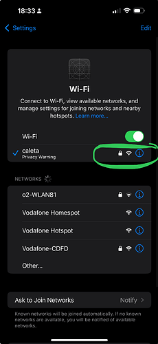

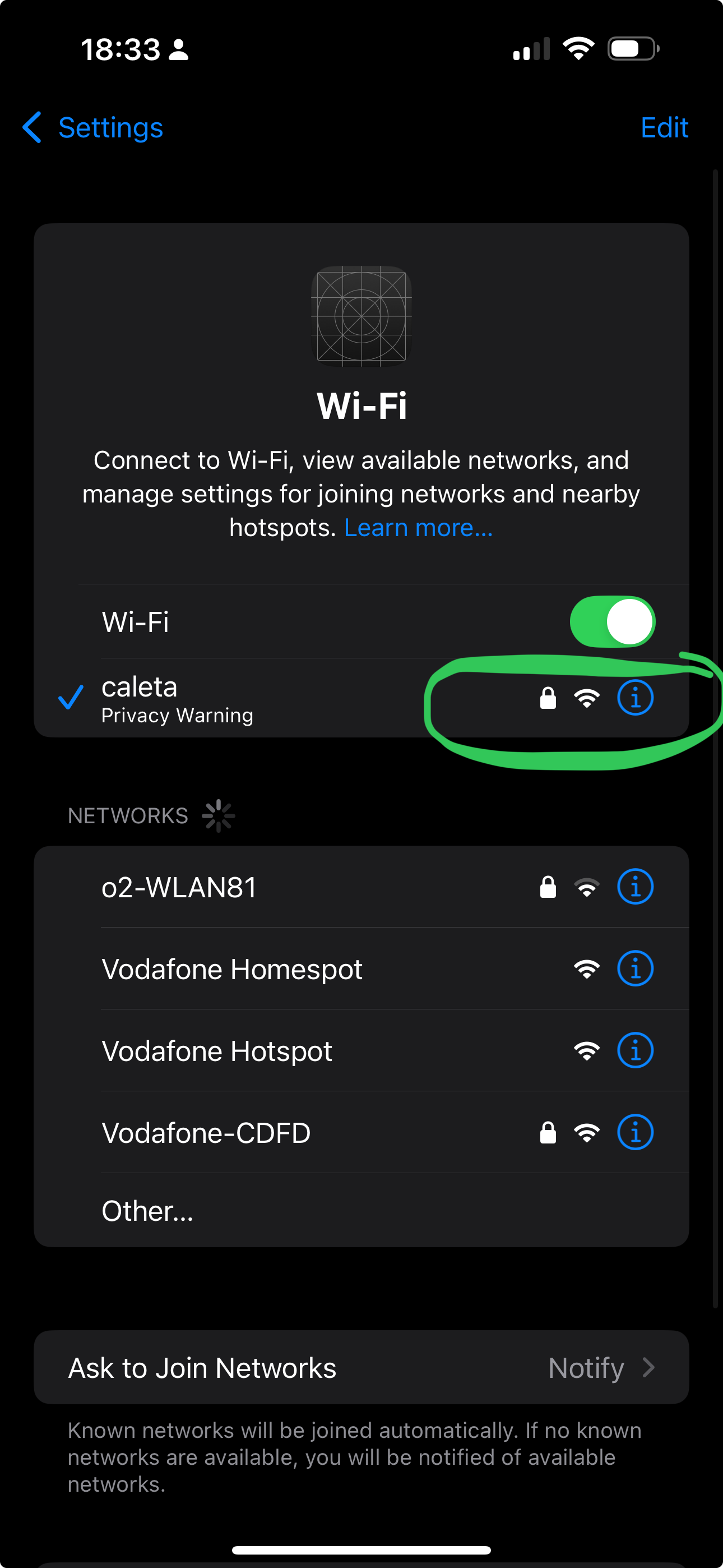

You can also try Settings > Wi-Fi > the (i) button for your WiFi network,
then scroll down to Private Wi-Fi Adress and turn it off. (On a home network, Off or Fixed shouldn’t normally make a difference. Rotate can cause connection issues, depending on the network and the router).
