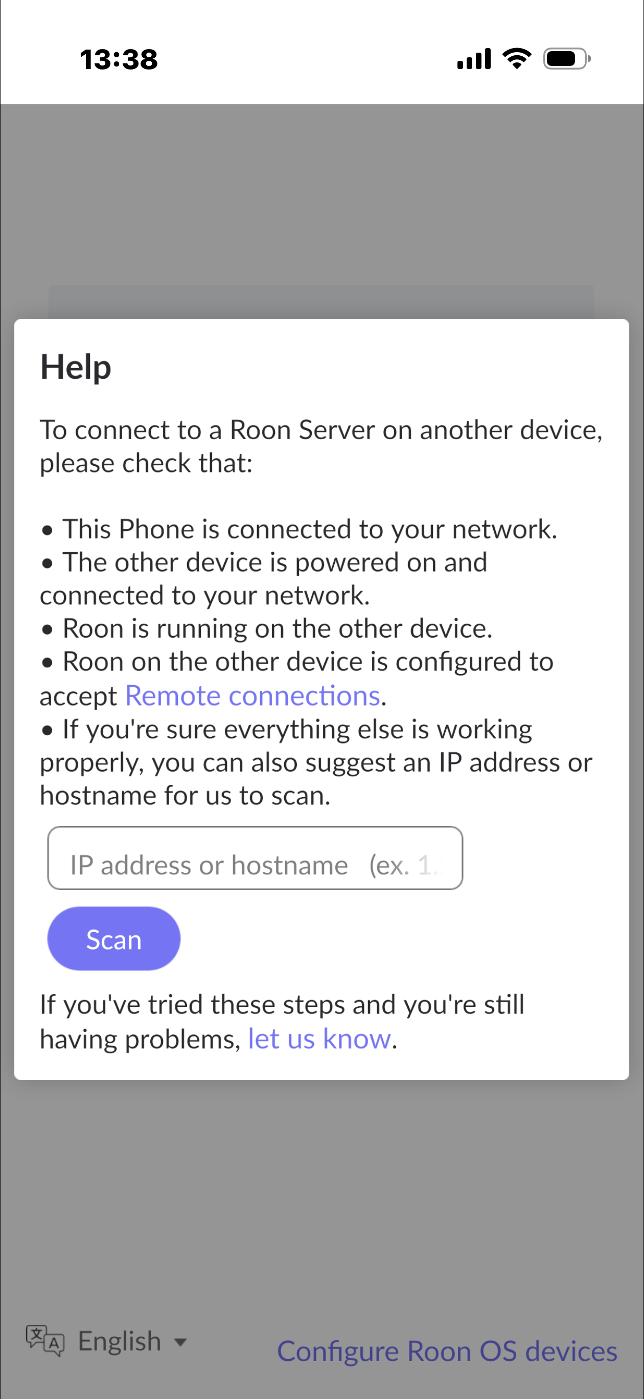

· Hi ..... Have the Roon App on authors iphone air and it does not connect however the main working properly and powered on .... so why does it not work .... checked remote connection and nothing works

…. local connection toggled on and off and noticed that ip address macmini m4 which las Roon server has a different ip address than the Roon app on the iphone air ip address …… so tried to do a scan thru the app on iphone sir and put in the correct or same as macmini and it still did not work …… strangly the ilhone 16 picks up the Roon app and can navigate with it ……. those are the results
