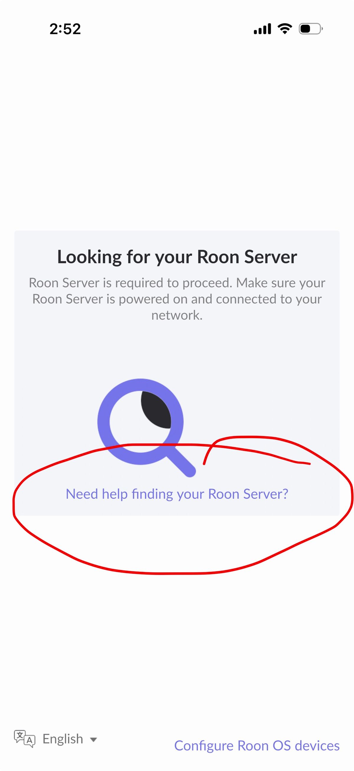

The i-phone app that I downloaded onto my Apple i-phone can't find my Nucleus+ server after I have followed instructions on how to solve the problem.
ASUS GT-AC5300 router; Netgear GS316PP ethernet switch; Linksys SE2008 ethernet switch

I checked the items on my iPhone that you asked me to, to the best of my ability, and re-booted my iPhone - a brand new iPhone 17 Pro Max that I got on Monday and still the Roon app on my iPhone cannot find my Roon server.
