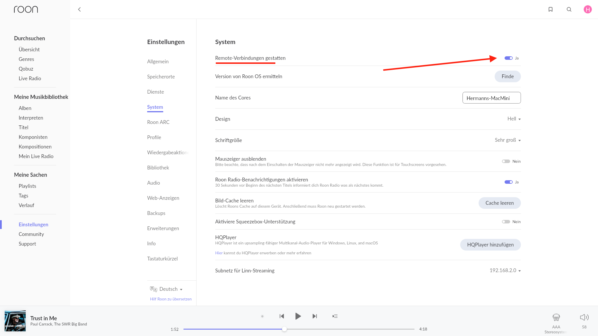

Hi @Daniel_Ger try Roon>Settings>Systems>Remote connections
