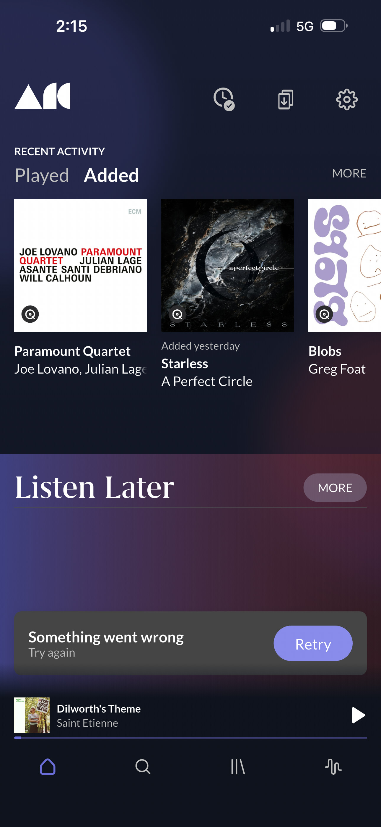

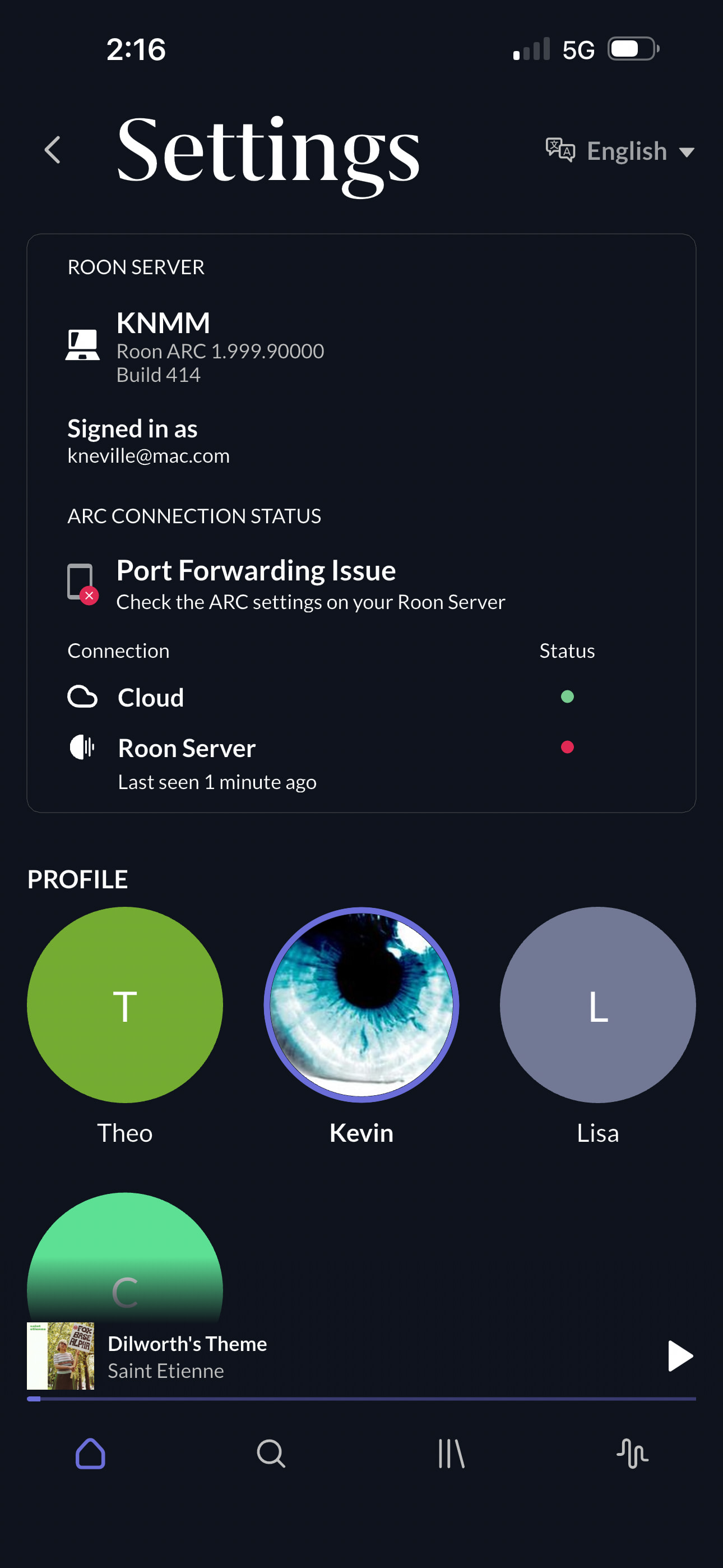

My iPhone will not stay connected to my Roon server away from my home network. This happens on cellular and other wifi networks. Sometimes the phone won't connect at all, other times it will play a song, maybe a few songs and then playback stops. When I check settings in ARC on my phone, I see a green cloud indicator, but a red indicator for the Roon server and the ARC connection status indicates a port forwarding problem. I use a service called 'Screens' to connect to my Mac mini Roon server when I'm away from home. Doing that, checking ARC settings in Roon, I see a 'Ready' status. I click 'Perform Connectivity Test', get 'Ready' again, and then my phone connects, but only for a handful of songs and then I have to go through the steps again.

1415 local time (EDT) today 6/5/26. Just switched off wifi on my phone while at home. Status was all green indicators, ‘ready’. In Roon’s ARC settings, initial display was “Testing” but with no interaction from me, that quickly flipped to ‘Ready’ and ARC is functioning.
The cell signal is weak inside my house, but I’m certain I can duplicate it outside with a stronger signal as well, happens regardless of signal strength.

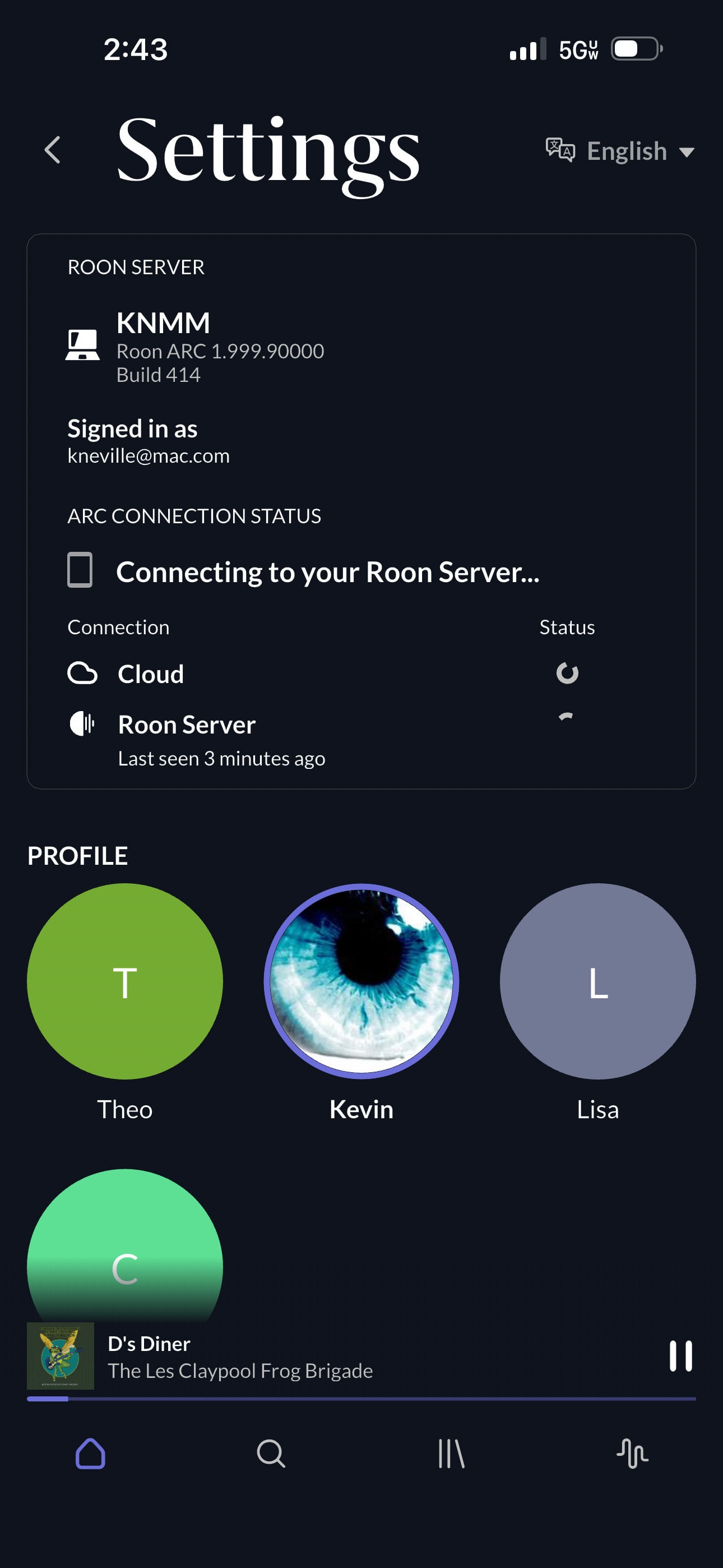

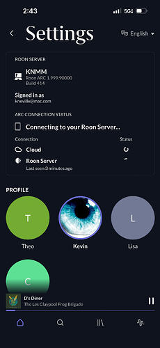

Just for good measure, started playback while connected to wifi, then turned wifi off. Played through 1 track, started a second, but connection has been lost during second track at 1441 EDT 6/5/26. Playback continues on the second track (buffered data, perhaps?) but tried to perform a search and it hung. Currently seeing Cloud and Roon Server indicators spinning in ARC settings on my phone. Surprisingly, a third track has started playing while indicators are spinning. Stepped outside for a stronger cell signal.

Thanks so much for the additional information and screenshots. Based on the behavior you’ve shared, it sounds like this could be a double NAT + port forwarding timeout pattern.
Your port forwarding rule on the G3100 works, but NAT session tables have a timeout. When your phone switches from WiFi to cellular (or just sits idle), the TCP connection drops and the router forgets the mapping. Roon ARC can’t re-establish it without a fresh “knock” which is why manually triggering the connectivity test in Roon fixes it temporarily.
