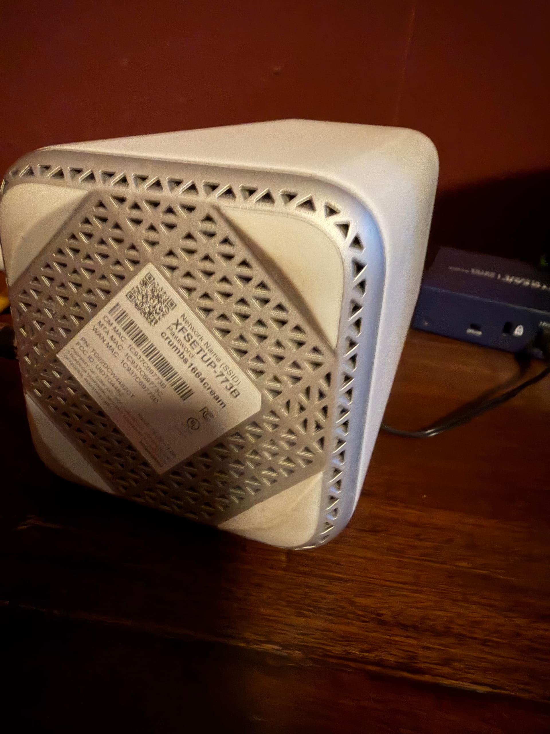

  1. It is leased from Xfinity. It has no brand or model name. Below is a screen shot of the only identifying information there is on the device.

Well, from doing a little AI reasearch, it appears that this is an Xfinity XB7-T Gigabit Modem WiFi Router.
