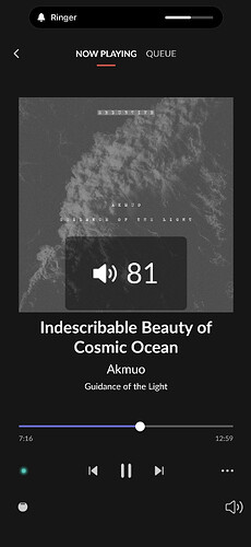

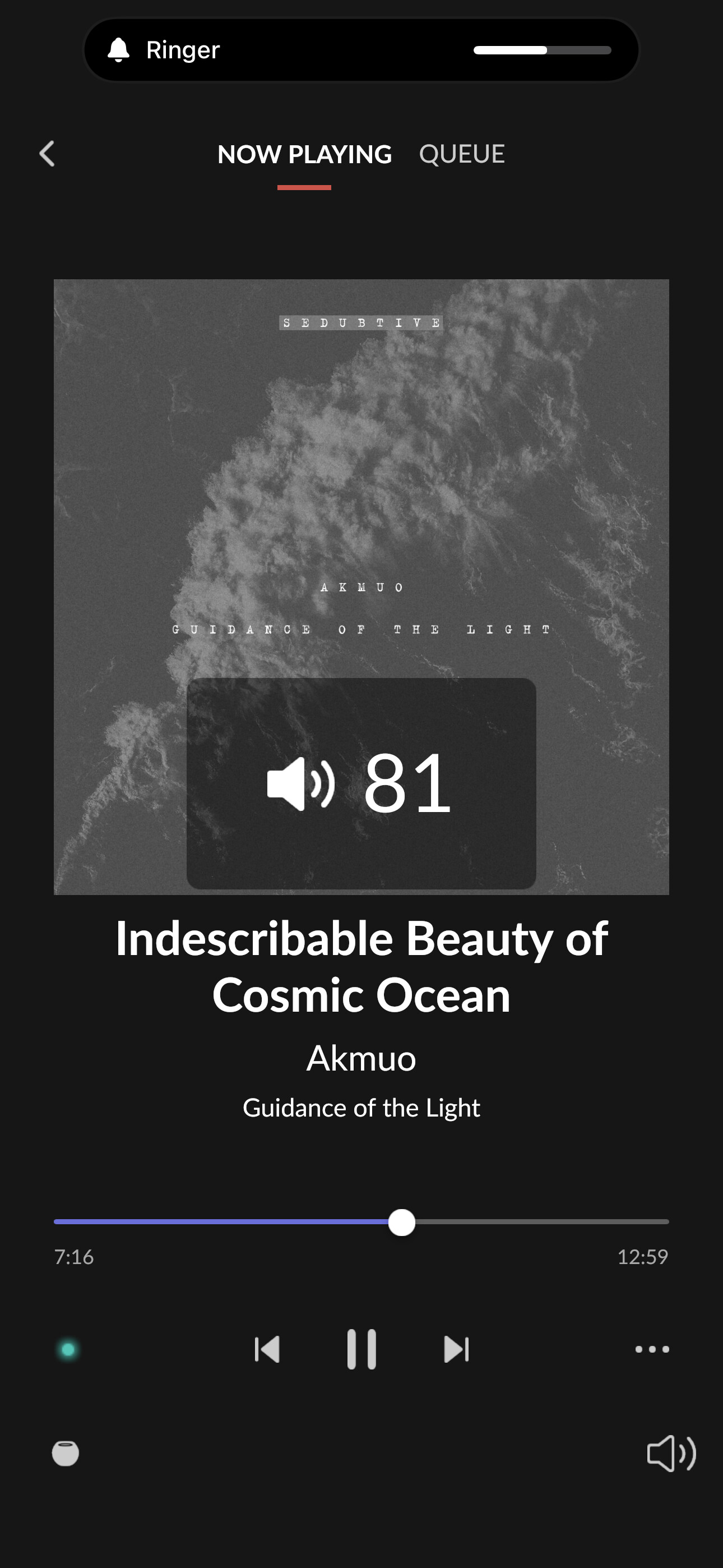

Replicated the issue on April 20th at 7:49pm MST. Curiously this time both up and down on the volume controls were reducing the volume rather than increasing - I seem to recall it doing the opposite.
Also, attempting to adjust the volume in Roon was resulting in simultaneous control of the ringer control of the phone.
