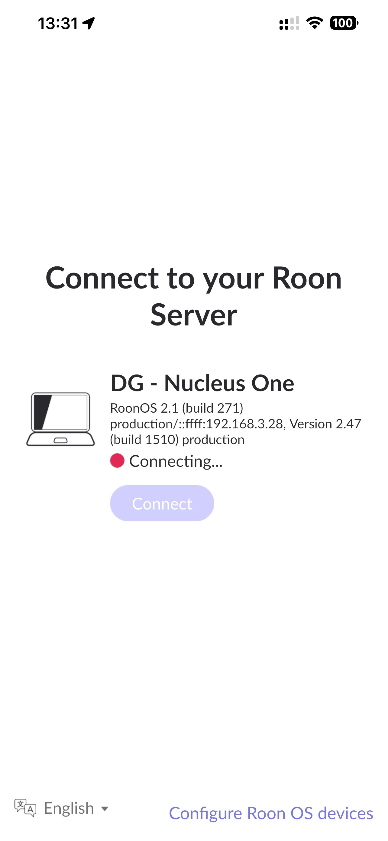

I have followed all of your advice and no luck. if I do reboot the Roon nucleus one the iPhone does now recognize the ip address and try to connect, but it never moves beyond this point (see screenshot - attached).

Thank you for your post. Did you formerly host RoonServer on a MacOS machine? Our diagnostics servers show that there’s a second active RoonServer associated with your account.
If you did migrate to the Nucleus One recently, how precisely did you perform the migration?
