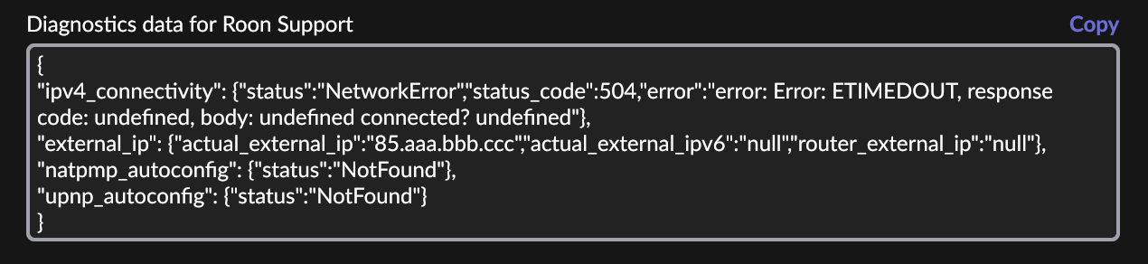

IPv4 Connectivity Network Error with IP Details (ref#8R4PRS)
"ipv4_connectivity": {"status":"NetworkError","status_code":504,"error":"error: Error: ETIMEDOUT, response code: undefined, body: undefined connected? undefined"},
"external_ip": {"actual_external_ip":"85.aaa.bbb.ccc","actual_external_ipv6":"null","router_external_ip":"null"},
"natpmp_autoconfig": {"status":"NotFound"},
"upnp_autoconfig": {"status":"NotFound"}
Zyxel modem in bridge mode
Linksys router as hard wired router and wifi router
It looks like either your router does not support uPnP or natPmP or those services are turned off in your router. If possible, you could try to enable uPnP in your router and see where that gets you.
If uPnP does not work, then you need to setup port forwarding manually.
Use of both uPnP and manual port forwarding are explained in the Roon Help Centre article at:

Hi @BergeP,
This network has multiple NAT layers, so port forwarding will be vulnerable to port conflicts or firmware resets between multiple routers (not to mention ISP implementation).
Since your ROCK machine appears to be a UEFI-based model, you might find the RoonOS Tailscale interface to be a simpler solution than port forwarding.
Hey @connor
Got rid off one of the NAT’s and all good now.
