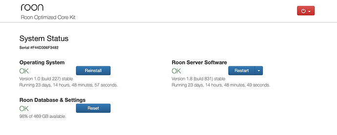

If you have a ROCK build, can you reach the web user interface. When you enter the IP address of your Core into a web browser, you should see something like this:
If that works, please share a screenshot.
If you can get to the web interface, try using the red button on the top-right to reboot it. You could also press the power button briefly, wait until the unit switches off, and then press it again.

Thanks everyone for your help. I have now connected the NUC to a monitor and got the address http:192.168.1.12/. After putting that into my search engine I got a display similar to the one that David posted above. Operating system, database, server software and internal music storage were all showing as OK. I then re-booted twice:
  1. “error device has not rebooted”
  2. “error could not be rebooted check network connections” After that I did a reset of my router and turned the NUC off and on. This is probably important. I noticed that the NUC is now showing one green and one amber light at the network port instead of the customary two green lights.
    After this, my PC lost connection with the NUC, and Windows diagnostics said that “device is not responding” although it confirmed that the computer connections were fine.
