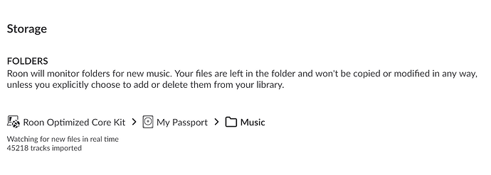

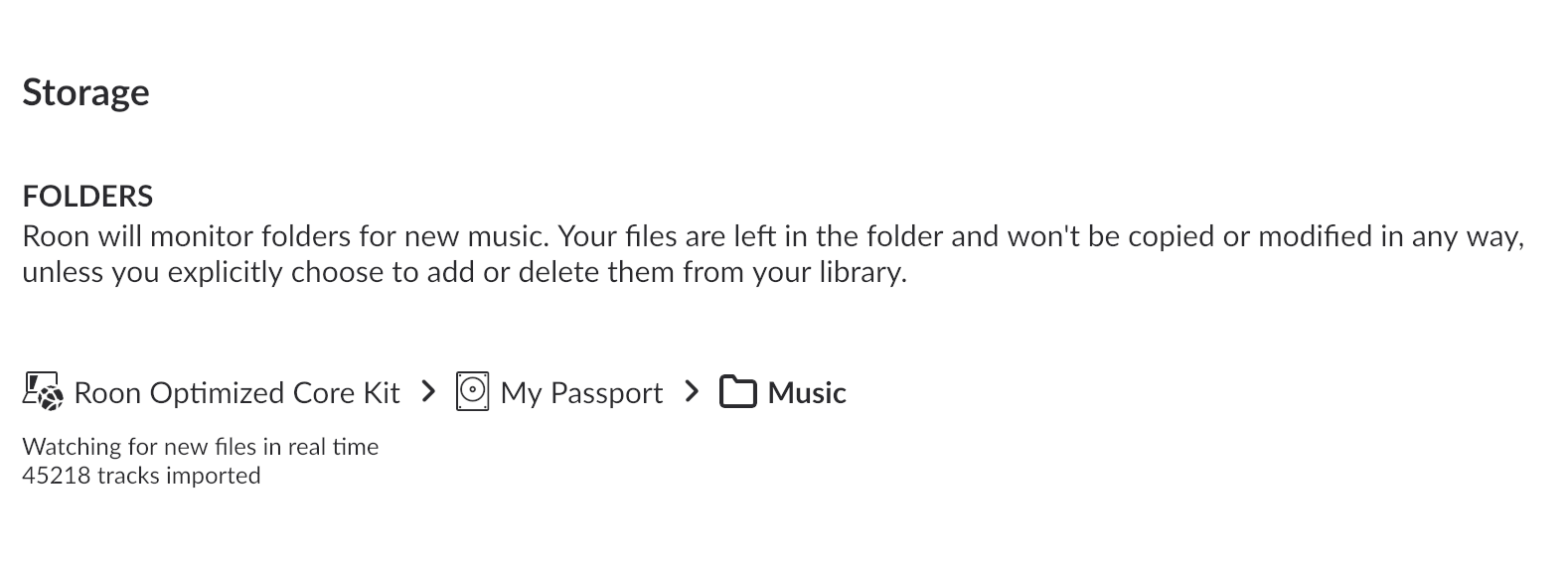

This isn’t really the case. It all depends on how you set it up. When you attach a USB drive that you want to use for both storage and backup. You create 2 folders, one called Music (or whatever) and one call Backup. Then in Roon Settings/Storage you enable Roon to watch the Music folder. Then you can setup the backup process to use the Backup folder.
If you set Roon to watch the whole drive and not individual folders, that is when you have an issue.
That’s how mine is setup and working
Interesting–no red message. It just did not back up…
Right – I have Roon watching the music folder, not the whole drive, FWIW.
