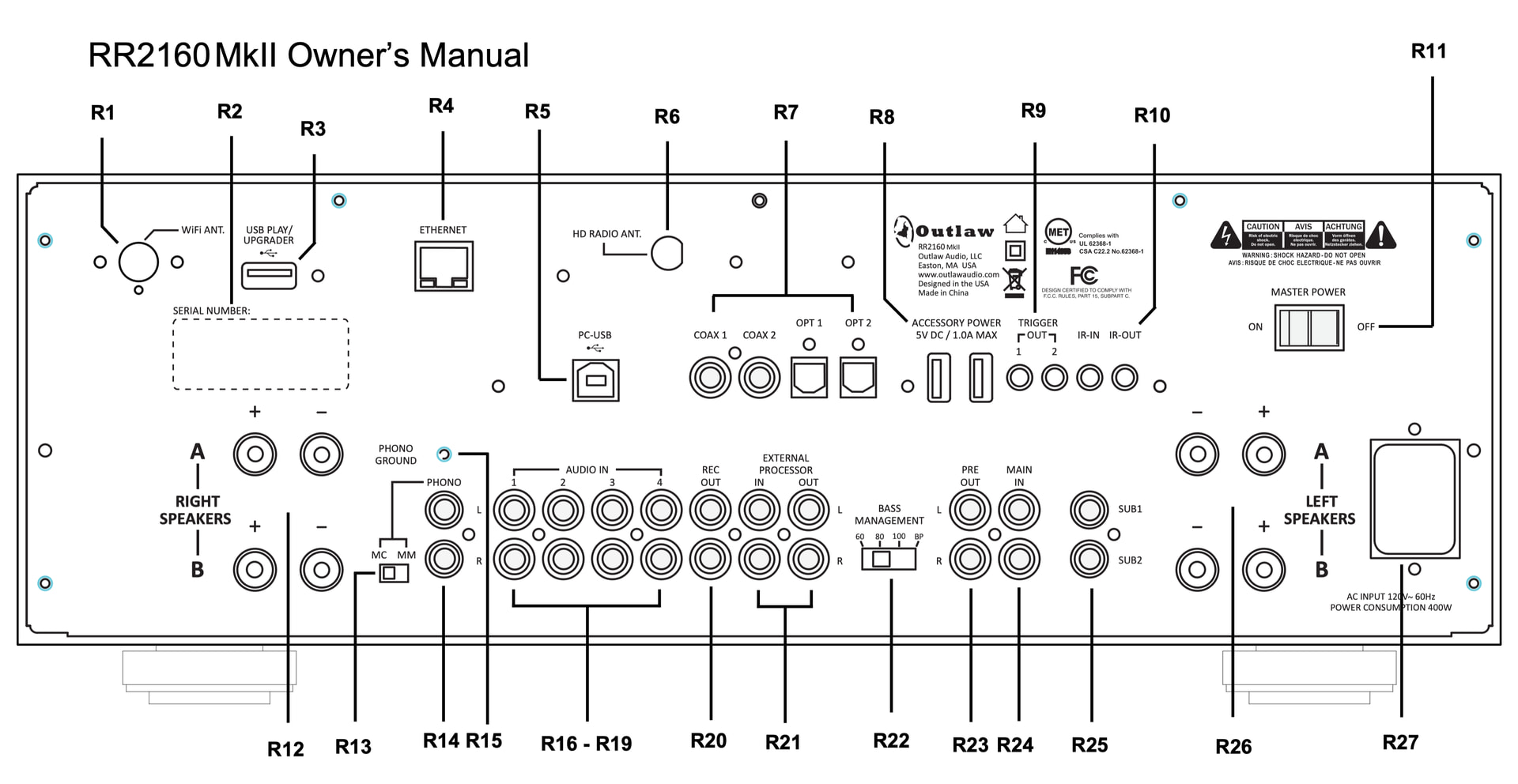

The Outlaw looks pretty nifty and I’m sure it was a premium device when it first came out. Fortunately, it looks like it can be connected to Roon via USB. This may help you take Roon for a spin and see if it’s what you’re looking for.
The port labeled R5 would connect to your Apple laptop and Roon should recognize it as a locally attached music device. The following quotes are taken from the manual at https://outlawaudio.com/outlaw/docs/RR2160MkIImanual.pdf
“Connect the RR2160 MkII to a computer and select the PC USB input to allow the RR2160 MkII to act as an external sound card.”
Pg 27 from the manual states:
When a computer is connected to the PC USB port (R5), select the PC USB input using the Source button (F18) or by pressing the USB source selector button on the remote (C3).
Once that input is selected, any audio from the computer will be played through the RR2160 MkII.
For evaluation purposes, you could sit next to the Outlaw with your laptop and connect them via USB cable.
