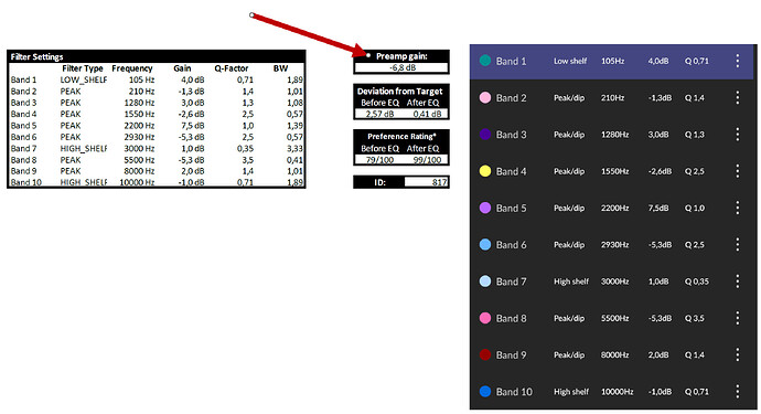

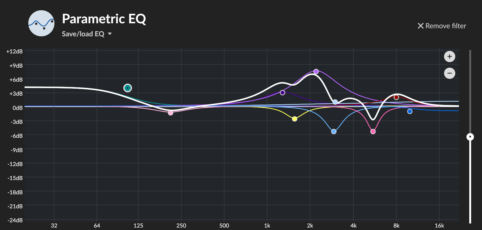

Does the value “Preamp Gain” - in this case -6.8dB - have to be added to:
I am using “Volume Leveling”.
Thanks
Torben

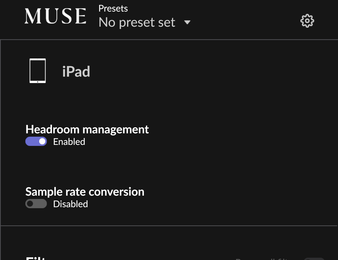

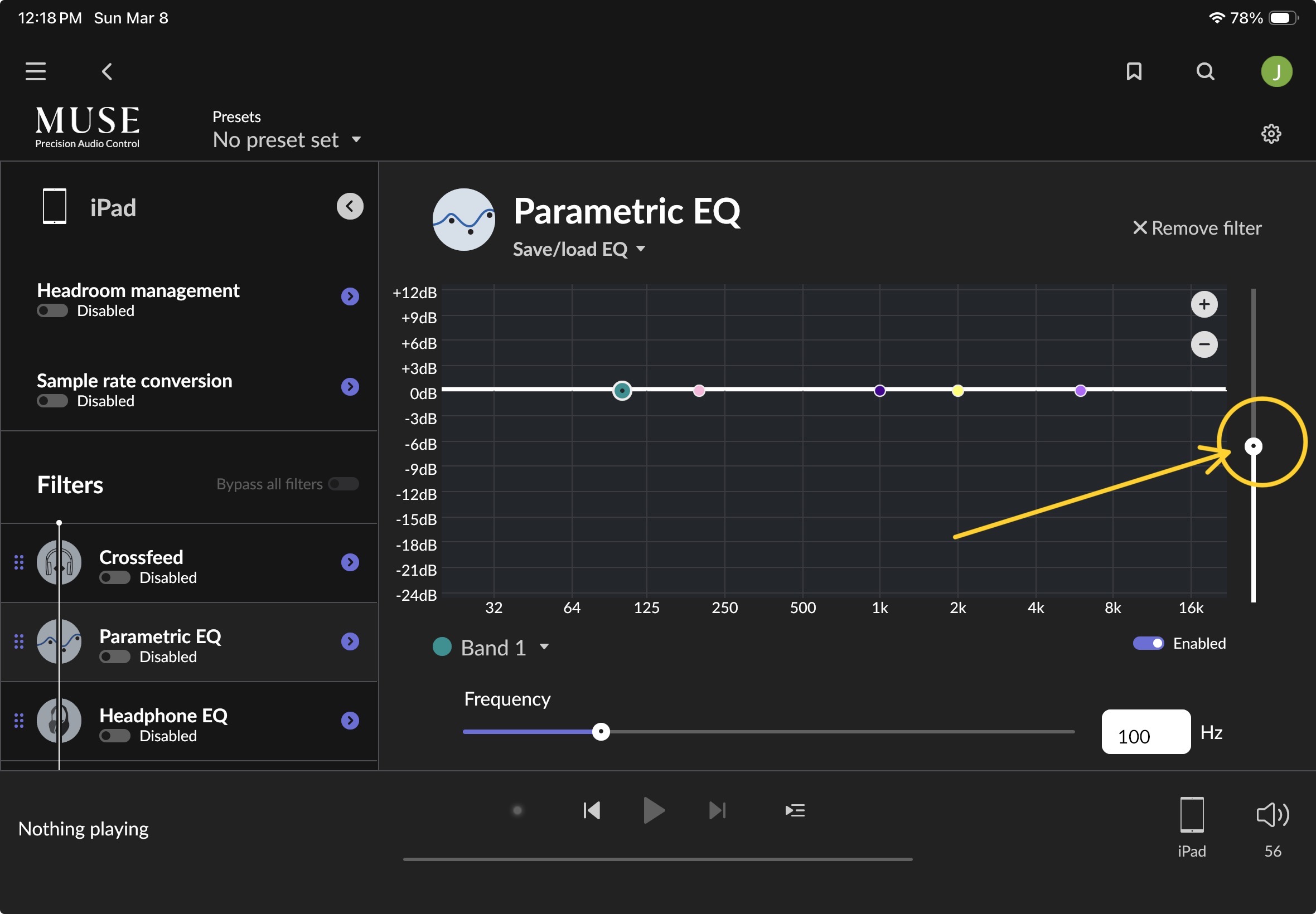

Use the slider in the PEQ screen to adjust preamp gain. This way the adjustment only applies to that PEQ setting. The headroom adjustment will apply the gain setting to everything going to that endpoint regardless of PEQ setting chosen.

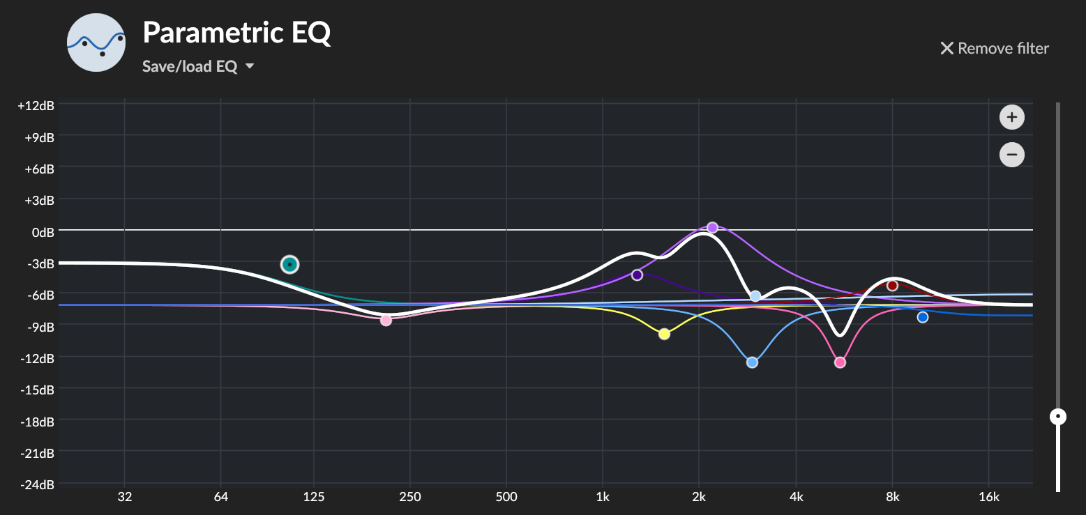

Does this looks right?
Torben

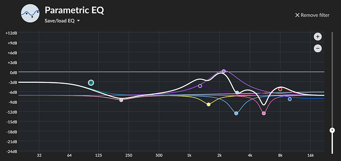

You’re looking to get the highest peak on the white line below 0dB by using what @Saturn94 mentions :+1:
Like this
Torben
Yep, this requires no headroom adjustment :+1:
Although, I do set headroom to 0 and enable the clipping indicator and enable the DSP.
Do you use volume levelling?
Yes :slight_smile:
Torben
THX. But what do you mean by “enable the DSP.”?
Torben
Having it set to zero and the clipping indicator active and this DSP active/enabled will give an indicator if you need to adjust the gain more.
As you have VL on then this isn’t likely to happen.
@MusicD + @Saturn94 - Big thanks for your help. Highly appreciated
Time for some music now :slight_smile:

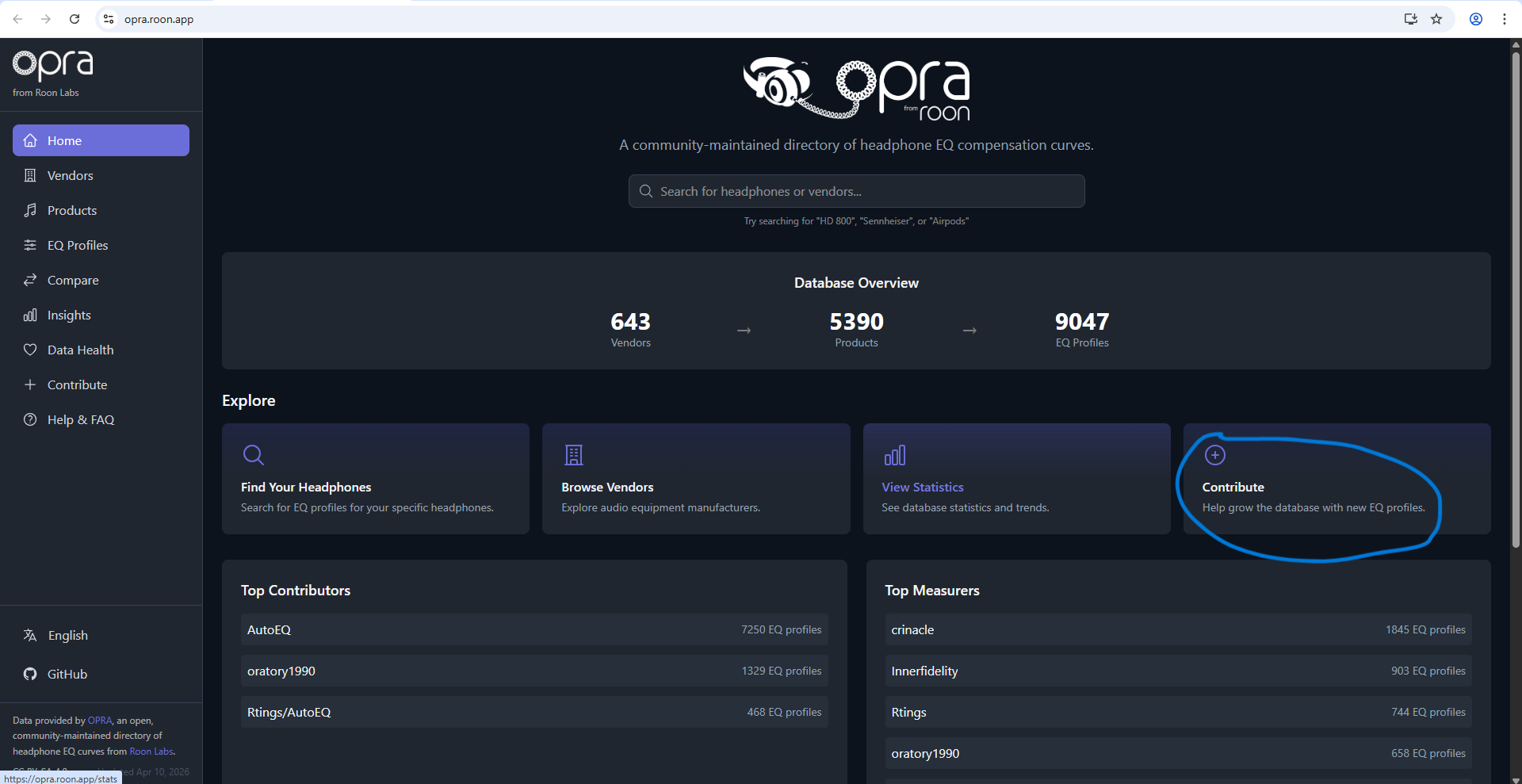

I didn’t realize that we finally announced my “secret” project. I create a web app to explore the eq profiles for OPRA. It will auto-update as the github repo updates. I’d love to have everyone check it out and provide feedback! :slight_smile:

You can add it yourself using the new website.
@Torben If you want to give the contribute feature a try I’d love any feedback.
I don’t have access to that PDF file. Is that a PDF you created or does it was it created by someone like oratory? If it comes from oratory or autoeq it’ll get include automatically.
I’m still working on improving the auto-import on the opra github repo. I need to review the current import still, but it should add a ton of new profiles: Import EQ sources 2026-04-01 by decriptor · Pull Request #75 · opra-project/OPRA · GitHub
Have now added the below:
Austrian Audio The Composer (Suede Earpads).pdf
to:
Now I have to “Wait for review”
Torben

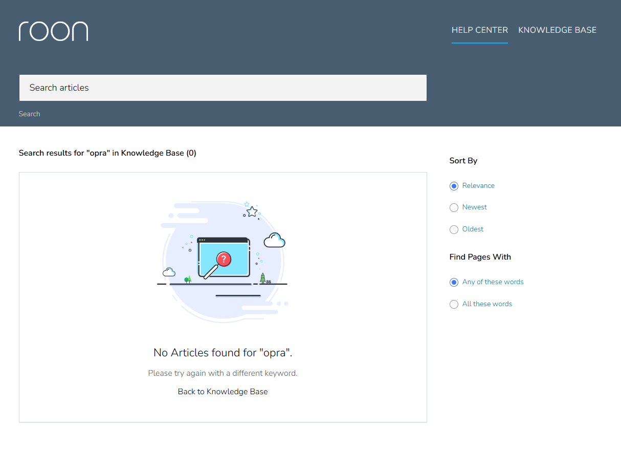

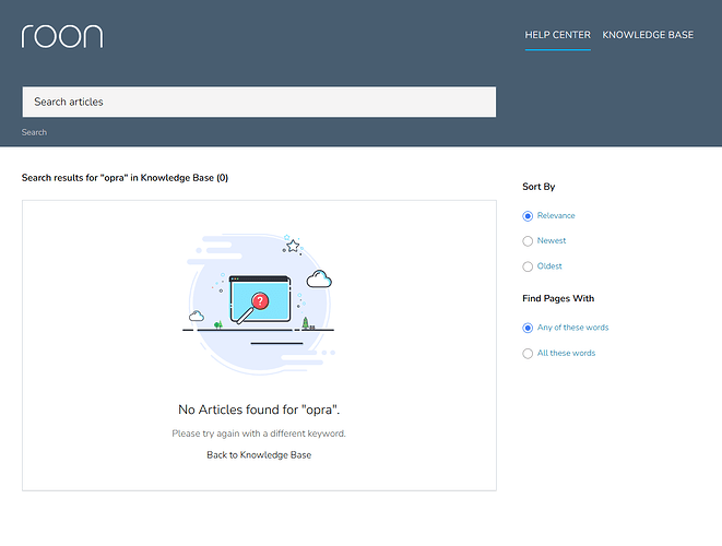

@Stephen - where was this “announced”? There’s nothing about this that I can find on the Roon Labs website - nothing in the Resources section and nothing in the Help articles. Even searching on “Opra” produces zilch results…

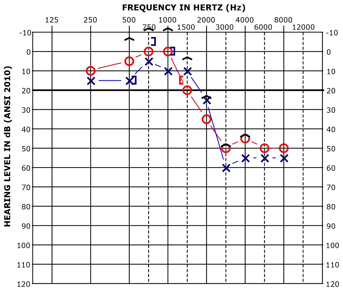

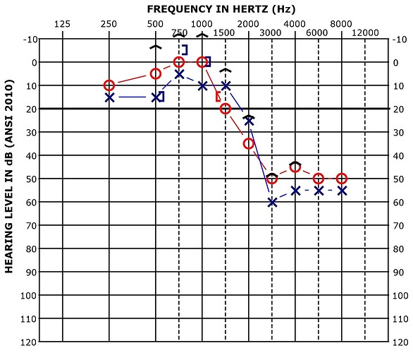

I’m a life-long audiophile, always searching for better sound through speakers, gear, placement, recordings, etc, though it has tailed off a bit. Over the last few years I’ve noticed myself tweaking the equalizer on ROON to boost the treble because something’s just not there anymore - cymbals, high ends of vocals, ambience. Then I noticed I wasn’t catching all the conversation when I was out to dinner with friends.
Long and short - I went in to get my hearing tested. Age-related hearing loss. Here’s a chart of my hearing test. Check out the frequency loss - down 30dB over 2000Hz! And they told me this is fairly typical loss for someone over 65.
What does this have to do with OPRA? The equalizer settings for the earbuds I got last year that I tweaked until they sounded just right would be completely useless to someone else. Imagine how much treble boost I’ve added just to bring the curve up to neurotypical “normal”. This audio test showed me that unless the uploaded eq settings are machine-checked for flat response on each brand of earphone, one person’s eq settings very likely sound like garbage to someone else.
Not a lot.
The EQ in Opra optimizes frequency responses for headphones using a target such as the Harman curve.
It is not used for hearing correction. However, you could apply parametric EQ to boost frequencies (which is what modern hearing aids do.)
