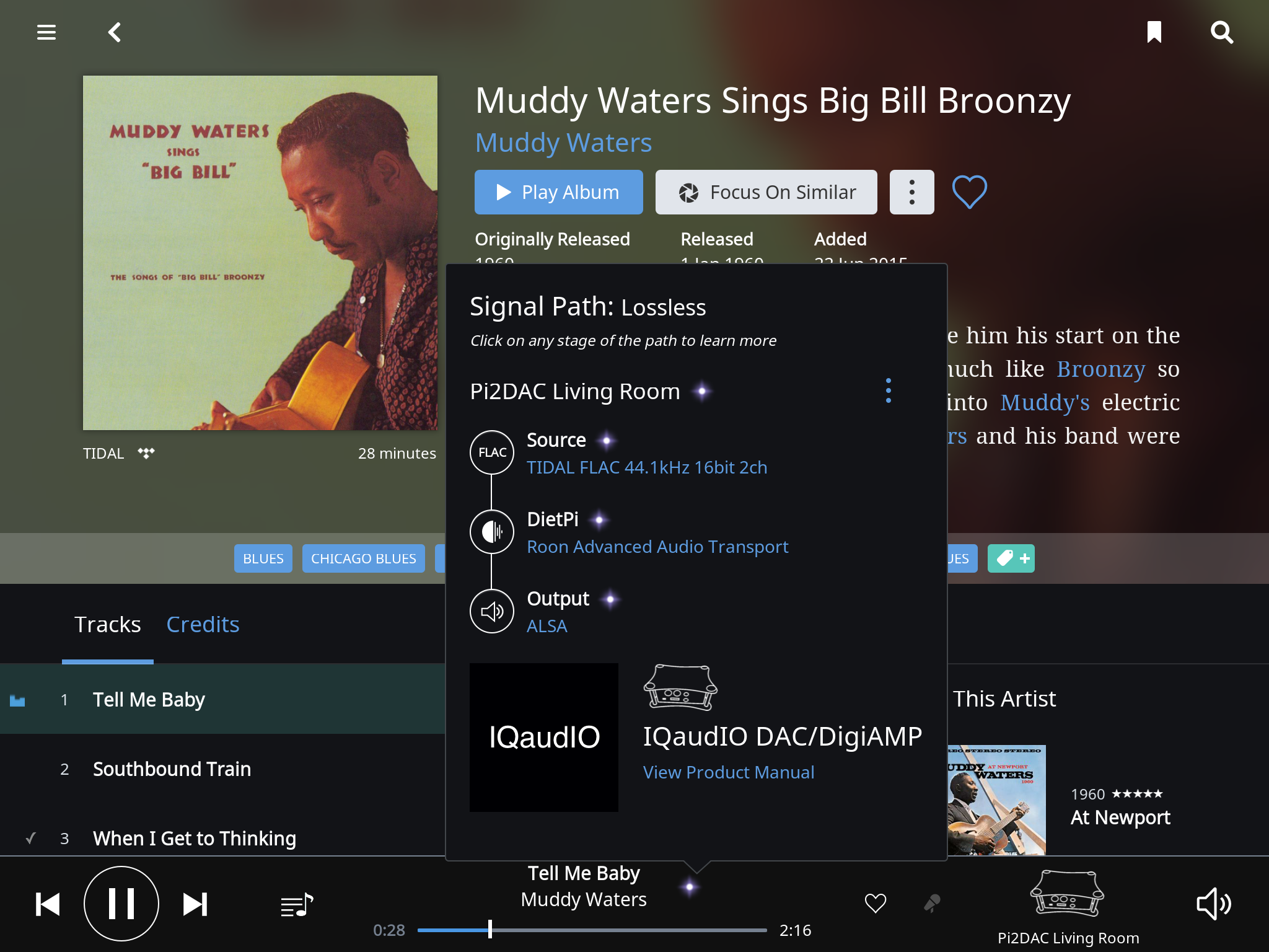

Ah, ok. The best way to tell is to play a Tidal song through Roon and then click the coloured dot next to the song playing at the bottom of the screen. That will bring up the Signal Path. It should say Tidal and Flac.
See mine.
Cheers, Greg
