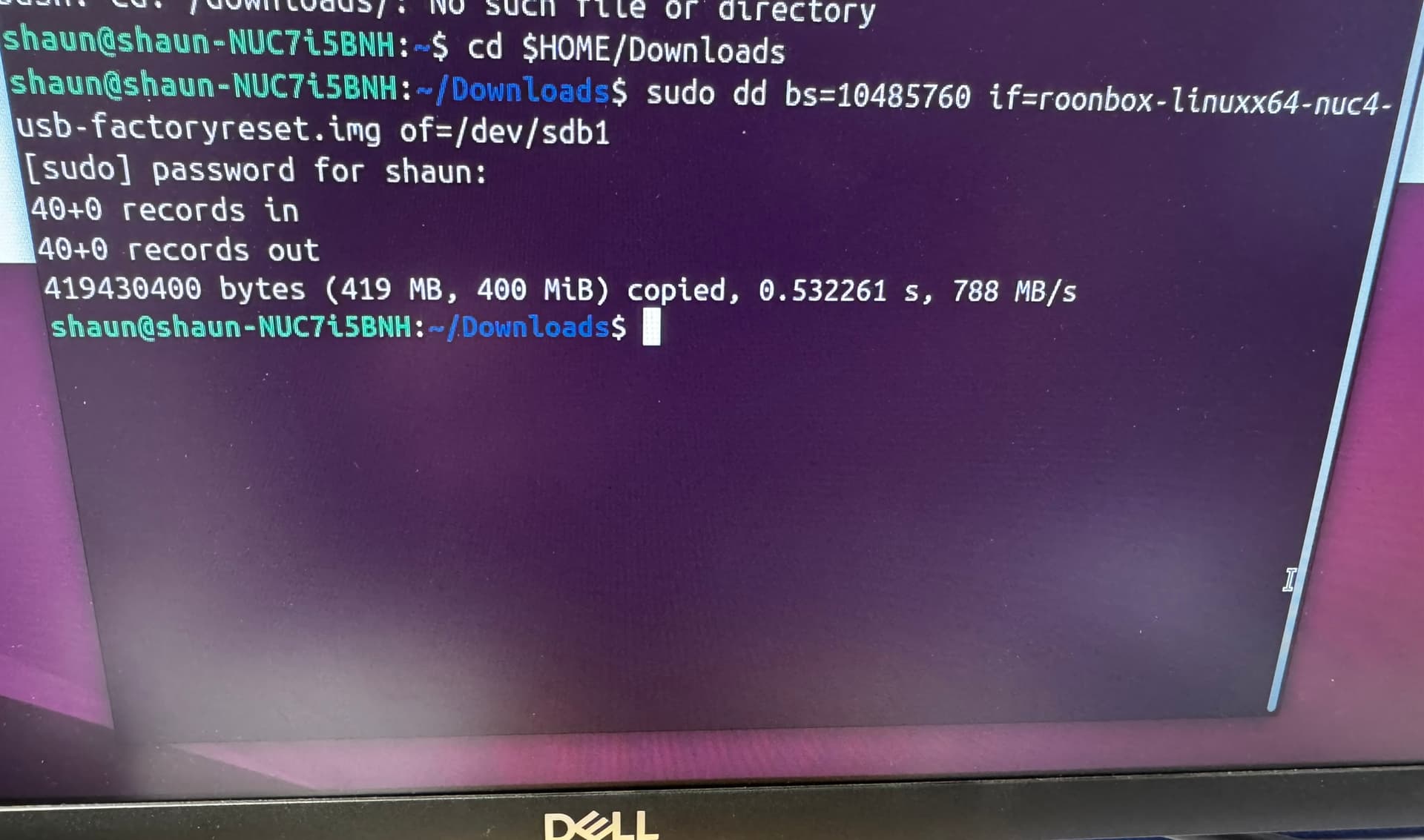

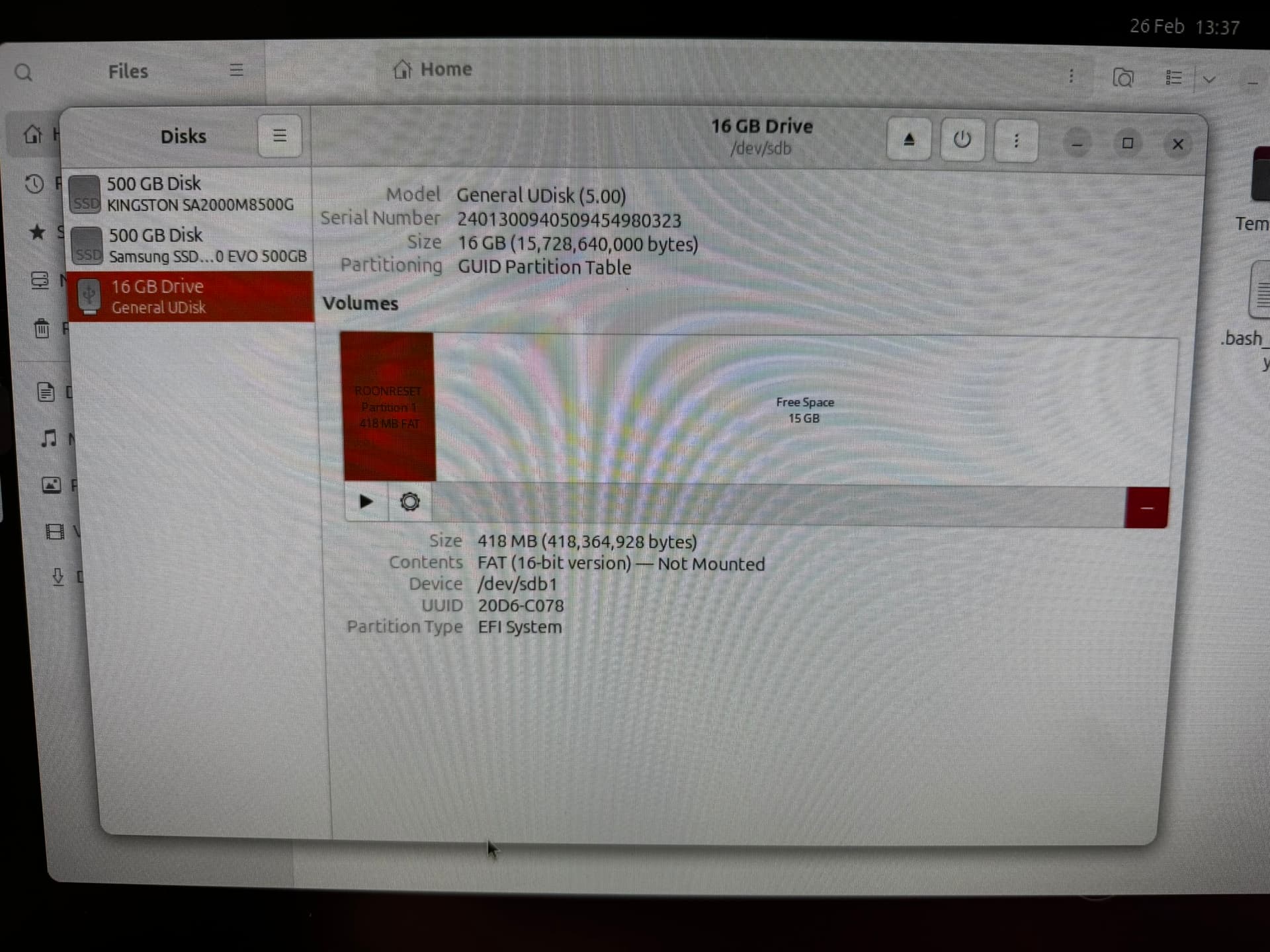

Have followed instructions, see attached images.
When selecting the USB drive i receive a blank screen for maybe 10 secs then NUC boots back into Ubuntu
Thanks for the assistance, determined to crack this.
Unsure if it makes a difference, but its nuc4-usb-factoryreset not nuc3
I think, the USB-Drive might not be bootable because you copied the image into a partition (sdb1) instead onto the device (sdb) as instructed.

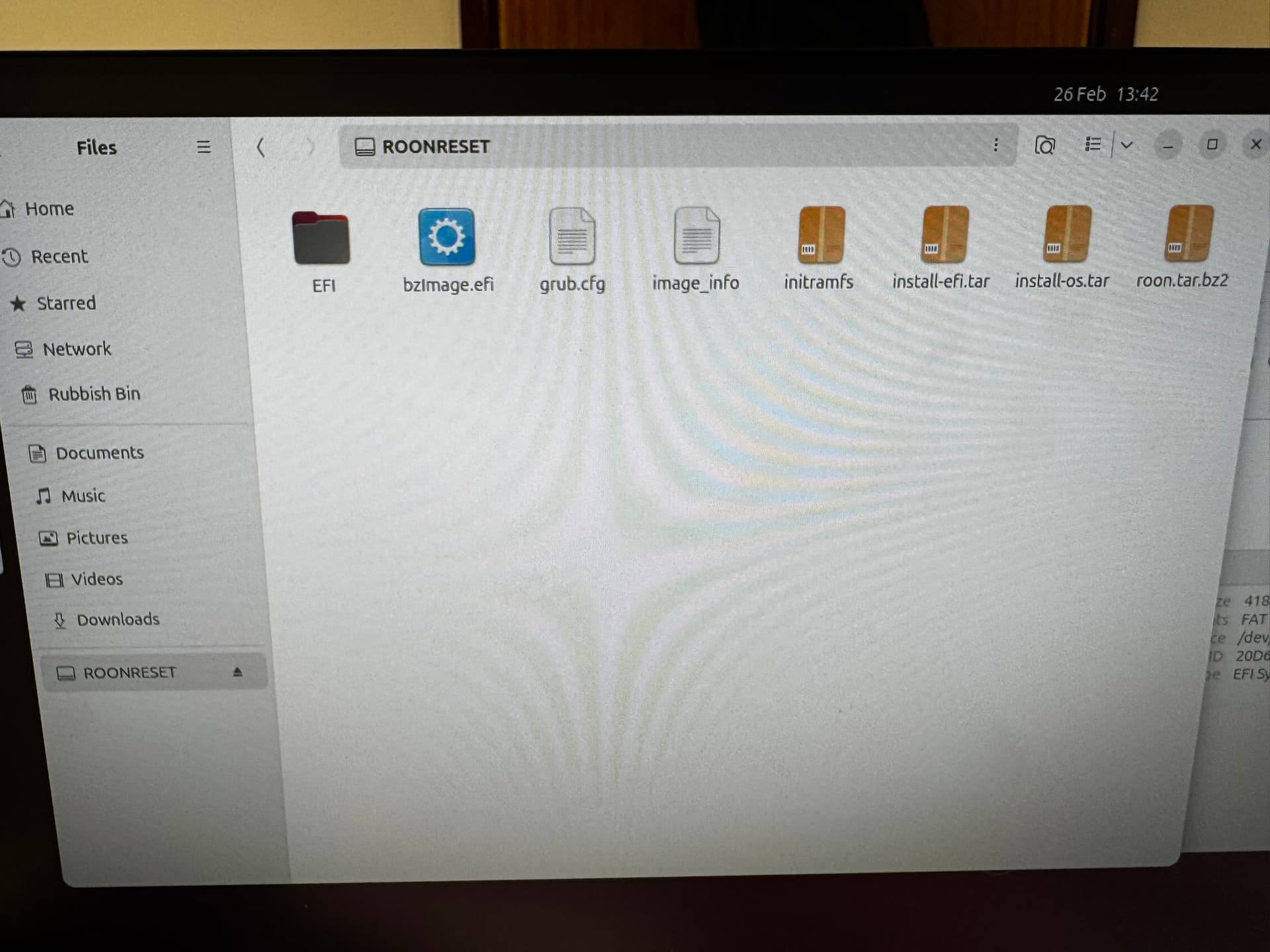

Ok, making small progress thank you.
Now have the USB as shown, and if i mount it i have the files as shown.
But still machine will not boot from it?
This was my understanding, which is why I suggested you use Ubuntu to create the USB pen drive.
No, it was to use the Ubuntu command line to create the USB pen drive correctly.

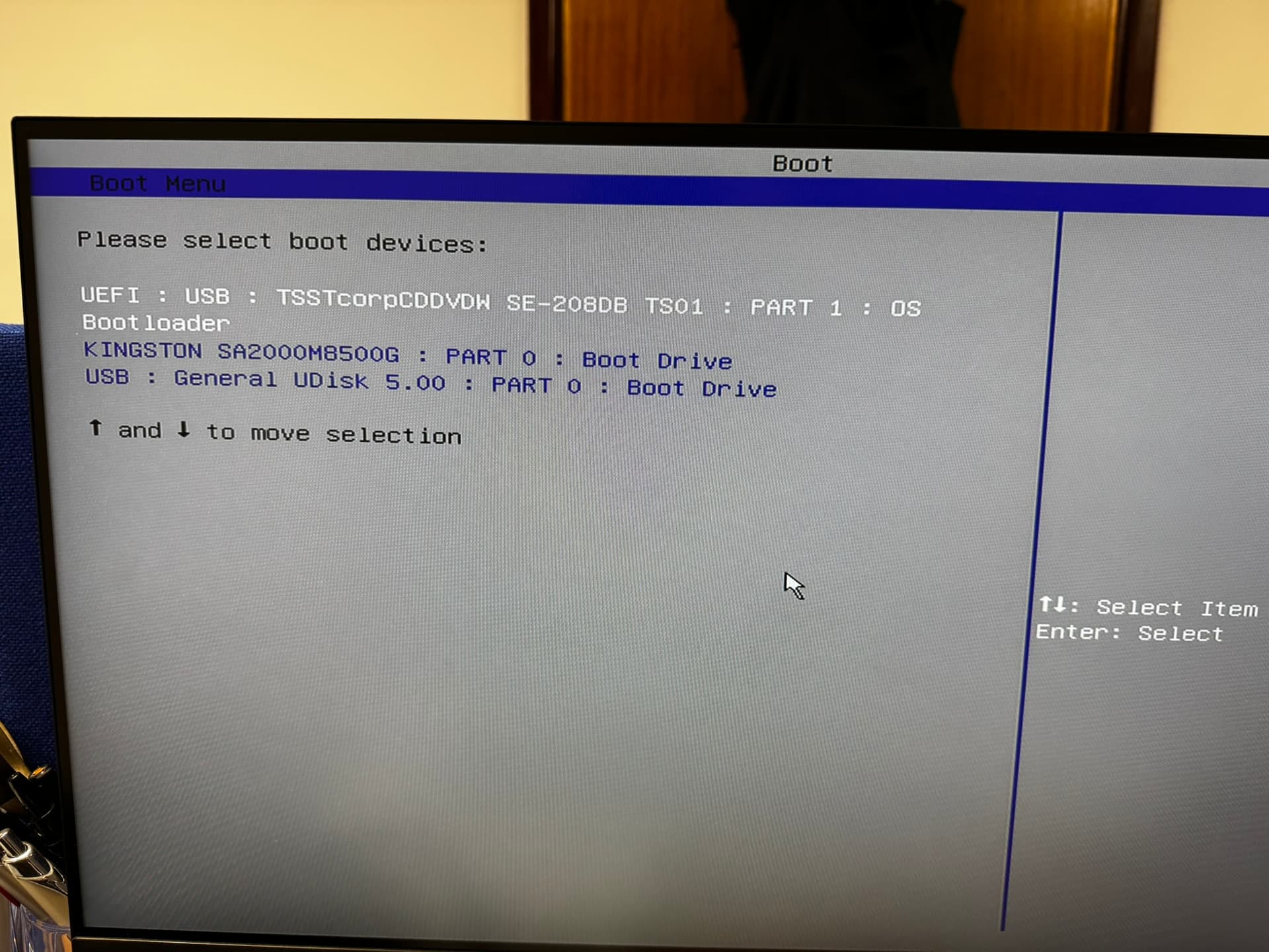

In your BIOS settings, do you have UEFI mode enabled or Legacy mode? Typically when someone tries to install ROCK, they do it to an empty drive, I wonder if the existing Ubuntu install is taking automatic boot priority? If you have another empty drive and could swap the Ubuntu one for it, it may help?
Both are enabled at present, i suspect the problem lies in the UEFI / Legacy area but my knowledge fails me.

Hi @Shaun_White ,
If you try to disable Legacy, does that change anything? Can you share a screenshot of the exact setting?
