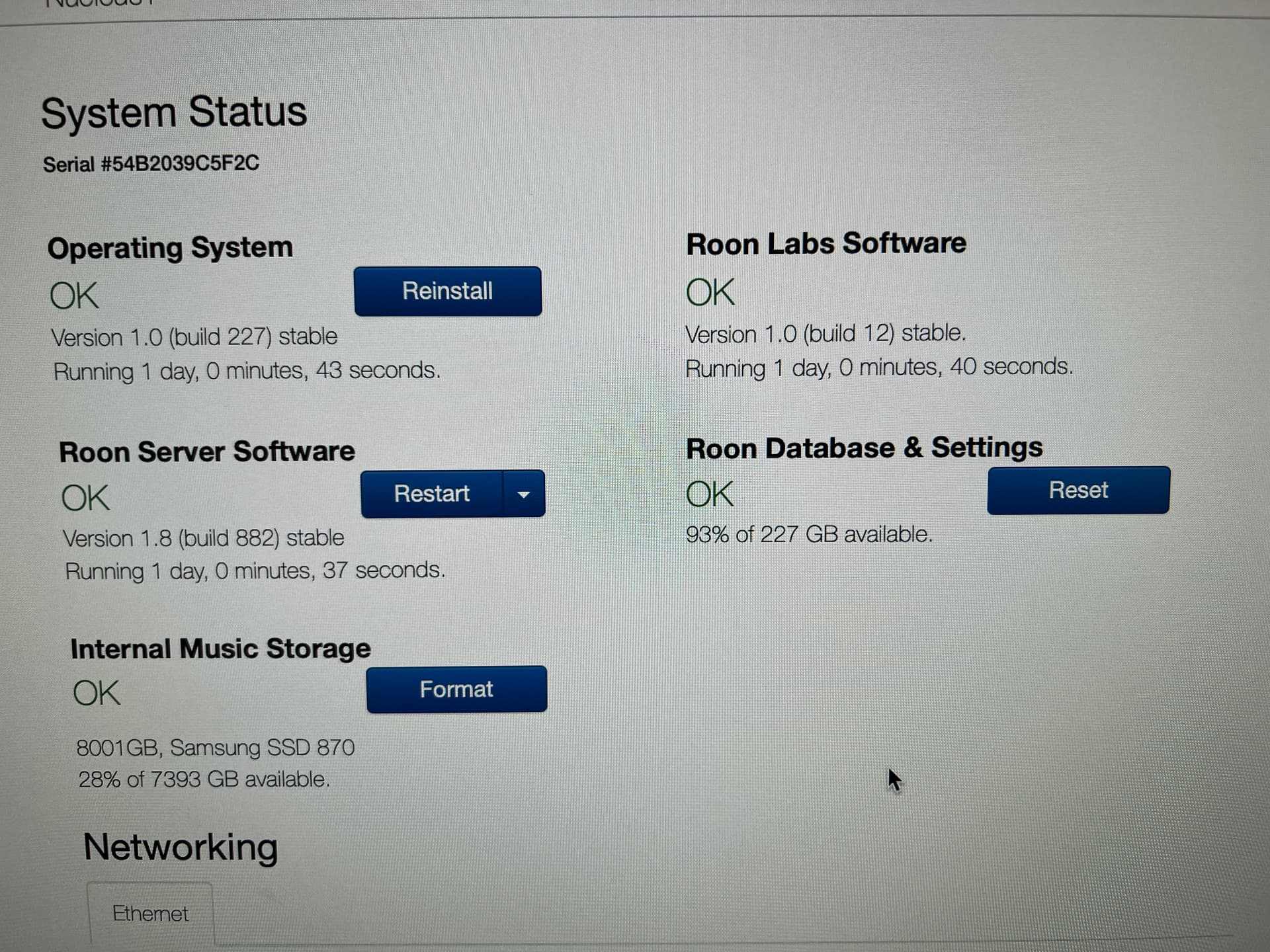

I’ve been a Roon Mac user for 3 years, probably more.
Never once have I had to rebuild and restore the database.
I switched to a Nucleus+ a week ago - and since then I’ve had the database fail 3 times. It’s a large database and takes several hours to restore. It’s just gone again, and I’m minded to just pack the Nucleus back up and take it back to my dealer.
The Nucleus+ has an 8TB SSD in it - and hasn’t suffered a power failure. Network is into an English Electric switch, and then into a Naim ND555 streamer.
I bought the Nucleus+ (At considerable expense over my previous solution of a Large USB HDD on a Mac) thinking it would deliver bullet proof performance and availability. Nope.
I raised a ticket when it failed yesterday - but nobody got back to me. So…… Any ideas?
Before I pack it up - any suggestions? …

This is really useful - the Nucleus+ is on build 882
The database is reporting that is healthy.
