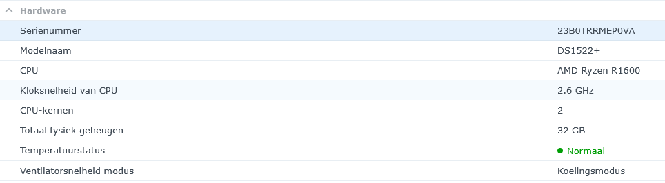

Specs of my NAS are:
Could you please explain how I can make a backup and not have Roon giving the corruption error? I assume copying files to the new machine won’t do the trick.
