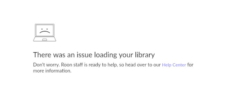

· There was an issue loading your library
· simple one 192.168.0.x , connected to fwa router. everything was working perfectly until 27/4 mind affternoon before the update. Pc running win 11 , 64 bit. library on a usbc drive. i tried to remove, reinstall, delete the roon folders in appsettings and restoring the backups up to 1 month ago from 3 different sources. same backup on a new machine , restored, produces the same result.

Title: Roon 2.65 (build 1653) – Backup restore fails (“Issue loading your library”), works on older versions
Summary:
After updating the Core to Roon 2.65 (build 1653) on April 27, all my backups fail to load with the error:
“There was an issue loading your library”

Roon 2.65 build 1653 fails during library load after restore.
Database opens successfully, account/license succeeds, then fails at:
Warn: CompressedPath exception: System.FormatException:
The input is not a valid hex string as it contains a non-hex character.
Critical: Library.EndMutation: System.NullReferenceException
at Sooloos.CompressedImageUri.ToString()
at Sooloos.Broker.ImageCollection.TryGetBestImage(…)
at Sooloos.Broker.Music.LibraryPerformer._Load(…)
IsLibraryLoadFailed False => True

After "upgrading" to version 2.65, I get the "Unhappy laptop of death screen" saying "There is an issue loading your library". Restarted, no luck. As there is literally nothing I can do within the app then, I tried reinstalling, same error. I then tried installing an older version, however then my library only showed tracks from Tidal. Tried importing the last backup, took maybe half an hour, with absolutely zero improvement. Note the database and server were different versions due to your refusal to provide downloads of older versions of the app.
So now nothing is working. I guess I have the choice to rebuild the database, if I want to wait a week for it to update and then spend another month finding and fixing the thousands of albums it incorrectly or simply doesn't identify. In all honesty, it is just easier to play the CDs, and they sound better too.
