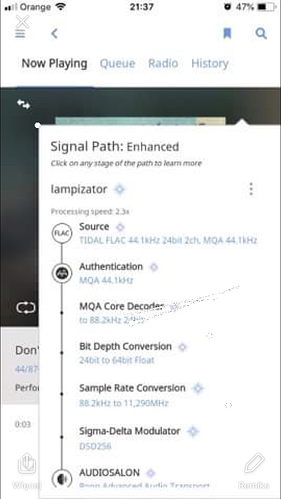

With dsp i have processing speed 2,4. The computer is made only for Roon, all oder proces and drivers are off using Audiophil Optimzer.

Roon from over 2 hours working fine- after reloding you provide. I use this setup with upsampling more than one year. Thanks for Your help, for now problem is solved.
