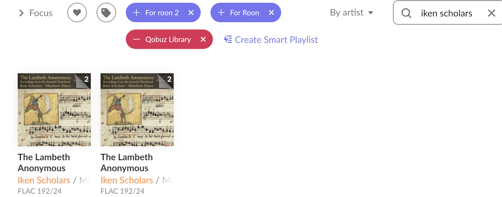

Hi Benjamin. I was possibly responding to the wrong place.
At present in artist view all albums are duplicated.
Screenshot 2026-04-22 at 12.50.06 PM
Hello @Susan_Tyler ,
Thanks for the screenshot. It looks like you have both For roon 2 and For Roon folders selected, do you by any chance, have actual duplicate content in both folders? Is there any change in behavior if you try to update Roon to the latest version and perform a full reboot of the device?
Thanks, but I have seen up to seven duplicates. There is no duplication in the drives. I’ve been through the library checking for duplicates with focus and it is not a problem. I’ve done a power cycle. I’m up to date with Roon software up to now. At the moment it has settled down, but I haven’t done anything to fix it. Last failure was April 26. I’ll write again when it does it again

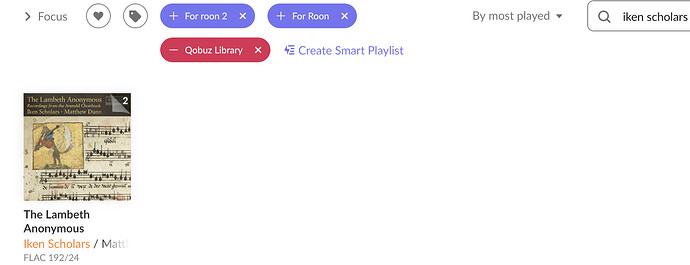

If you select one of the duplicated albums, do all of the duplicates get selected by any chance?
Haven’t tried that. I will when it happens again, hasn’t in several days.
I’m asking because there was or is a known issue where albums (sometimes artists too) become visually duplicated, i.e. the object exists only once but is displayed several times. It’s fixed for a while after a reboot.
Thank you. I think I didn’t want to worry about which one is real since all are only images of something real… I’ve been over the library for duplicates and there is only one album in the library, for a reason, and “hidden”. I have rebooted a number of times and done an overnight rest of the whole system. The duplication is associated with Roon dropping out I think, but not always. I’ll try to keep better track. Maybe it won’t happen again
