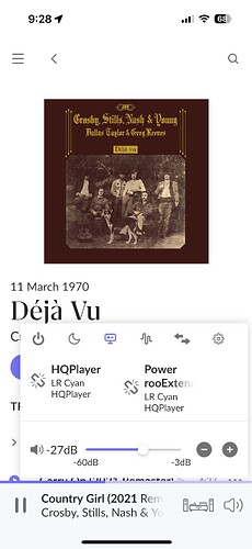

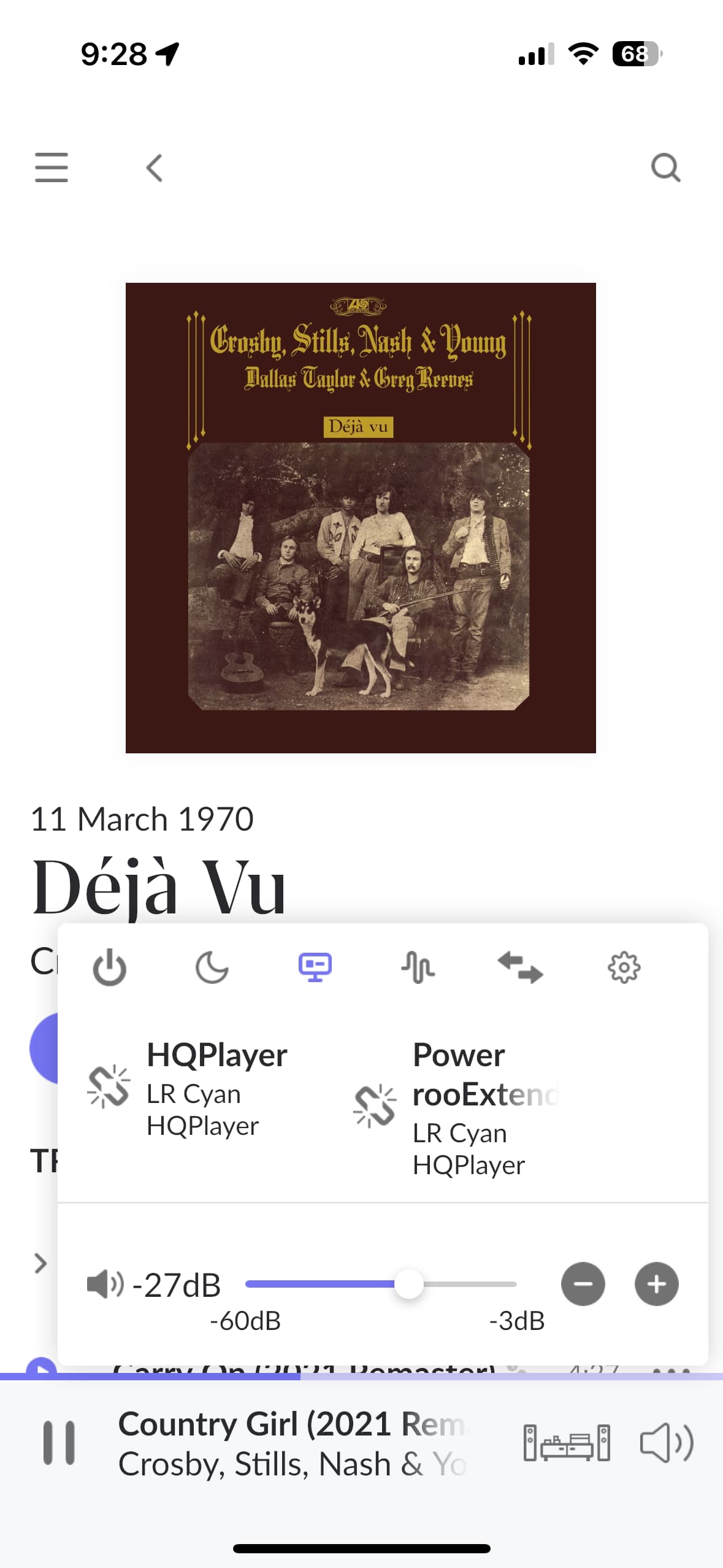

The extraneous “external control” is not a big deal generally - it’s just an “extra icon” that appears that does nothing. The link appears whether there’s a live HQPlayer instance at the address specified in “Settings / Setup / Add HQPlayer” or not. If I add a new HQPlayer zone pointing to some random IP address, then that link icon appears.
None of this is a big deal unless you’re trying to use actual external controls. I can add an external control via RooExtend (or various devices come with them, my example comes from RooExtend / RooControl). I can add the external control, but then instead of the power button appearing appropriately in the zone control with Red or Purple depending on the state, there is a grey one. Underneath it appear two link buttons - the “non-functional HQPlayer break link” and the functional “RooExtend power button”. If i click on the RooExtend one, my amplifiers turn off.
None of this would be a huge deal, except I can’t use the “auto standby” feature on the zone - because it depends on there being a single external control.
If I try RooControl with a normal zone/DAC (like my SMSL M500) then everything works perfectly - I get the purple / red power button and it acts exactly like I want it to.
I just want to get rid of the extraneous HQPlayer “break link” button that appears to do nothing, and which the developer of HQPlayer says he knows nothing about.

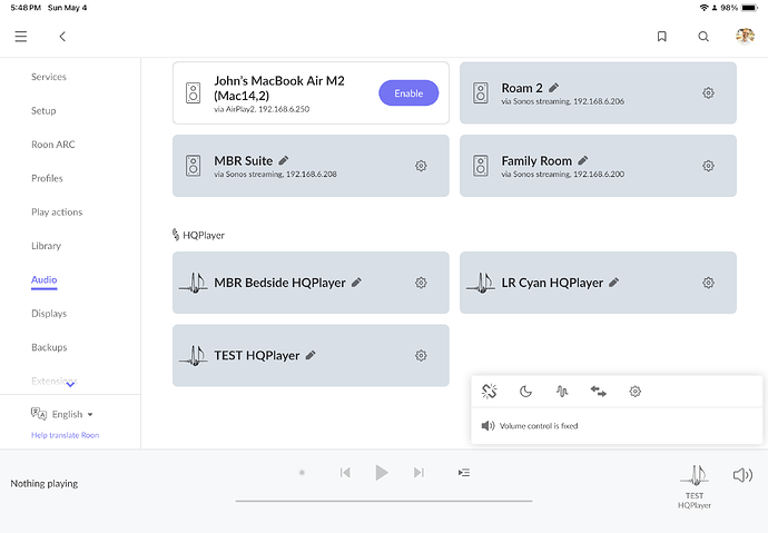

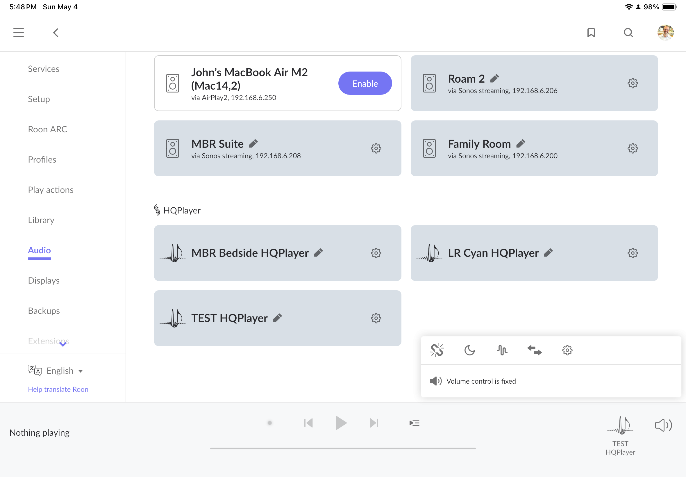

Added a “test HQPlayer zone” from Settings/Setup/Add HQPlayer. Pointed it to the IP address of my NAS (which definitely doesn’t have an HQ Player or anything Roon related on it). Sure enough, once I named it, I went to the zone and there was the “break link” icon. I clicked that break link icon, nothing happened.
Question - does this “break link” icon appear for others whenever you add an HQPlayer zone? What is clicking it supposed to do? Does clicking it do anything for others?
I should add for clarity that if I then add a correctly configured HQPlayer zone, pointing to a functional HQPlayer desktop instance (and can play music) that there is also / still a broken link icon, that appears to do nothing. I think that’s clear from above - I’m just trying to explain that it seems to be part of the “create hqplayer zone” code, regardless of what is on the other end.

Hi @noris Yes, if I bring up a brand new HQPlayer zone (whether connected to a live HQPlayer instance or not) the broken link appears no matter what. If I add rooControl’s external control then I have two broken links. And if I then subsequently remove rooControl’s external control, then I just have the one broken link that I originally had.

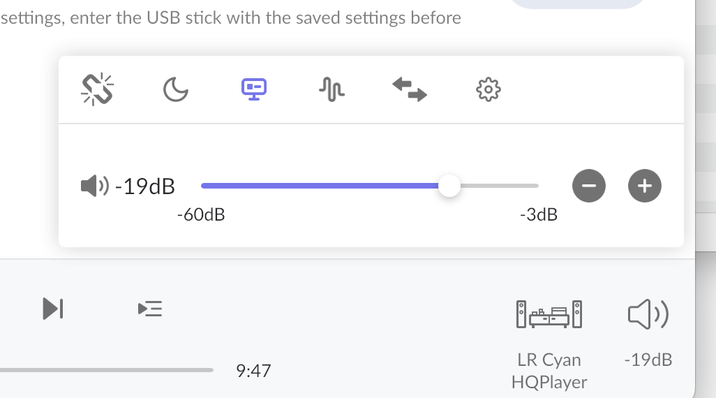

Yes that broken link is there for me. It doesn’t bother me really since I don’t use Roon with HQPlayer much, I prefer to run HQPlayer’s client or desktop.
