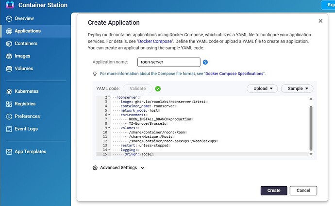

I followed the procedure described on the page https://help.roonlabs.com/portal/en/kb/articles/installing-roonserver-on-qnap-with-docker to the letter.

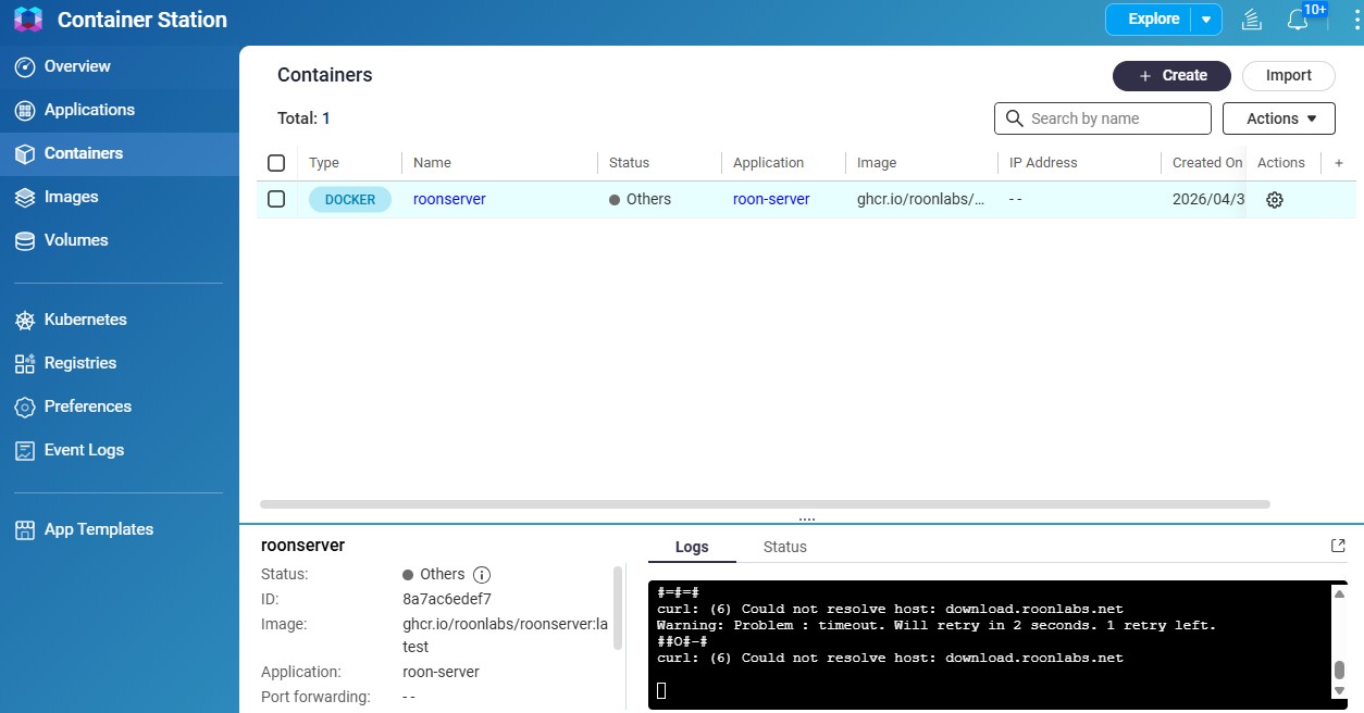

But it isn’t working. It seems that the image is not downloading correctly, and therefore RoonServer has not been installed: when I create the application in Container Station (after validating the YAML code pasted from the Docker Compose file copied from the generator), the download window appears only for a split second, and the download seems to fail.
Afterwards, the container status does not show as ‘running’, but as ‘others’.
Is there something I’m not doing correctly?

Problem solved: I first had to remove the RoonServer app from the App Centre, and then restart the NAS. Now the RoonServer image is successfully installed in Container Station, and Roon is working again.
