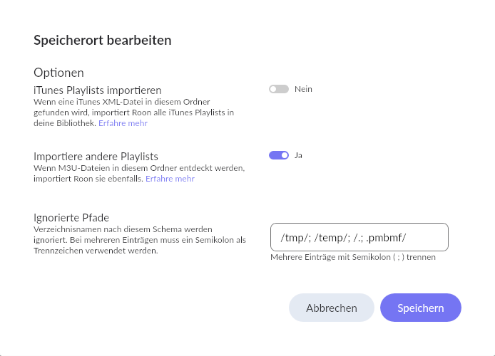

I have now restored my old Macmini Roon server from a backup and taken screenshots of the storage folder (see pictures).
I can edit and relink the Macmini path, but not the predefined storage location of Rock (Roon Optimized Core Kit Internal Storage). I can only deactivate this. However, it would be great if I could use this for my library.
ROCK Storage (cannot be relinked):
My old library path on the Macmini (re-linkable):
Many thanks for the support.

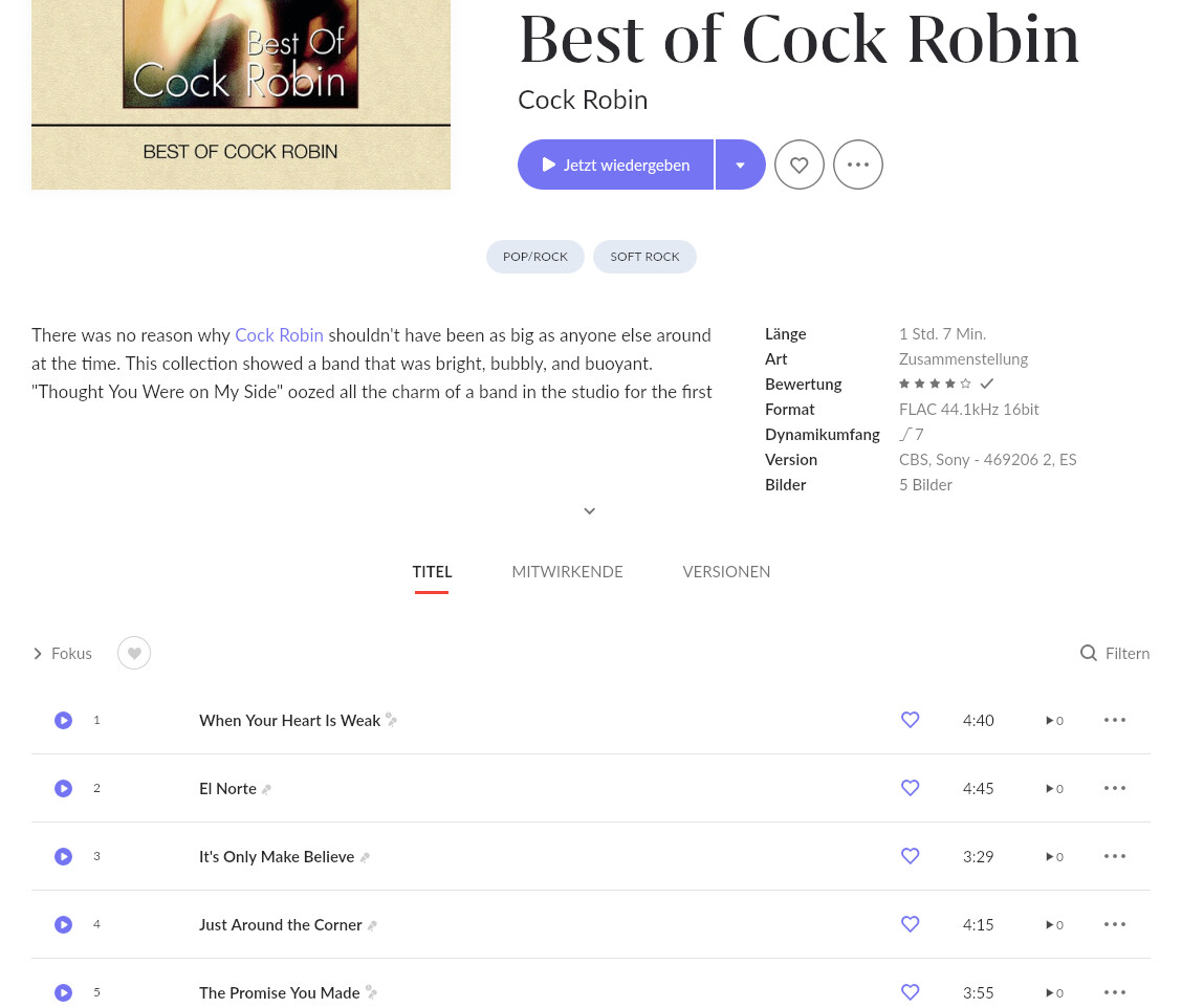

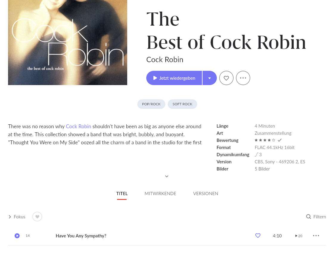

For example, Chicago’s album “The Heart of Chicago” is now available twice and obviously different covers were used. Cock Robin’s album, “The Best of”, is also included twice and different covers were used. My original favorite is the cover on the right. The Dire Straits album “Communiqué” suddenly contains two albums with different covers. There are many more examples.
In the following example you can see that an album only has one track while the other tracks are in the other album, even though all tracks belong to the same album:

This looks like this to me:
The top cover is the wrong one and the bottom one is the right one.

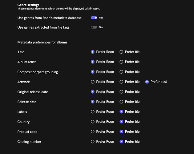

Since the correct album art is showing on the second entry we know the album cover is properly associated in your library. Under your import settings make sure you have Artwork set to prefer file.
