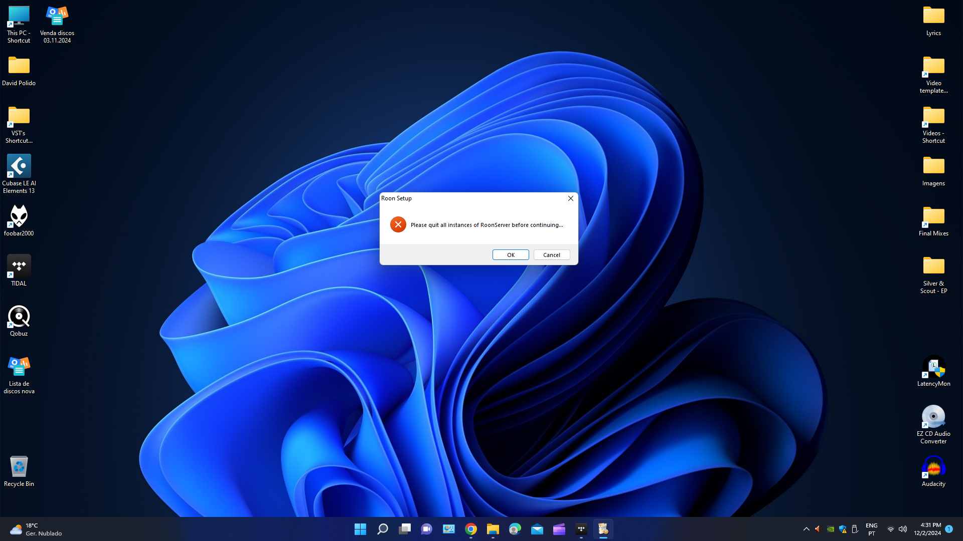

Hi. I am coming back to Roon, so I downloaded the software. When trying to install I get the message to "quit all instances of RoonServer before continuing...", but I don't have any Roon installed yet. How can I solve this issue?
Thank you
PC running Windows 11 w/ a i5 3rd generation core, with 64 gb ram

Hi, all and thank you for your help. However, I cannot even install roon. As I said, I downloaded the Roon Installer.exe but at the moment I double clic to install, I got a small window stating : “quit all instances of RoonServer before continuing…”, and I have no means to install it. I run all files on my PC to check if there was any Roon related stuff but there’s nothing. I tried the solution given by @Rugby but nothing shows up. I’ll try again and will let you have the outcome.
