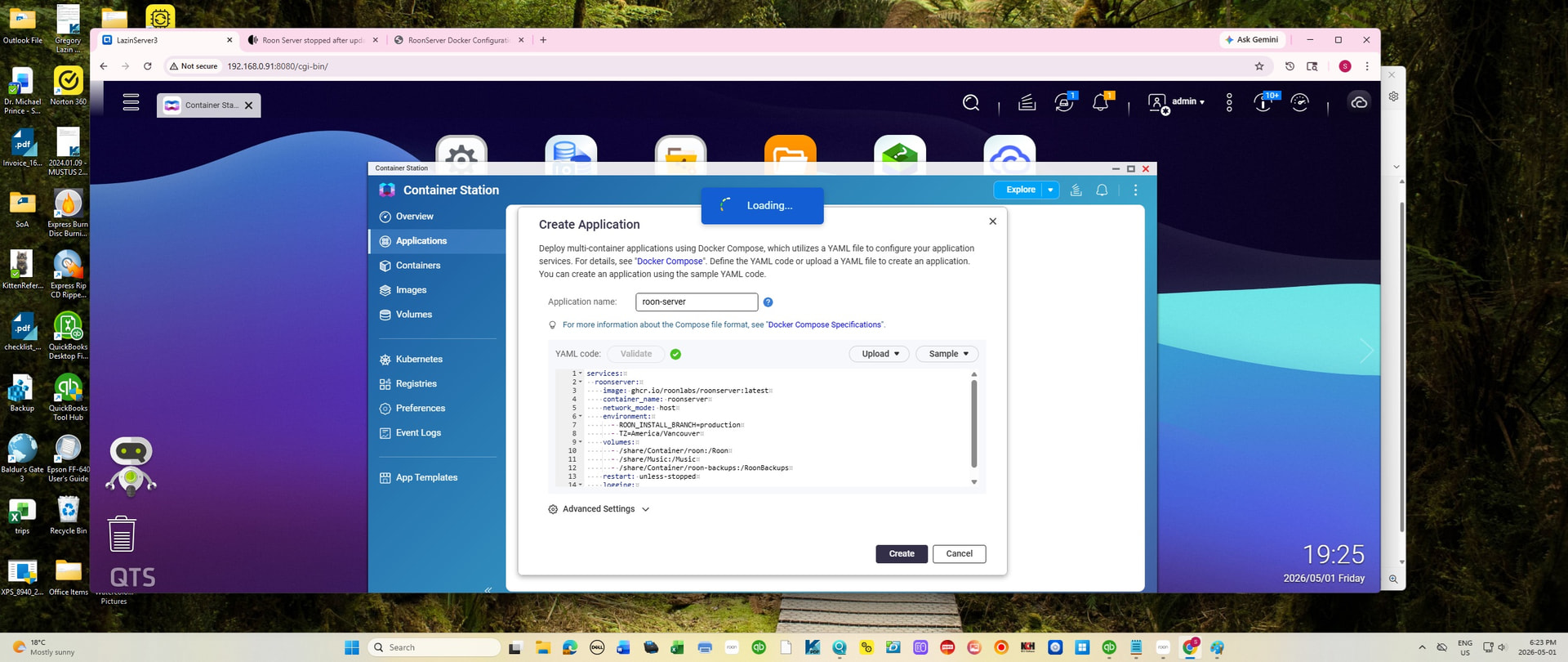

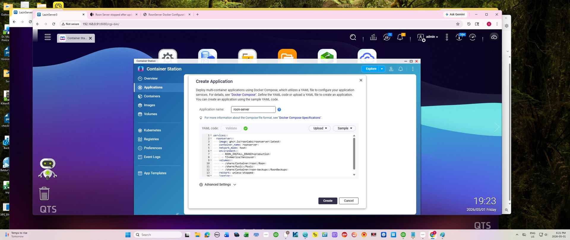

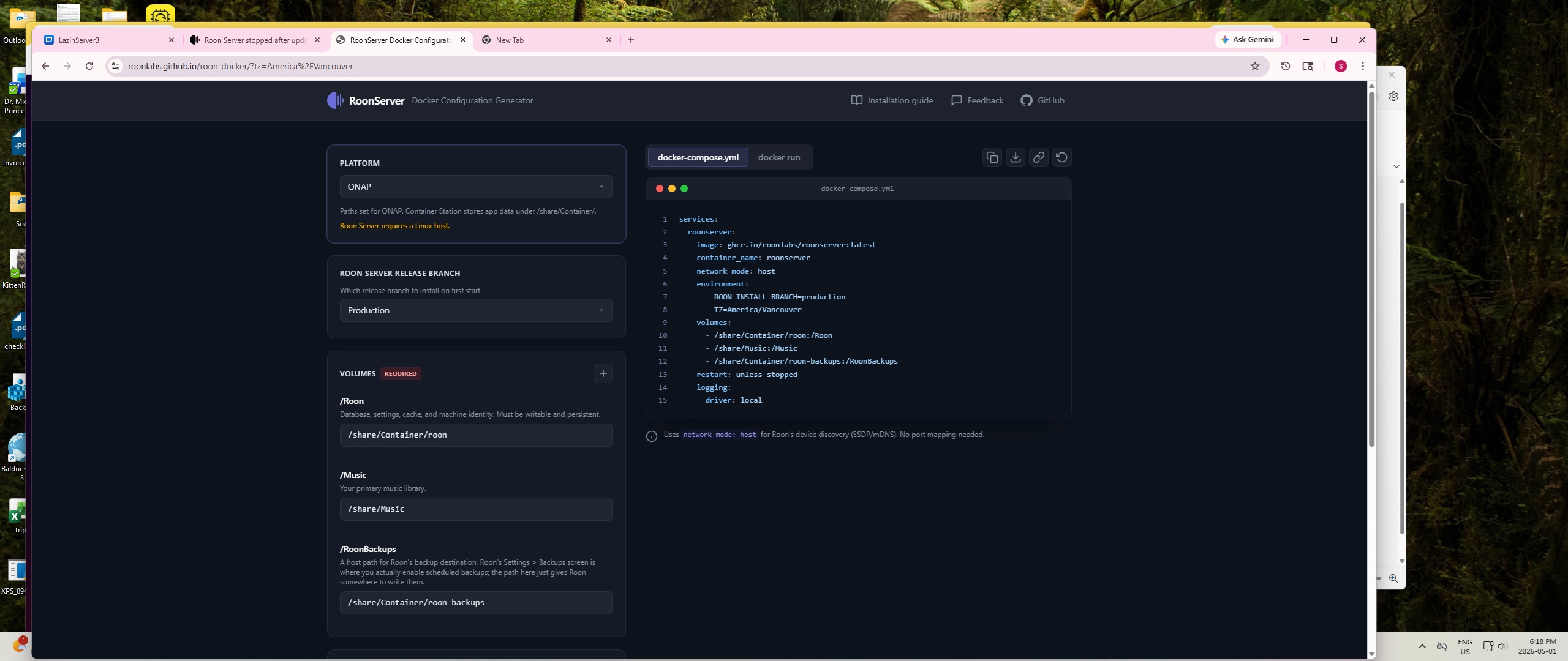

· I am another of those users with problems using a QNAP server. I have rebooted. I have downloaded Container Station. I have tried to create a new application. I have installed the script. I have validated ir and got a green checkmark. Then I get a "loading" screen that doesn't load, and then I get kicked out. Help!!!!

Thanks for the details, and for outlining what you have already tried on the QNAP side. Please share a few screenshots of the issue, including the loading screen and the point where you get kicked out:
3 screenshots
<I have not included the screen where it stops loading and cancels the process…

I have removed the old roon server from my qnap. It is not hanging at the poiny of selecting a new server. It is hanging on the verified image I am trying to load into Container Station. Please see above photos.
