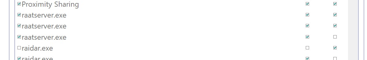

Two other existing zones (MSB Renderer Mk2, and Anthem 540, both on same network) still work. And I can find the BACCH on a network map (actually two network maps). I've gone into Windows Firewall on the PC and allowed both raatserver.exe and Roon.exe through - but as the actual server is on the Synology NAS, perhaps the problem is there?
