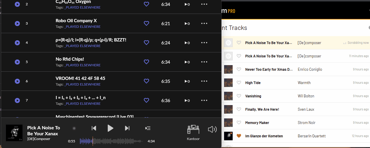

I’ve added a recording. You see that I pause at 0:43 mark, wait for a few seconds and resume play.
After the next track begins to play, the previous track is not scrobbled.
Animation

Thanks for the video and additional details. We’re having trouble enabling diagnostic mode for your Roon Server to take a closer look, could you please use the directions found here and send over a set of logs to our File Uploader? Once logs have been uploaded, please let us know so that we can check the server for your files, thanks!
