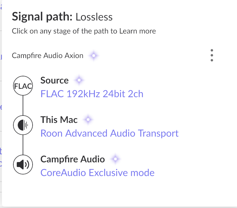

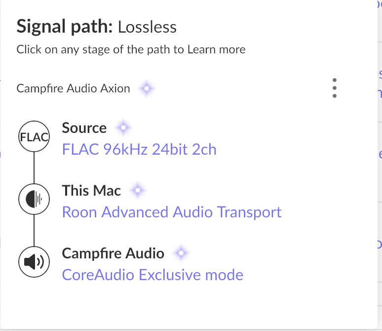

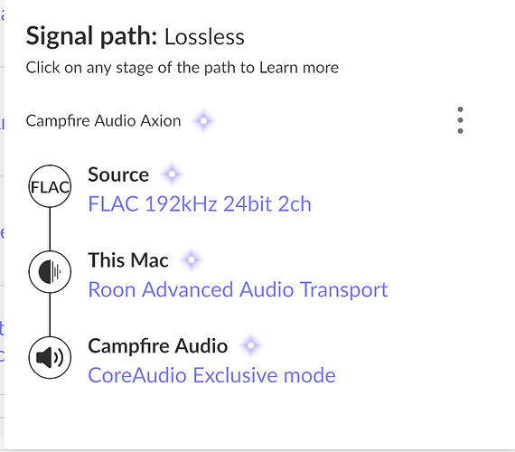

I plugged the Axion directly into the USB port on my Mac Mini where I do run Roon Desktop App. Configured the DAC in the midi setup of Mac OS and Roon is playing highres files 96kHz or 192kHz without any conversion. So the Axion works like a charm as it should. Which means it is not a cable issue, not an issue of the DAC inside the Axion.

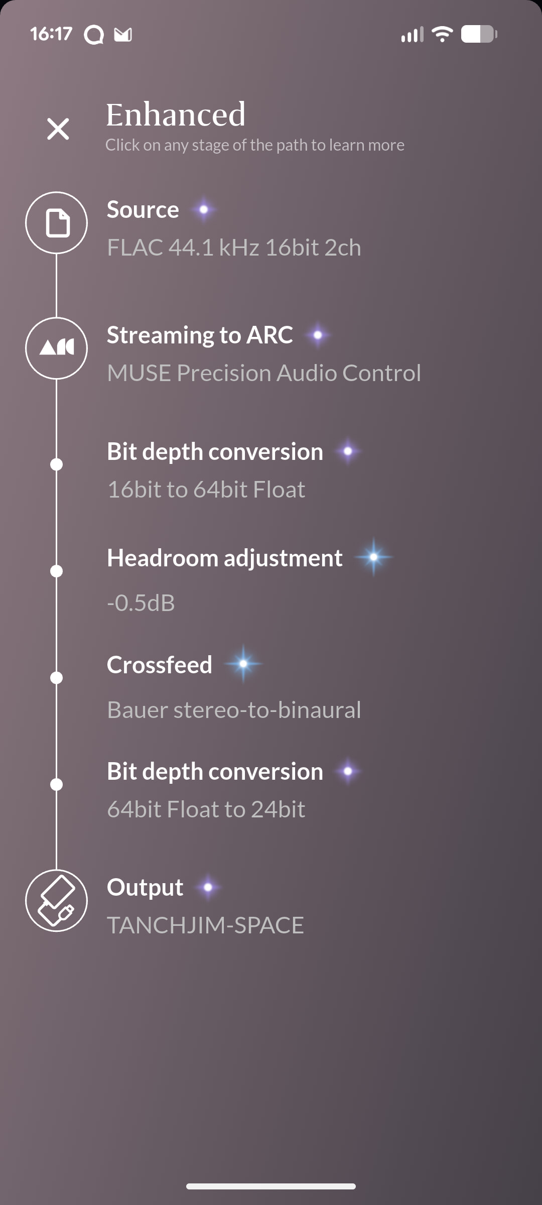

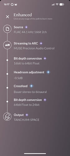

In my experience, this needs to be done when selecting the beta driver and when connecting the DAC. For instance, when connecting my TANCHJIM Space just now, I had no volume control and gain until I restarted my Pixel 7 (Android 16.)

The Campfire Audio Axion including the DAC works on the Mac?
