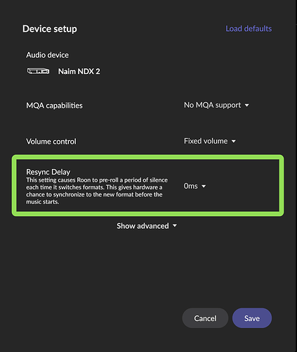

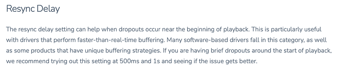

Some DACs need a little time when switching resolutions. In Roon, you can apply a “resync delay” to give them that time.
(From: https://help.roonlabs.com/portal/en/kb/articles/troubleshooting-audio-dropouts#Resync_Delay)
Go to the device setup screen and adjust it there:
Yes, I know and I already did that. I have set delay up to 5000ms! but with no luck.
You didn’t say that you know and tried that …
