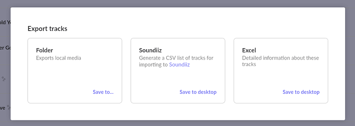

You should read this Help article that explains how Soundiiz is used with Roon…
And I think you have misinterpreted what @mjw was saying about the two-way synchronisation that Roon has with Tidal (and Qobuz and KKBOX)
thanks Geoff! I hadn’t seen that.
this solution is like going back to live in 2007 though.
do you think this feature (instant sync) will ever come on roon?
As @Geoff_Coupe has explained, you need to export the playlist from Roon first …

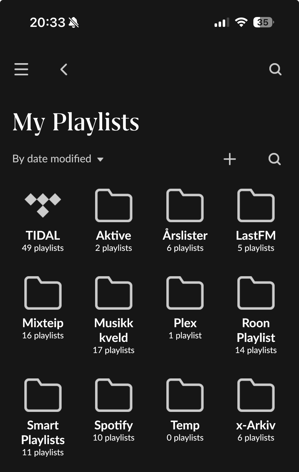

But I also dj, and need all that finds and playlists yo be alive in Tidal too.
That is possible (if I understand your need correct).
In Roon just save any playlist under Tidal (not in Roon playlist folders) and you can edit two ways - I.e edits in Tidal is replicated in Roon and vice versa.
Mr, Moonshiner. you just made my life beautiful again. thank you sir!
