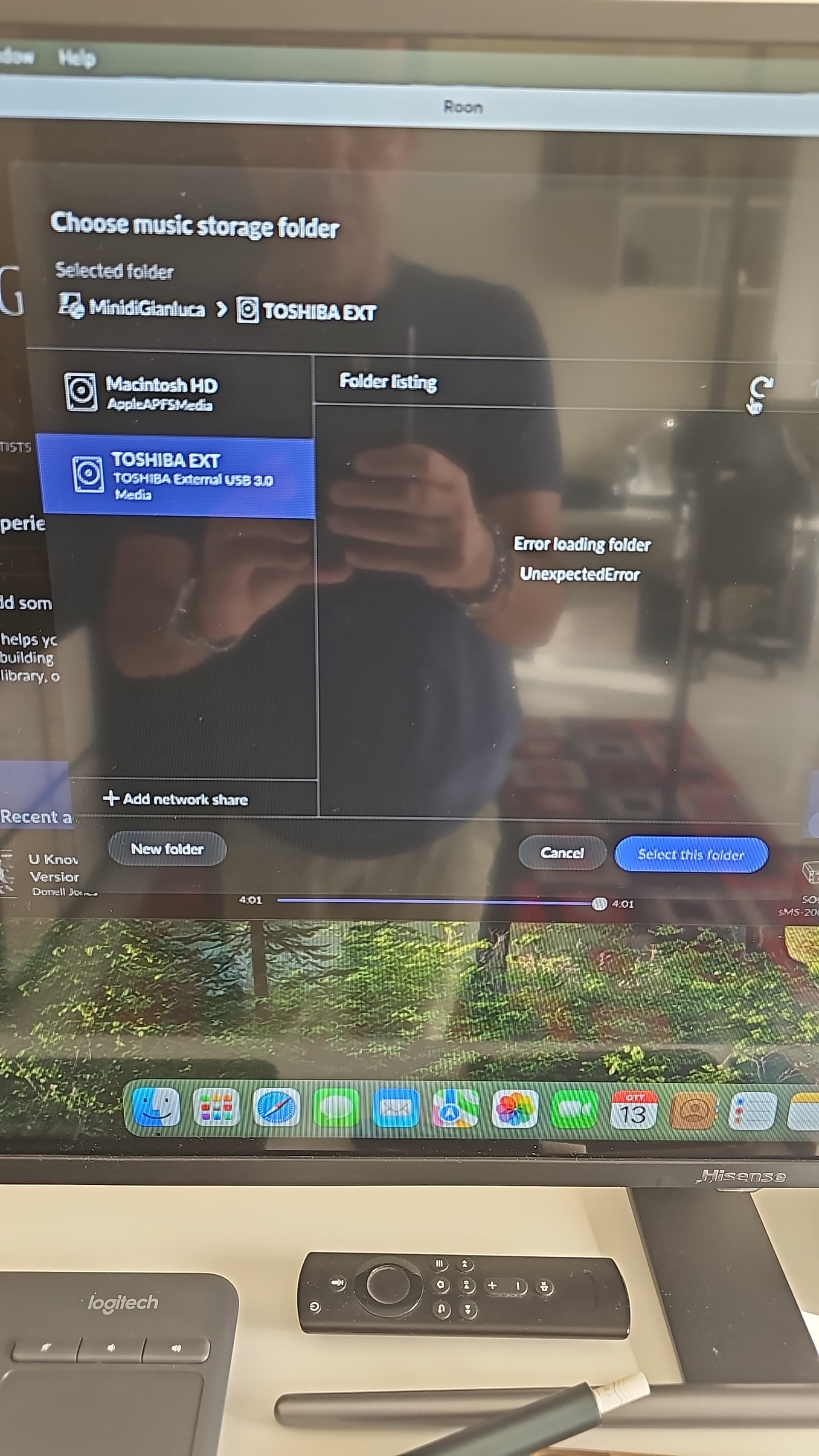

Hi there. After updating the Mac Mini M1 os I have great problems to recognise the external HDD connected to the Mac. Roon shows me that “this directory appears to be empty. Add some files or edit this folder if it’s been moved”. What could I do? Thanks

Nothing…I tried also to reinstall the software but it’s impossible to recognize the external HDD
If you access the HDD in Finder are you able to see the files where you expect them to be? If not try checking out the HDD in Disk Utility.
Yes. I see the hdd through Finder and all its contents. The Mac see the hdd normally

Can you please confirm how the hard drive is formatted? Is it using NTFS? Are you able to try plugging in another USB drive in and check to see if that shows up properly in Roon?
It’s formatted in NTFS but no issues with the previous OS. Yes, I checked with a usb pen drive and it’s ok also formatted in NTFS, Roon sees the usb pen drive

No, but the problem is solved. Seems that new OS Sequoia doesn’t digest well NTFS old partitions. Although the system sees the HDD, it has no interaction with Roon. This is a strange problem, but once I reformatted the disk with exFAT and copied all the files onto the HDD, everything went back to normal
