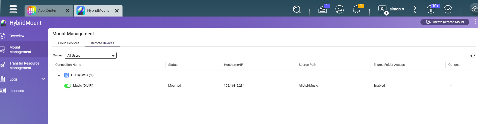

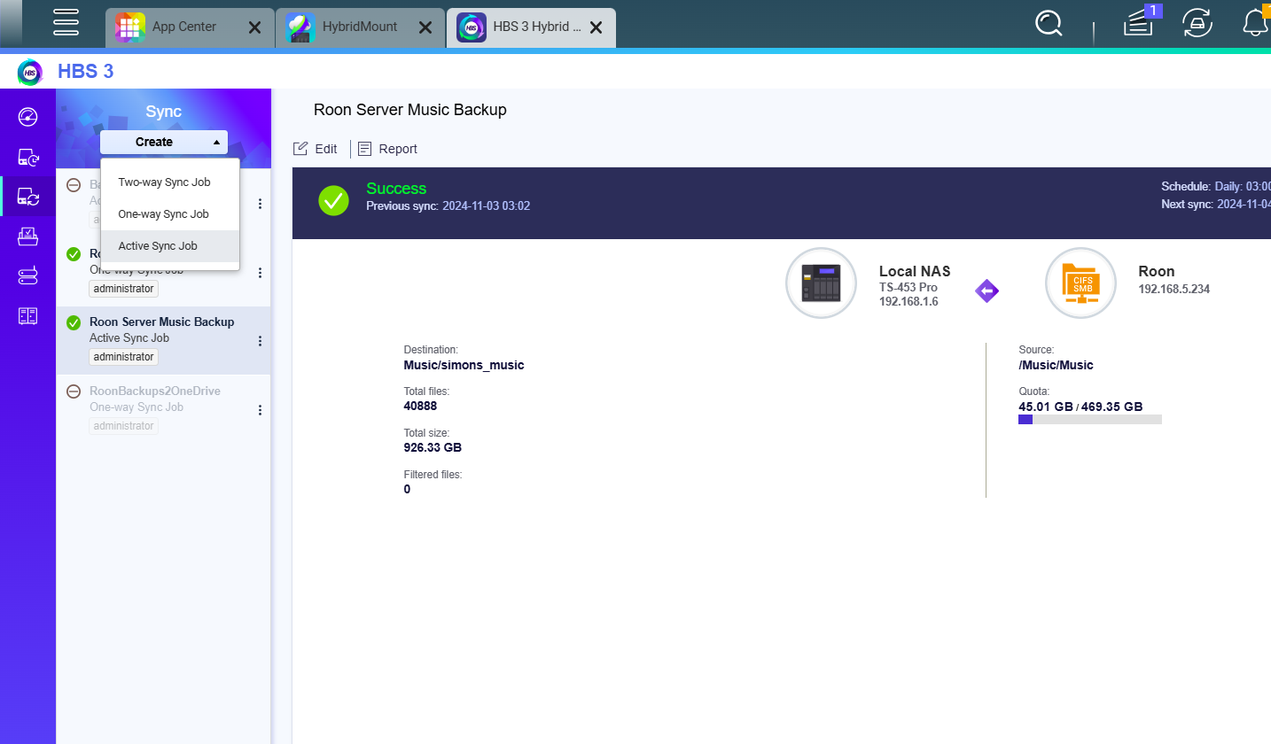

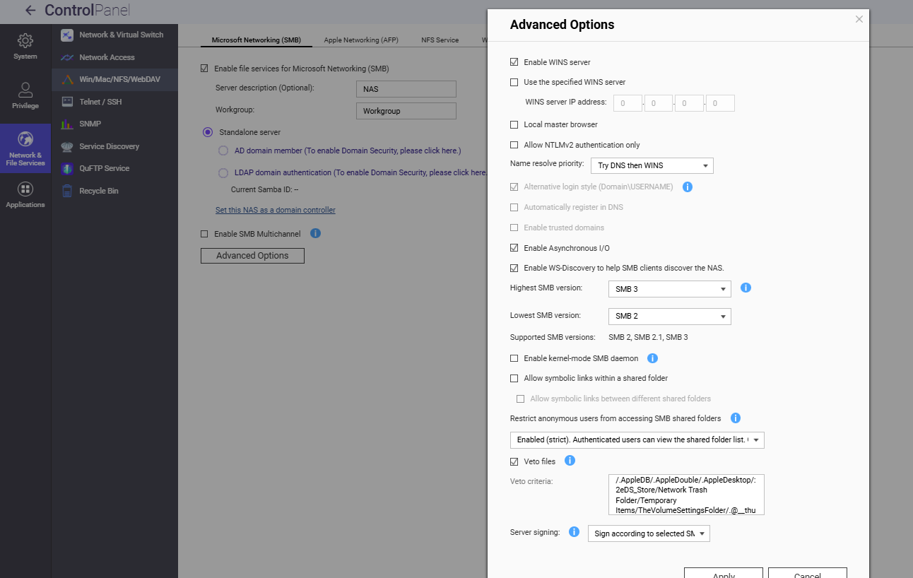

You have to add it as specific job type and can mount the drive using hybrid mount under remote devices. I use dietpi now not ROCK but same process was used for ROCK. You will need to make sure you enable SMB v2 support on the QNAP as its v3 by default if I remember correctly.
Then create an active sync job to do the back up.
