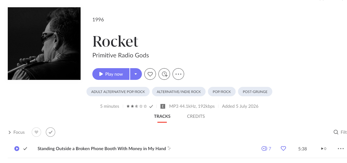

Pictured here is the Primitive Radio Gods album "Rocket", which I picked because I wanted an album I didn't have complete in my library (I think there's only one good song on the whole album and it's their one hit, which is what I have from them here). "Rocket" is available on Qobuz, but it is separately listed from my version of "Rocket" for I assume some metadata reason or another. When I go to Edit > Album Options > Identify Album and correctly ID my "Standing Outside..." MP3 as being from the "Rocket" album, the end result gives me this placeholder image instead of the cover and only my MP3 is available to be chosen. When I go back to the Primitive Radio Gods' page, I only see that version of "Rocket". The Q for Qobuz is visible, but that version of the album is gone. In the screenshot, the versions tab is also gone.
I can undo this no problem by going back into Identify Album and clicking "None of these look right" a couple times, so it's not like this is a permanent change to my Roon library. I can live with the two wholly separate listings of these albums on the discograhy page (one on Qobuz, one in my library), but I was wondering what could be causing this issue I am seeing.

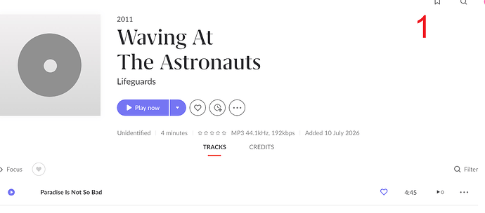

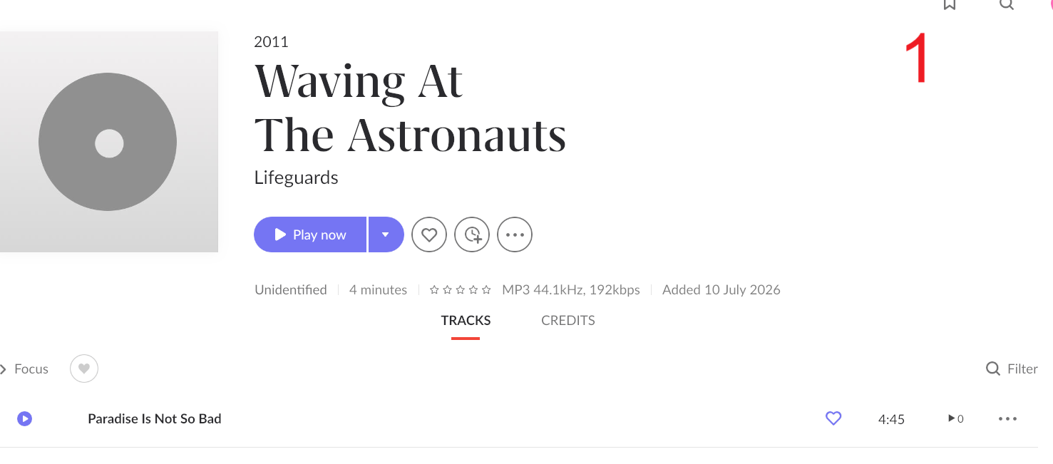

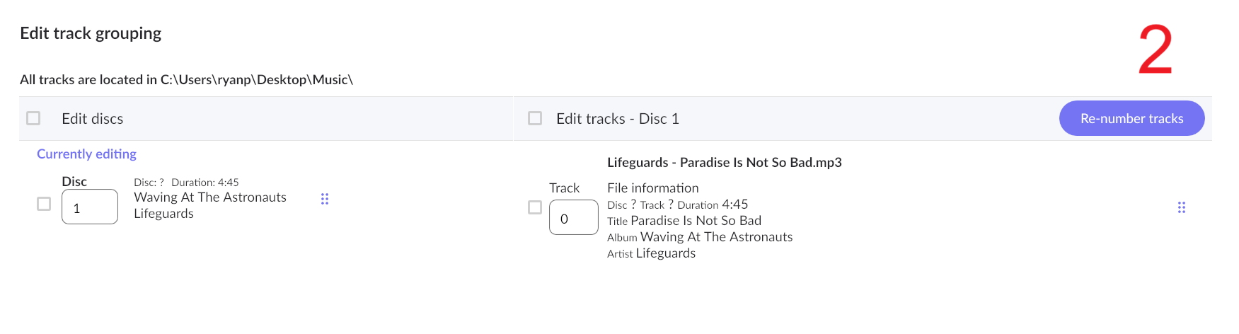

In screenshot 1: You see the Waving at the Astronauts album before any pairing: No album cover, and it is completely separate from the Qobuz copy on Lifeguards’ page.
Screenshot 2: Well here’s the problem in “Fix Track Grouping”. The track number is set to the default 0 (this usually means the track number is blank in the metadata. Sometimes I will have a wrong track number in here too).
Screenshot 3: After checking another source (Wikipedia, RateYourMusic, even Identify Album in Roon), I know that “Paradise is Not So Bad” is track 1 on Waving at the Astronauts, so I correct that in Roon.
Side note: No steps of this affect the actual local file in any way. If I pull up the mp3’s properties on my hard drive at the end of all this, it shows no change to the track number. I don’t really care either way whether it does or not, but it’s worth noting.

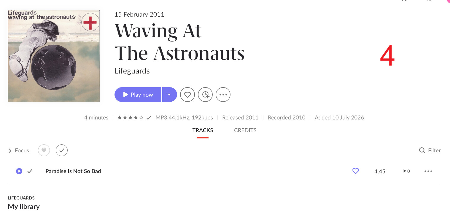

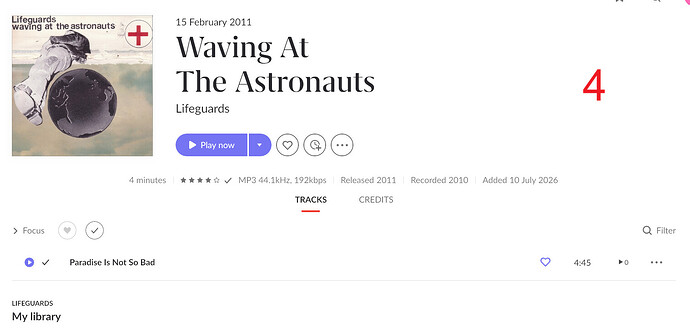

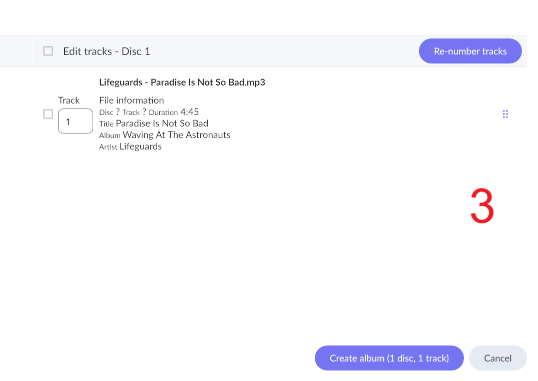

Screenshot 4: After I click “create album”, I wait a few seconds and eventually I get the album cover…but not the version tab with the Qobuz version of the whole album. To fix that…

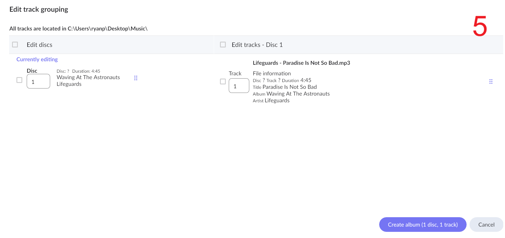

Screenshot 5: …I have to go back to Fix Track Grouping. The track number is correctly showing as 1, but I need to click “create album” a second time. This seems like a redundant step since I’m doing the same thing I just did in step 3, but if I do it a second time…

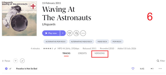

Screenshot 6: It will eventually pop up with that Versions tab with the Qobuz version. The Qobuz album also shows up pared with my library file when I look at Lifeguards’ page in Roon. Problem solved!
