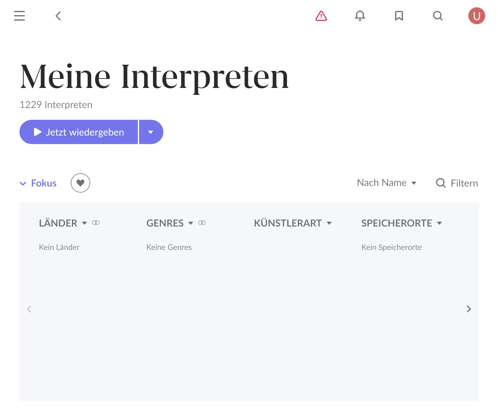

I have an issue with „focus“, that isn’t working properly:
On my roon server (MacMini, headless, Intel Core i5, iOS Catalina 10.15.7)
the “show more”-link doesn’t work after some time running roon.
If I click at the end of the “focus-list” e.g. artists (countries, genres, type of artist…) into „show more“, there are no more entries shown, but only the pulsating „roon-logo“.
Sometimes the “show more entries” appear again after a while, sometimes only after restarting roon.
On the roon app on my iPad (iPad Air, 4th generation, iOS 18.1) it’s even worse:
There nothing can be seen under focus (see screenshot) and the only thing that helps is restarting the iPad or roon server.
Are these bugs known?
What can I do to get it working properly?

After reinstalling Roon and restoring it from my backup, everything seems to be working properly on the Mac at the moment: the focus entries are always visible.
But I still have to check this over a longer period of time to see if it really stays that way or if the error occurs again.
On the iPad (iPad Air, 4th generation, iOS 18.1.1) the issue is still exactly the same as before.
BUT: On my iPhone (iPhone 13 mini, iOS 18.1.1) everything works as it should and all the focus entries are always there.
The problem also seems to be with my iPad - unfortunately it is exactly this device that I always use to control roon on my MacMini (headless!) …

Yes, on my iPad I‘ve installed „Luna Display“ as an additional display to get access to my headless Mac Mini.

That’s an Interesting question, because I always use my iPad in portrait mode. I just tried it in landscape mode - but unfortunately: the same problem. However, I have now noticed that the „focus information“ appears again on its own after a while (about 10 minutes). Even after restarting Roon on the iPad. I can live with that now, it really isn’t that bad. Maybe it’s really just a problem with “luna display”.

We have a ticket in to address the Focus issue - we’ll mark the thread accordingly and comment when development has released a fix for testing.
