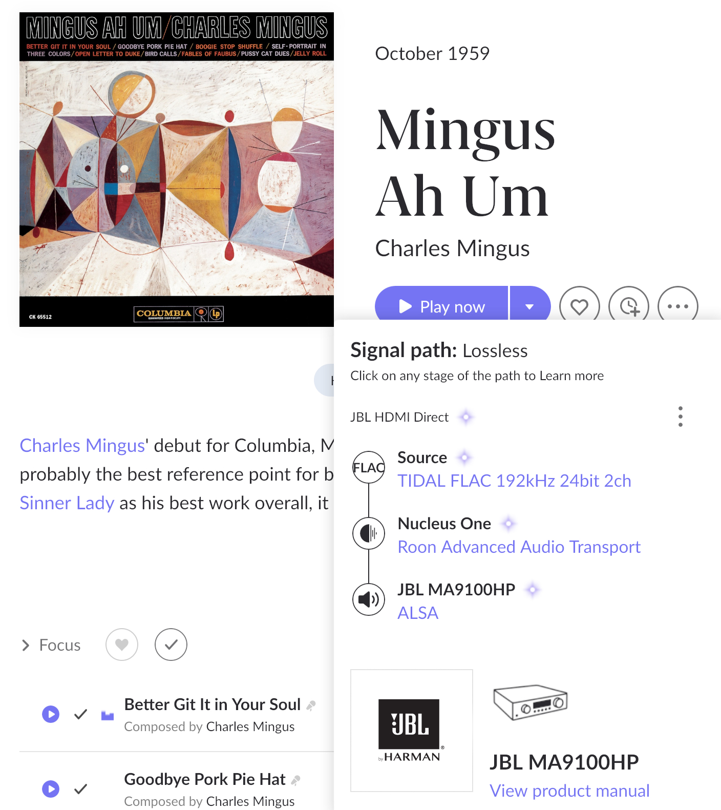

I am having issues using the HDMI zone on the Roon Nucleus. I have it plugged into a Roon Ready JBL MA9100HP AVR and it is visible as an audio zone. I can send music to it however there are several issue:
1. It does not automatically turn on the AVR like other HDMI inputs an I have to manually select the input when I do turn on the AVR.
2. When I do start playing music the AVR switches off of the Roon HDMI input to the TV eARC HDMI stopping the music and I have to switch back. Enabling the Roon display after the fact does the same thing.
3. The album art, etc. does not show up on the JBL AVR display like it does with the networked zone selected.
4. After I play the HDMI zone I cannot switch back to the networked Roon audio zone without rebooting the Roon Nucleus. It says it refuses to switch zones.

  1. This is slightly unfortunate since the networked zone does. Maybe turn the HDMI off until it is called upon?
  2. If you have the display to automatically come on in the HDMI zone or turn it on manually it causes the TV and the AVR to say hello and switch to the eARC HDMI connection silencing the HDMI until you switch back. If you can send the Roon TV display out of the HDMI in lieu of the network when the HDMI is in use maybe that could fix the issue?
  3. Thank you, I look forward to it.
  4. This happened today. Played some music on the HDMI zone. Tried to switch to the networked Zone and it says it refuses to switch u til I rebooted the Nucleus.
