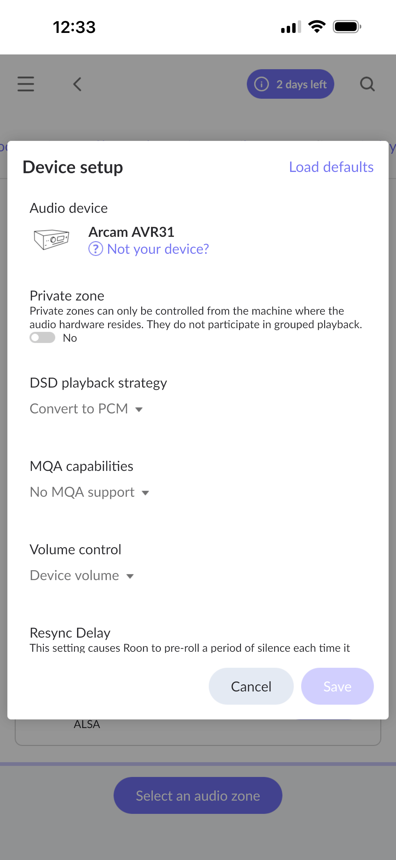

Could you snap a screenshot of your Roon Settings>Audio when you’re in the above setting?

Hello @rdskene,
Thanks for sharing the photos, but the screenshot from the device settings seems to lack details.
Can you please open “Advanced settings” there and show us what it displays for the “Channel Layout” menu item and “Multichannel mixing”?
I also looked at your older post with the same problem and can see that last time a reinstall of the database helped you - “The reinstall of the Roon Database and Settings seems to have accomplished this”.
Maybe you could give it a try once again since it’s proven to work for you?
